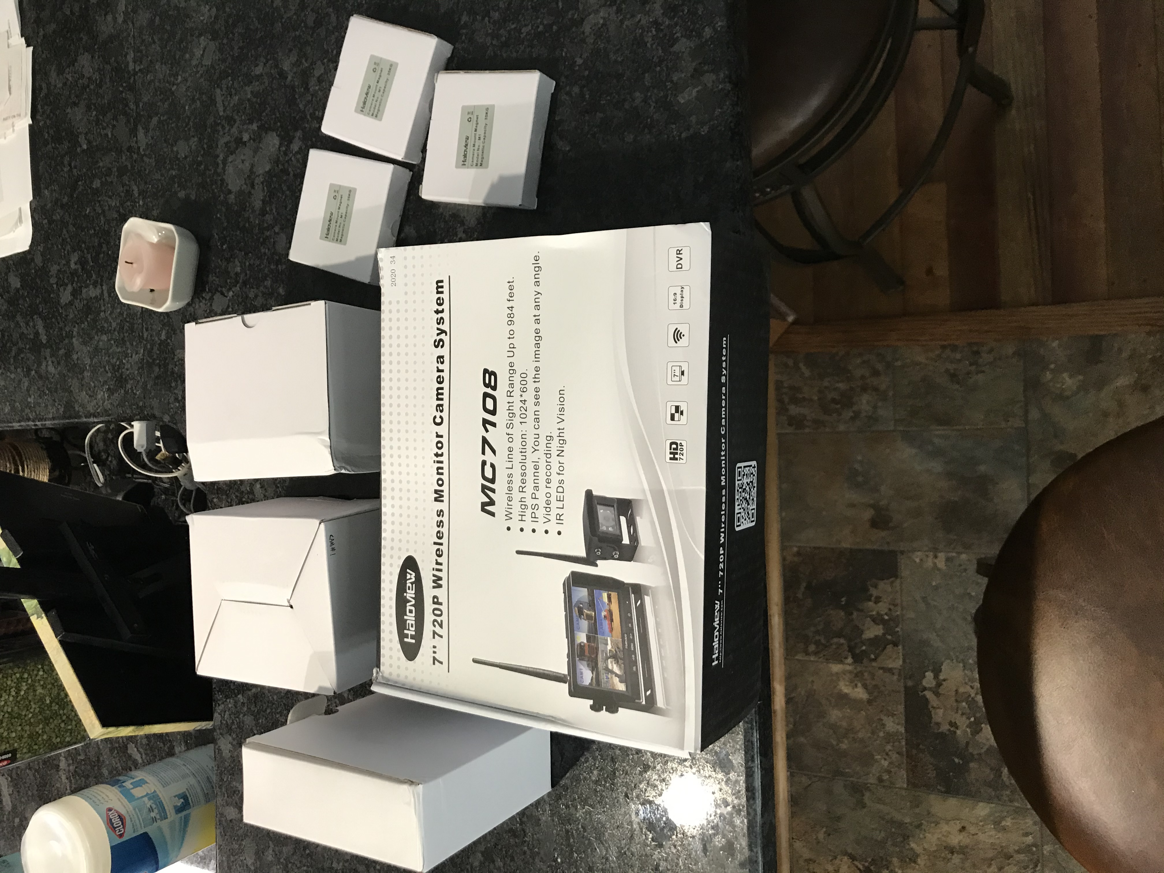

Well, look what the tooth fairy dropped off today. Haloview 7108, 3 cameras, power supply for a remote camera and 3 mag bases. I'll have to fab a bracket to mount the monitor. I know exactly where it is going. Bad thing is I have to go to Phoenix area for a job, probably a month to month and a half. It sucks but I guess that's what has to be done to buy accessories. Sorry for the sideways view. IMG_0843.JPG

So I got the one touch on my loader today and started on the cameras. Easy setup. I just did one for now. Got the monitor mounted on my right vertical post just above the SCV controls. Looks like I will be able to mag mount the two rearward cameras inside the cab in the corners. I have to work on the field of view but I'm sure it will work. Still don't know about the loader mounted camera and battery pack but I'll figure that out tomorrow. I need to get a 5 position rotary switch that fits the switch blanks for the triggering. This is a really nice setup. Seems well made and the cameras are solid. Picture is very clear. Night vision is clear as well. I will post up some pics when I get everything installed tomorrow but so far I like it.

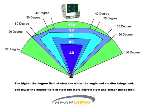

Also, I notice the halo view has 66 and 120 field of view options for the same camera. Has anyone gotten the 66 version? I would assume that is what you would want for say forks in the front and backing up to hook up an implement in back. Just trying to verify that field of view is what I want and will work.
Other than that, I think I am sold on the halo view.
/ Cameras #12
Here is a graphic for Field Of View:

I never noticed the 66 degree view. Mine are all 120. You tend to get a little fish eye in the outer edges of the range of view but it's not that bad. I wouldn't mind seeing a 66 but I would be afraid that wouldn't be wide enough.

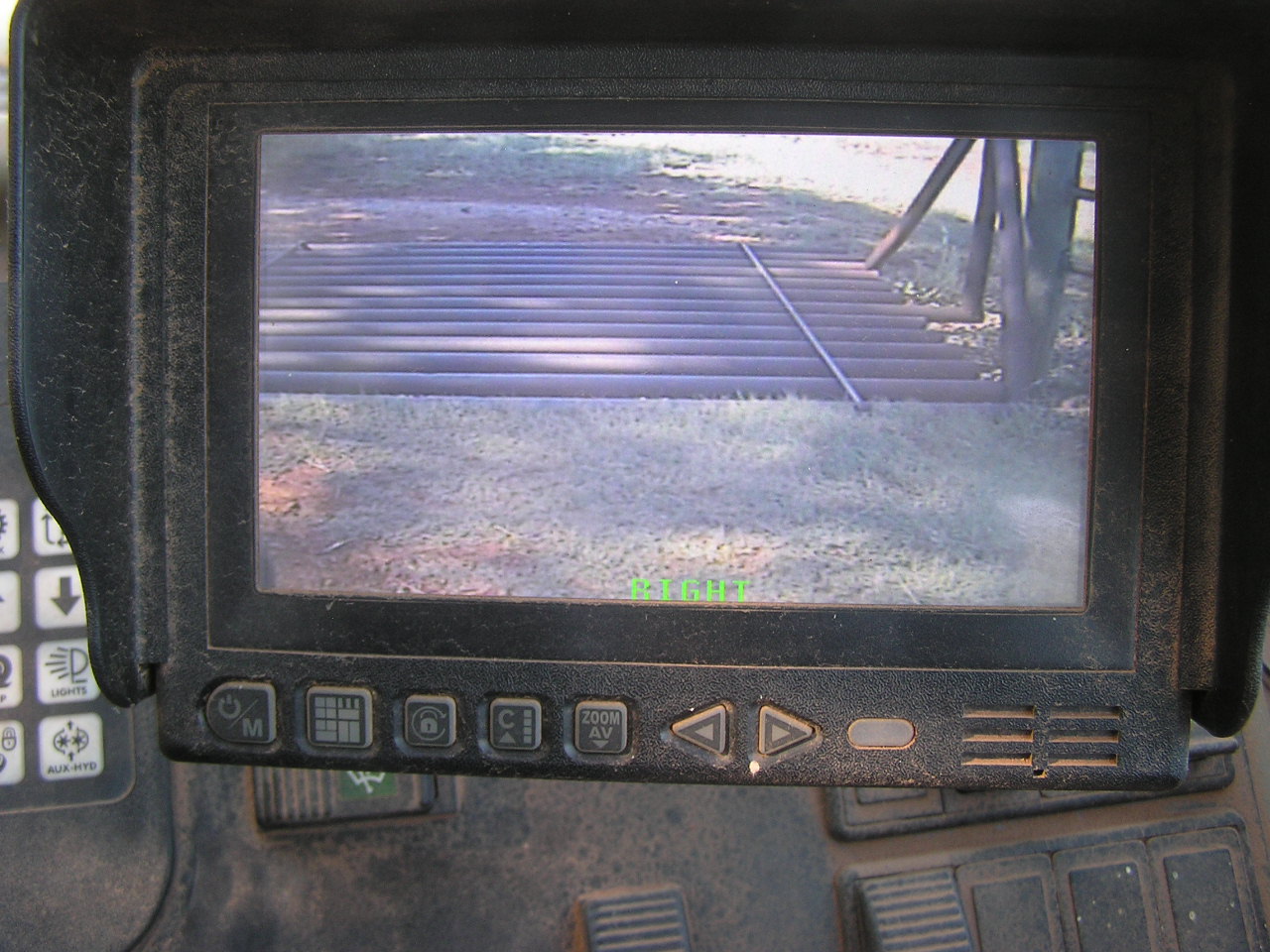

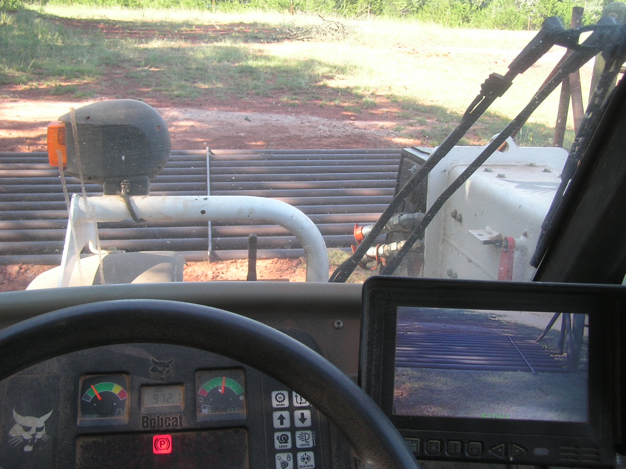

My front camera is a 50 degree view mounted over the right front wheel:
The view of the cattle guard on the monitor:
And out the windshield:
