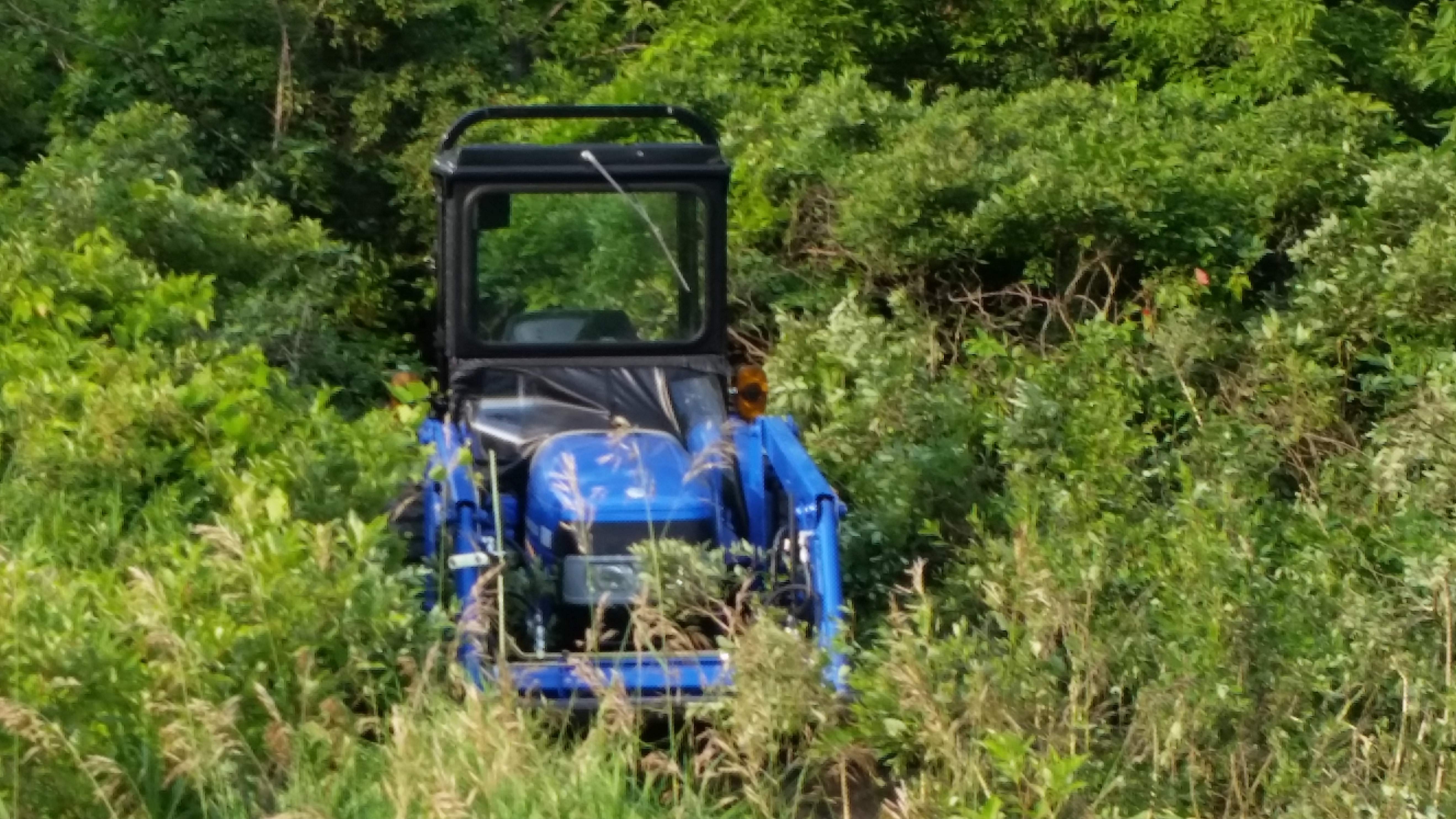

Hey all, I've got a 2014 NH workmaster 40 and a lot of thick brush to clear. As you can see in the picture, this is the tractor parked in the middle of what I'd like to clear. Most of it is less than 1.5" thick, but it is dense. Will this tractor be strong enough to pull a rotary cutter big enough to clear it?
Regardless, I've been looking at cutters and the Rhino 172 and Woods BB72x are both available nearby, as is the NH model. All three are similarly priced and slip clutch driven, with similar specs. Does one have a better track record? The WM40 has a 3ph lift capacity of 1300 lbs, and is 38 hp, 31hp at the pto. Would the loader be enough ballast, or would I need additional weight up front? Any other questions I should be asking?

I think it'll cut it. May have to take it slow. Just make sure the rear of the cutter's rear deck is higher than the front so it doesn't tend to bog the cutter down so much.

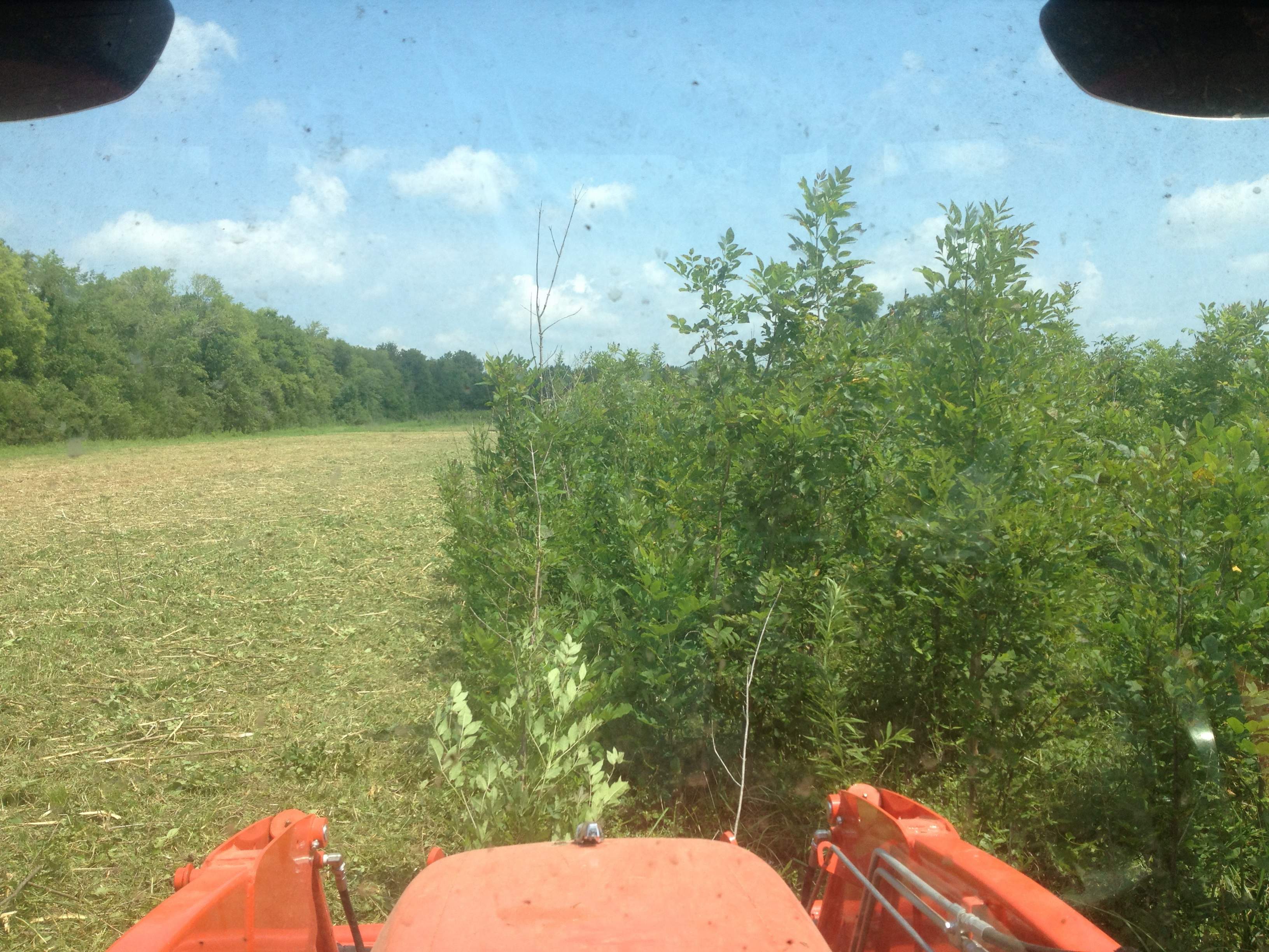

I started with this.
And this is the first part done.
Go slow with the bucket low. Did this with an LS XR3037 and a Fred Cain 5 footer.

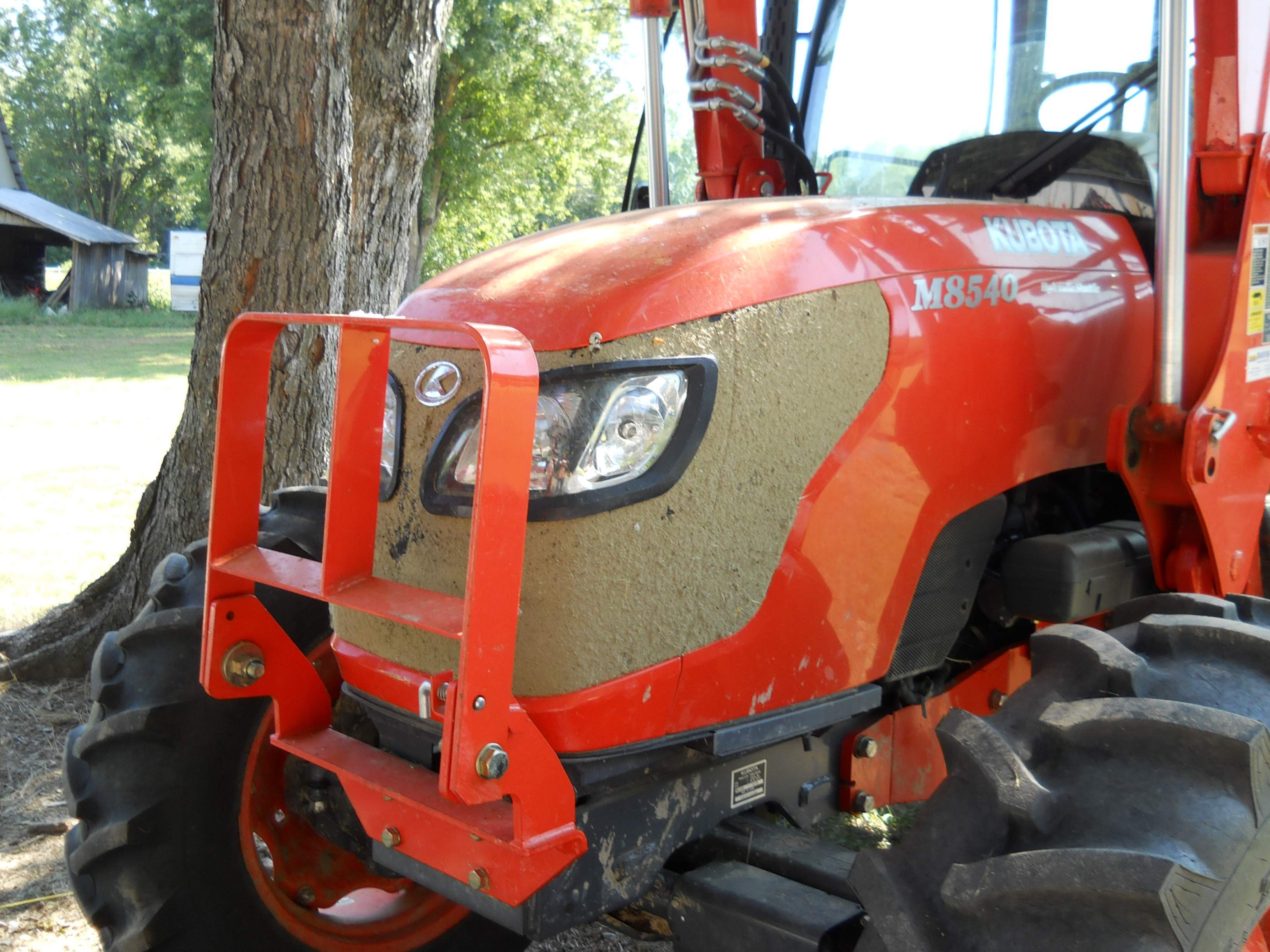

I had a lot of thick brush to cut. I have a LP RCR2672 and a Kubota 5740. Following the last cutting, I had a fan-belt problem. Dealer said it may have been that large stick got caught up in the fan belt.
His advice: Sometimes it's better to cut in reverse.
This is a photo I took during the cutting.
/ Can i brush hog it? #13
My brother fabricated this for my 5740, but even with that, there were times I backed in for some cuts.
