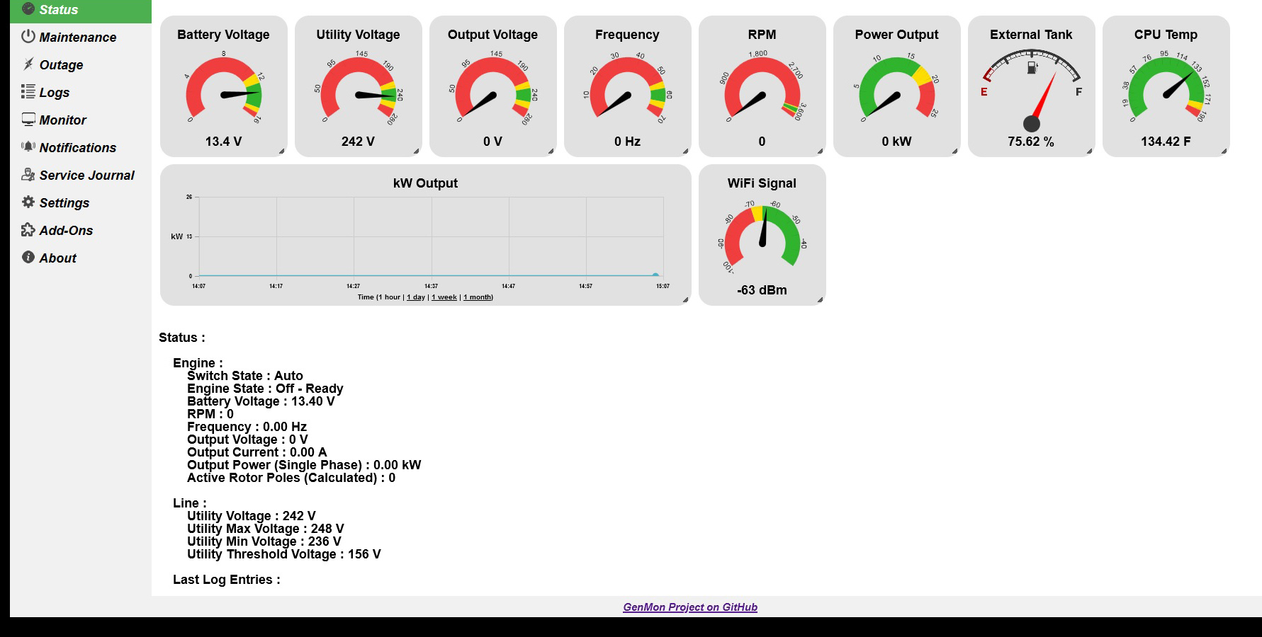

Meters and information are nice even if not necessary.
