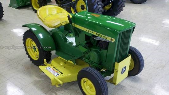

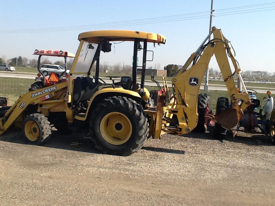

Im enjoying the 租iscussion on TLB vs traditional tractors. Not sure why people think they are any different.
Not what I'll call a traditional tractor but when it comes to John Deere there is a differences between a JD 110 and a JD 110TLB.
The JD 110 is a lawn tractor and a JD 110 TLB is more of an industrial tractor.

Great pics of both machines!!!! When searching for a backhoe I looked at several JD110TLBs on CL. Man,,,, those things bring good money!!!!! Obviously highly respected and useful!!!!
There's a member on here that has a "collection" of older JD lawn/garden equipment It's a pleasure to see those old tractors!!!!
   / Can my tractor haul a large rotary cutter? #23
JD has a bad habit of using the same number for many different tractors.
