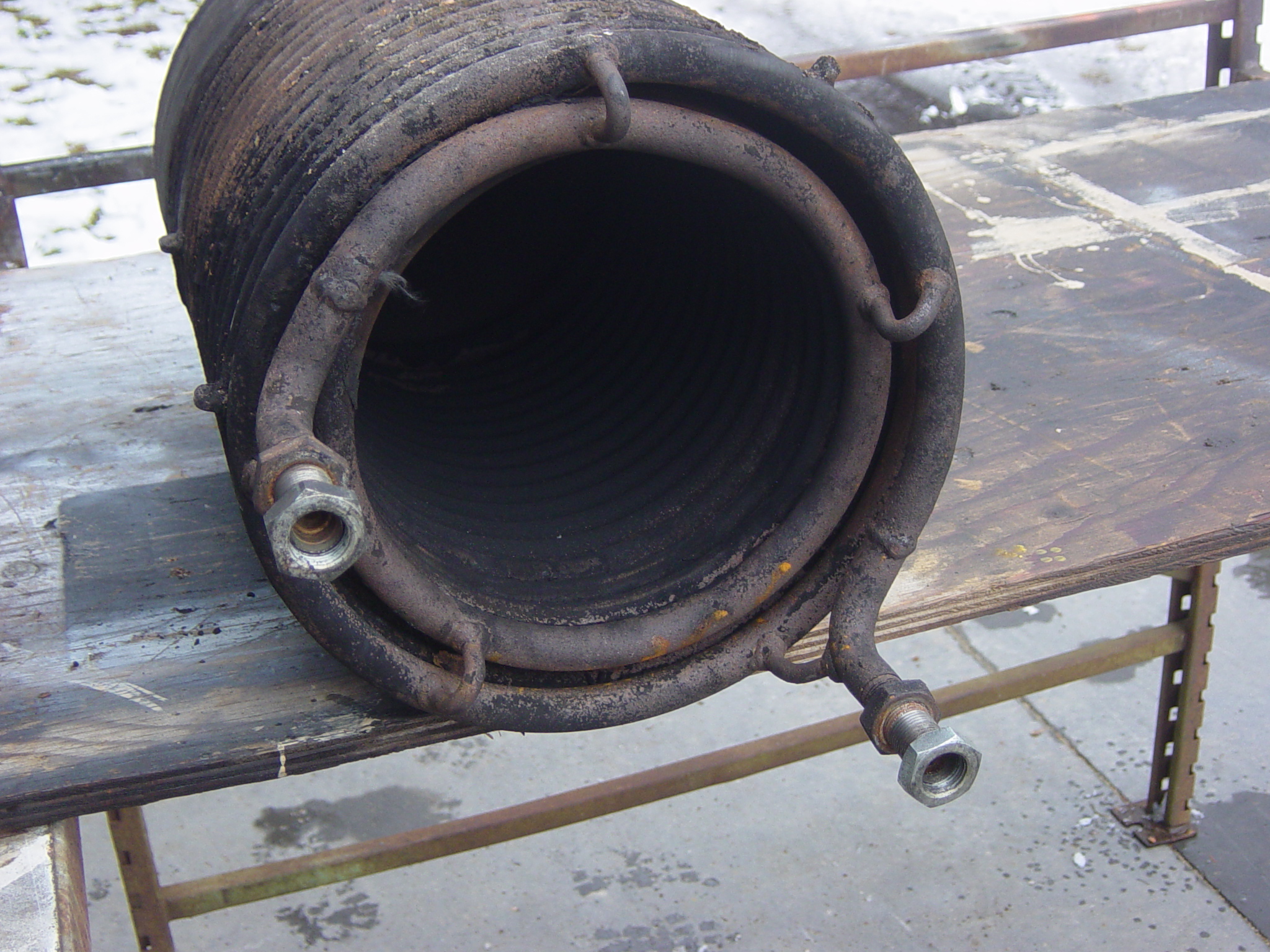

After watching the welder struggle to weld a leak on my wood fired boiler, I am skeptical about the chance of success on this. But in any case, after welding it up figure out a way to pressure test it for leaks. I am thinking of 100 PSI of air and submerging the entire unit. Even a small pinhole would be the opening for failure again.

What an owner does to his own stuff is far different to what a welding shop would do. A reputable welding shop would not touch it. They do not want a call back on an iffy job like this one. 30 years old? Even at 15 years it has outlived its economic life. I seriously doubt the it withstands 2000 PSI steam. You are talking superheated steam, you would not see the steam coming out of the leak. I would be surprised that tubing is schd 80, looks more like a lot thinner tubing. Sched 80 will not withstand 2000 PSI.
Welding; I doubt you can get it clean enough to TIG it. I would opt for an O/A welder with a #0 or #1 tip. Thin tube then go down to a #00 if I was going to try it.
What was it used for? Hot water/steam cleaner? Time to buy a new one, or get the replacement coil, and hope for the best on the other components. What would a whole new system cost compared to fixing?

Still comes down to the integrity of the pipe. If it can be cleaned and is in good shape and only cracked due to frost, Weld it.. If it's corroded, Throw it in the scrap pile.

Spoke with the manufacturer of the coils. Very friendly and helpful. They weld (and repair old coils) with 6011 rod. Says it's mostly an issue of location of the damage and access. Sounds promising. Going out to cut the can off the coil and take a look.

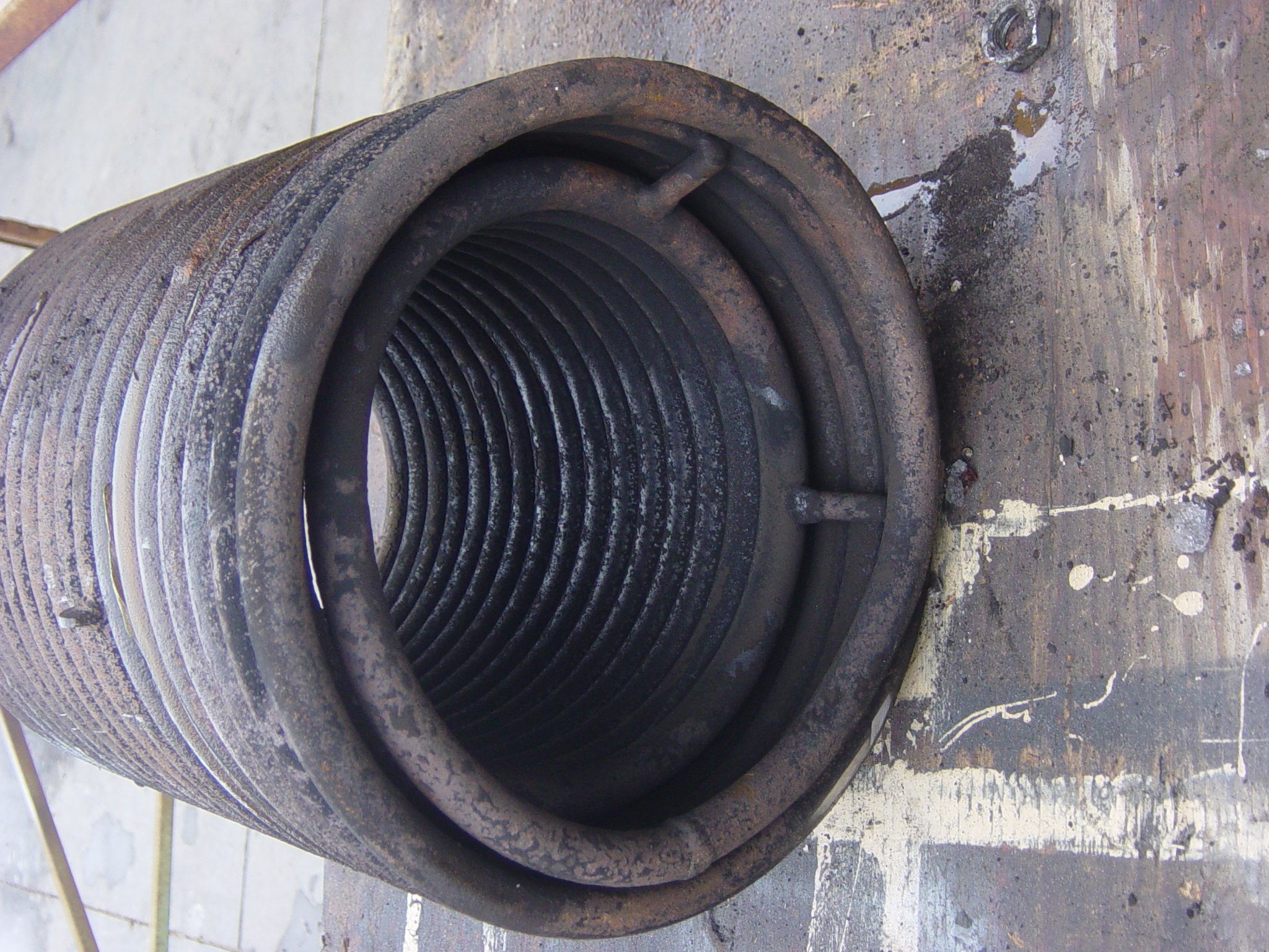

You realize once you start welding on it, it will become a never ending process.... $700 is pretty cheap compared to the hours of frustration spent tracking down every little defect in a 30 year old part... Also at steam pressures.... I'm pretty sure $700 is a cheap life insurance policy.... Yes I'm sure you can do it, but I am also sure you shouldn't...

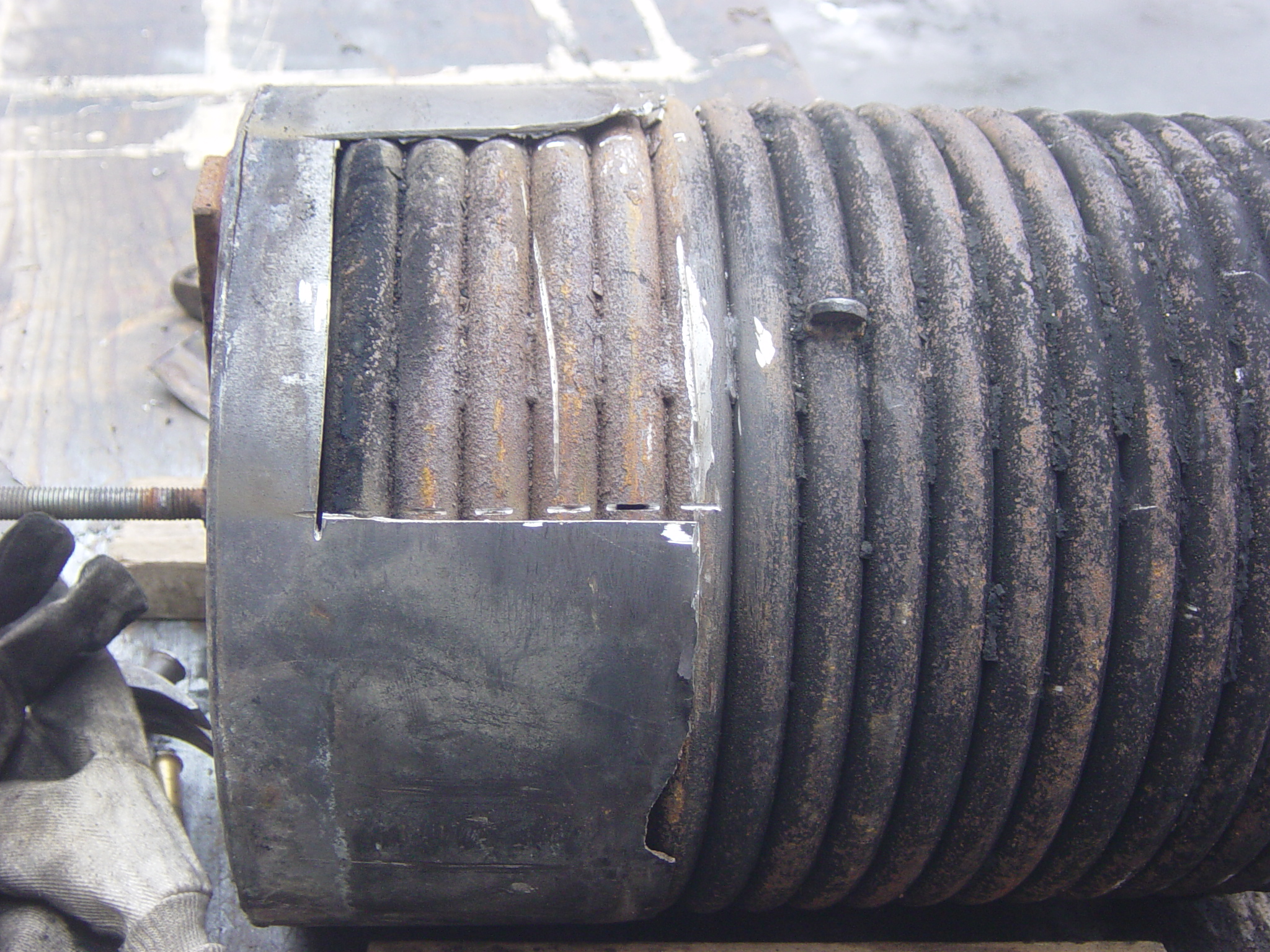

I think I prettty much destroyed the thing and never found the internal hole. That can on the end was so brittle, I thought it was cast at first.

Maybe I shouldn't have gone nuts with the zip disk. But it seemed like I would not get that can off there without destroying it. At first I was sure the coils ended where the can began, but they go right to the end. It got to a point, where I just wanted to get it open to find the big hole!
