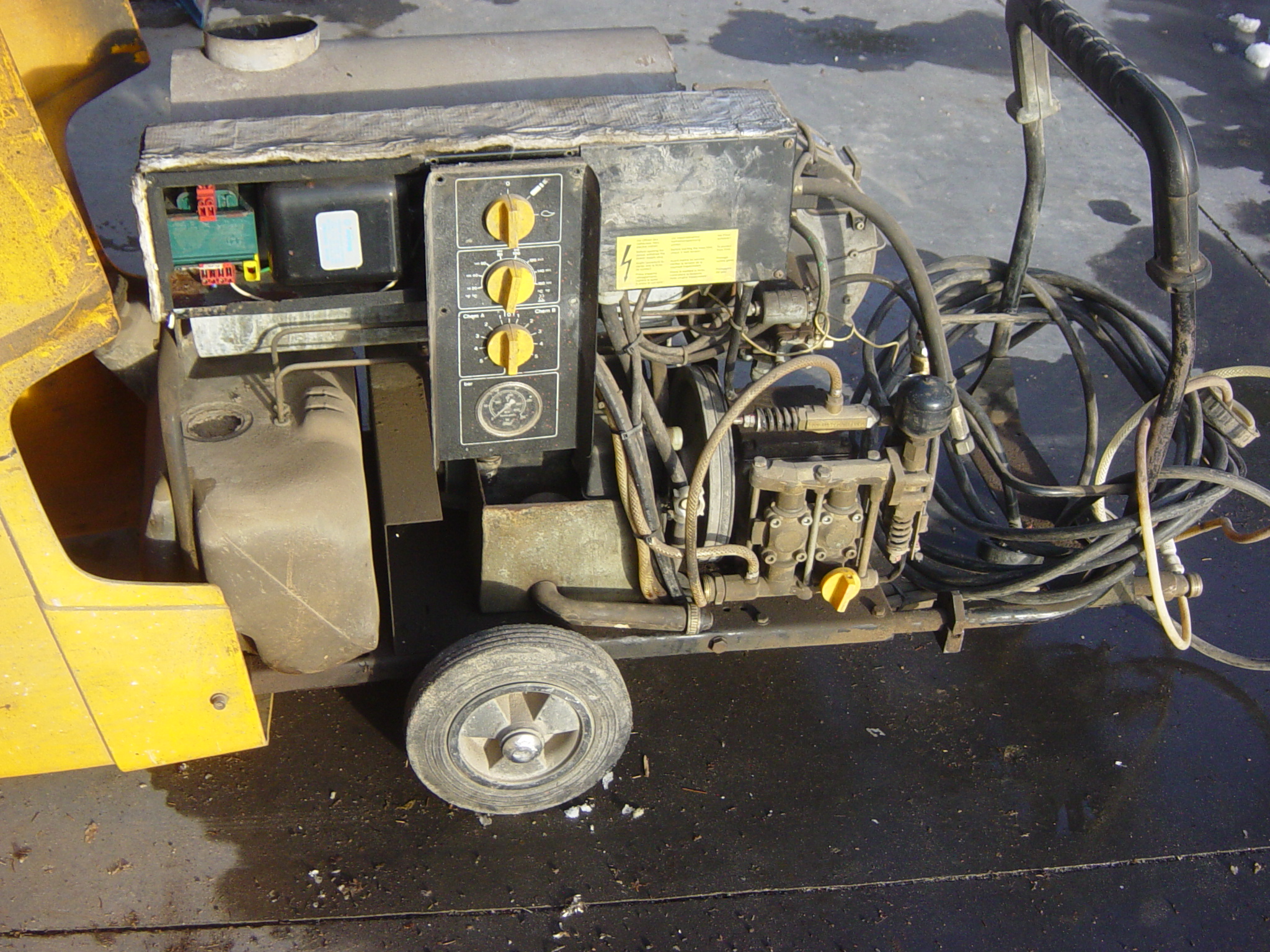

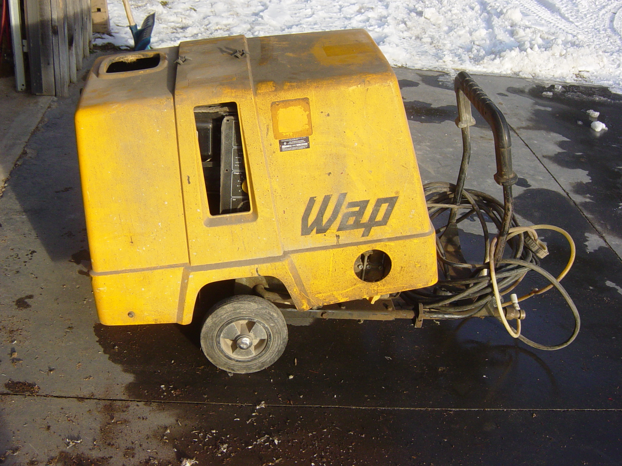

Some pics of the machine for context.
DSC00113.JPG 5HP, 240 Volt 1PH motor.
I don't have a lot of things on my "WANT" list, but this was one, so I just may go ahead with this.
View attachment 629599 Anybody have any ideas what the lower yellow knob is for. It was suggested an unloader but playing with the thing and turning it this way or that had no effect.
View attachment 629600 5HP, 240 Volt 1PH motor.

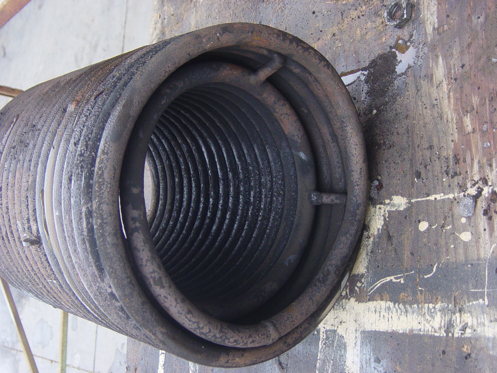

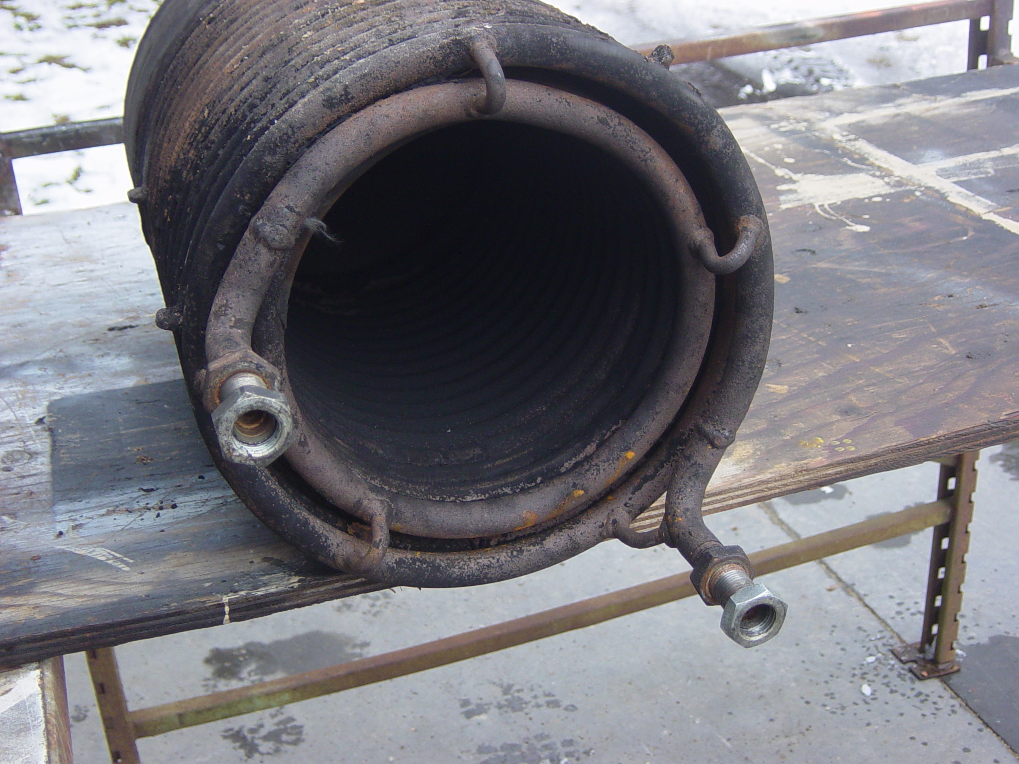

Maybe I shouldn't have gone nuts with the zip disk. But it seemed like I would not get that can off there without destroying it. At first I was sure the coils ended where the can began, but they go right to the end. It got to a point, where I just wanted to get it open to find the big hole!
If you are inclined to fix it you will need to get the inner coil pot of the way for inspection. Do that and pressurize the coils and put in a water bath. Ala there is the leak. From seeing where the cur off disc nicked the coil it looks like schd 40 pipe and it is in excellent condition on the interior. Your leak is undoubtedly from freezing. I doubt it has seen much use seeing the coil interior.
If I had gone as far as you have I would go the rst of the way and try to fix it.

Can you weld it? Probably. Will it hold? That's questionable. Steam and pressure may have taken their toll over the years. You also have the potential for additional freeze damage. You may have sufficient safety guards in place but there is the time factor on how many times you want to tear this thing apart to fix it.

Agree with all that. I haven't found anything steel and weldable yet that I couldn't do a decent job on with an oxy-acetylene torch and a fine tip. With the flame I can taper the welded area and anneal around the edges in a way that TIG can't do. Having the right torch tip is critical. Here is one that I use a lot. It's basically a piece of thick wall copper tubing silver brazed into a welding tip. That gives me a nice size flame for material from less than 1/16" up to 1/8" thick and puts the flame right out where I can see it well.
Still, if I absolutely had to patch it, I'd probably weld it up and then spend some time making a patch that fit very exactly so that I could add a patch silver-brazed right on top of the welded area. Even if it all went right, that's a lot of unknown and delicate work for $700.
Bottom line is that for $700 after 30 years service I'd just buy a new one, if available.
