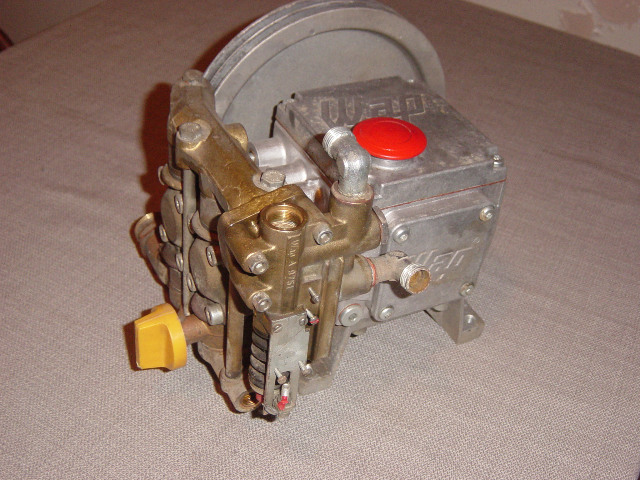

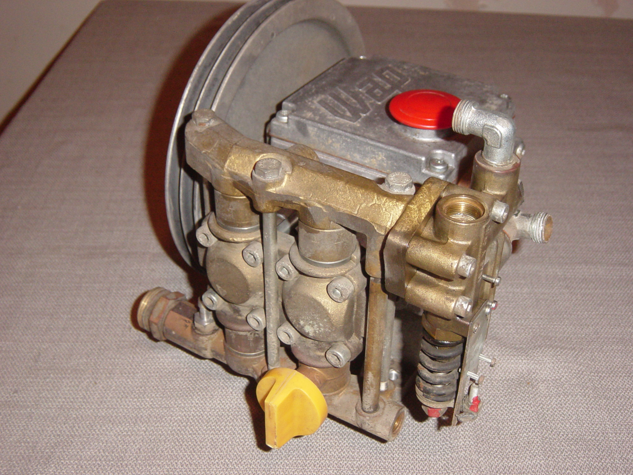

Sized up my room. Should be able to make room for it.
Removed and cleaned pump. Sitting on kitchen table (safe from Frost) as I try and figure out what does what. Removed a plug from the bottom and a spring was stuck in there and got twisted around. Some rust in there that will need to be cleaned out.
Pump looks small in pictures but I wouldn't want to carry it too far.
   / Can one weld a Steel Hot Pressure Washer Coil? #44
That pump looks like a fine piece of machinery.
The pump on my cheap POS is obviously from China, the others each have a... "General Pump".
Both are direct drive.

O.K. So now I am TOTALLY confused.
So, someone had removed the coil from the circuit and had a quck coupling mounted on the pump, for cold water use only.
BUT, there is a Temperature sensor going to the thermometer, mounted on the PUMP, suggesting that it reads HOT water temperature there. And yet I believe the pump goes into the coil and then out to the hose and wand. There are no extra ports where the hot water is looped back through a part of the pump assembly.
As far as the rust goes. I have a feeling this thing is that old, that it may have failed and sat in a corner for the last twenty years, until someone decided to get rid of it. That would explain the rust I see.
There is virtualy NOTHING about this machine (or the Old company) to be found on the Internet.
   / Can one weld a Steel Hot Pressure Washer Coil? #48
The ones that we have at work (the one that works and the ones that have failed) have the coil on the output side of the pump so the pump only sees cold water.
Any chance that what you are seeing is the pressure sensor (autoshutoff when you hit X PSI)?
Aaron Z
#49
There is a cold water input, that goes to the reservoir with a float valve, so that is not in despute. Goes to low pressure manifold of pump.
There is a microswitch on the output(?) of the pump that is used for trigger control of pump and heater. There is an accumulator there that facilitates that trigger operation, since you can't compress a liquid. There is also a safety valve there, that bleeds off water and pressure to a hose going to the ground. No doubt that the pump is before the coil. Maybe, someone moved that thermometer probe. Maybe it used to be on the output of the coil.
