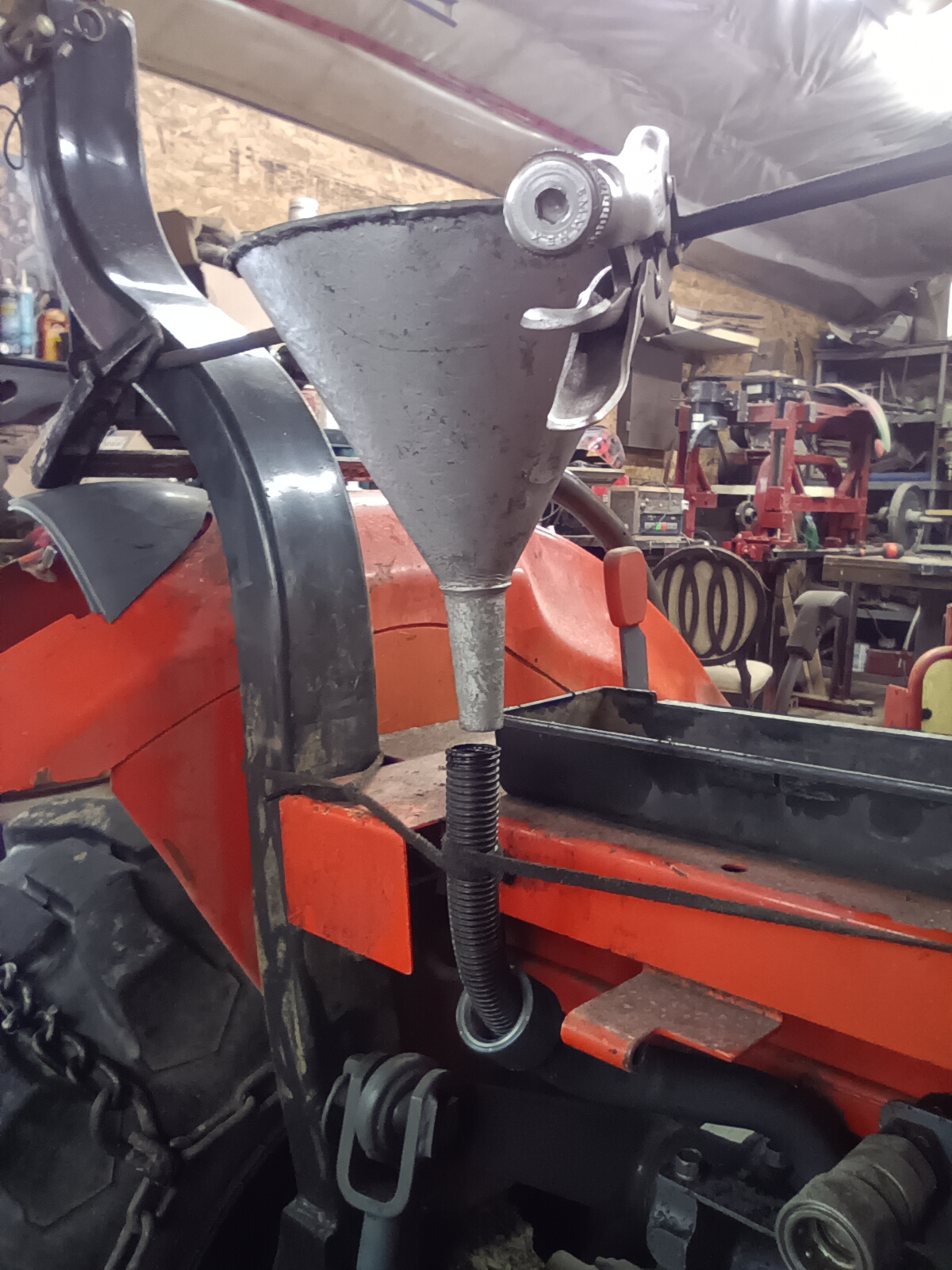

Looks like there might be a leak in this hose.I'll replace and get new clamps before I start the tractor . I'm now draining all fluid and will put it back in slow.
   / Can the hydraulic system get air locked after a fluid change
#36
Going as slow as possible

We have discussed a suction air leak as being the most probable culprit several times in different posts since a week ago. We even discussed how it can happen as rubber connecting tubing ages. The tubing cannot be reclamped, it has to be replaced.
Post #34 points to the exact spot. So are we back to a suction air leak again?
