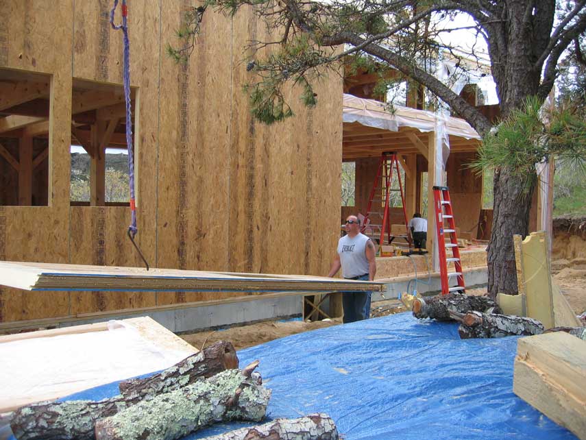

More wall panels to go and finish up. The site forklift was used to move them into place.

A better view of the operation. The guy on the top is going to fasten it up on the top plate, with another on the bottom to hold it and nail it to the sill and rim board.
   / Cape Cod Barn
#136
Setting the panel on the sill. The bottom of the panel sits right on the sill and is toe-nailed to it, and also nailed with 7" pole barn nails to the posts. Wall panels are almost all on.
