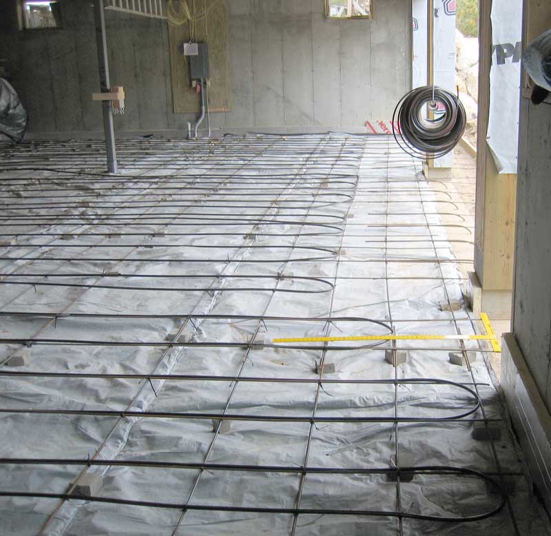

And then installed some Insultarp 1/2" insulation on top, and then #3 rebar 18" on center, to which is tied 1/2" PEX tubing for radiant floor heat. Also put in 2" of rigid insulation around the perimeter of the slab to be poured. This is a photo looking in the opposite direction from previous photo.

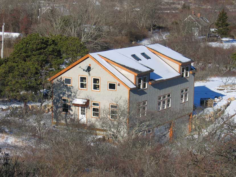

Junkman, you were just about 5 weeks early, but just got the first snow. Barn siding was completed 3 days ago, just in time. So here it is -- all finished from the outside.

Radiant floor heating.......Satellite dish on the outside, post and beam construction.......hmmmm
You're busted! That's no garage, it's definitely a Home! /forums/images/graemlins/blush.gif
I'm guessing he's putting wainscoting and Rosewood trim! /forums/images/graemlins/grin.gif
Nice job Bebster, you really know how to build a quality place. I wish I was so lucky, my Kubota still sits under the King Canopy /forums/images/graemlins/frown.gif

Nice Barn,
I'm wondering how the insultarp worked out for you? I am presently building a garage, with hydronic radiant, and I have insultarp done as well. I have heard a lot of conflicting results, but most have been positive, any comments on it?
