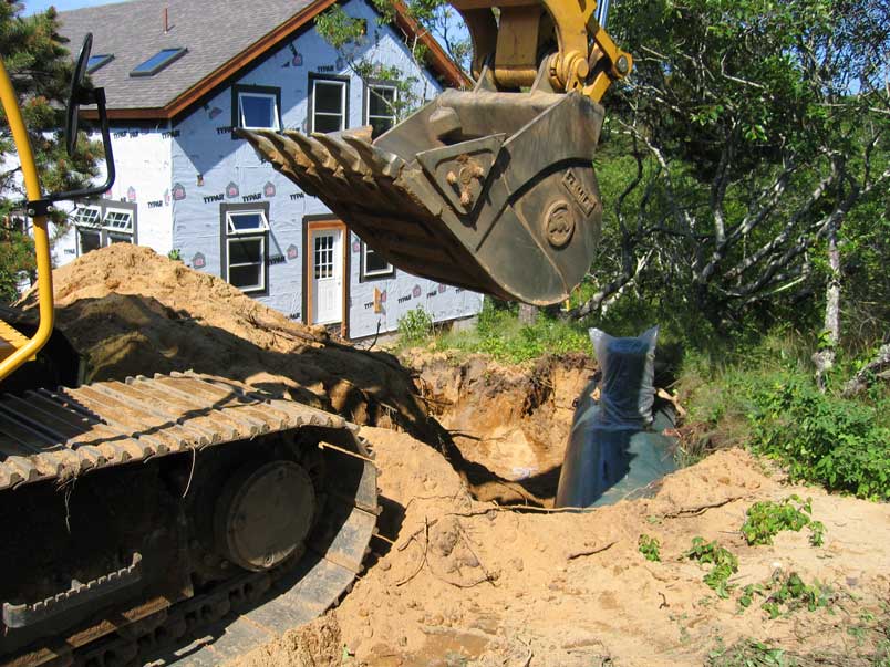

Here's a photo of the 1,000 gallon propane tank going in. The tank weighed more than my JD 4410 could lift, so I needed to rent the big machine to move it off the delivery truck. While it was there, it dug the 5x5x18 hole hole for it.
You can see the roof now has a couple of skylights in it to get some light into the loft area. You can also see the awning windows above the double hung windows. I did this so I could keep the awnings and the upper part of the double hung window open during the summer and not let rain get inside.

I was at least able to get in the act and use my backhoe to dig the 2' deep trench for the gas line from the tank to the SW corner of the barn where the regulator is. Followed Junkman's advice and filled the tank as soon as I could before propane prices began to rise any more after the summer.
