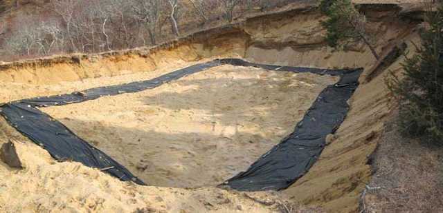

As we added stone around the perforated drainage pipe, we added landscape fabric to keep the sand from getting into the stone. Then backfilled with sand on top of the fabric. You can see the different layers in this action shot of the backfill taking place.
