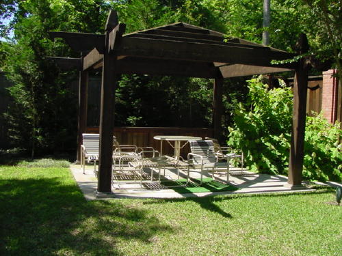

/ Cape Cod Barn #86
Don't knock it. Worked fine on this project. /forums/images/graemlins/blush.gif

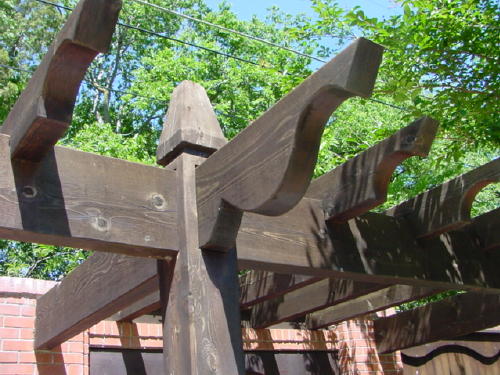

/ Cape Cod Barn #87
Here's another shot of part of the complex. I started off with rough cut cedar beams and just got after it. /forums/images/graemlins/smile.gif

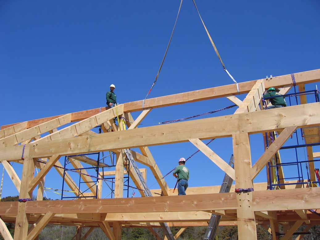

Harv, now I'm feeling really guilty. So here's another installment. This is a photo of the ridge beam being hoisted into position by the crane.
