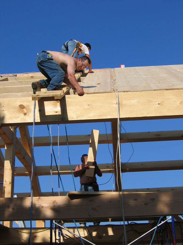

You're so right -- had to spend some time on my day job recently! But progress has been steady. Here's a photo of the ceiling being nailed on. It's 1x8 tongue and groove pine running vertically. In this photo you can see some of the electrical wires I ran on top of some of the rafters -- these are for future ceiling fans and I wanted the wires concealed so they had to go on now. The wires will run on the outside of the frame down to the main panel in the basement.

The wires run down the outside of the post in a little channel I made of 5/8" plywood strips and then into the basement through the rim board. The plywood strips also serve to space the structural panels out from the frame so that later I can slip in some 1/2" drywall for an interior finish wall if I want to.

Drilling through the ridge beam to feed the ceiling fan wire was not that easy. But the crew had fun with the task.

Finally, a little celebration topping off the ridge beam with a little branch as an homage to the tree gods. Next step: installing the structural insulation panels.
