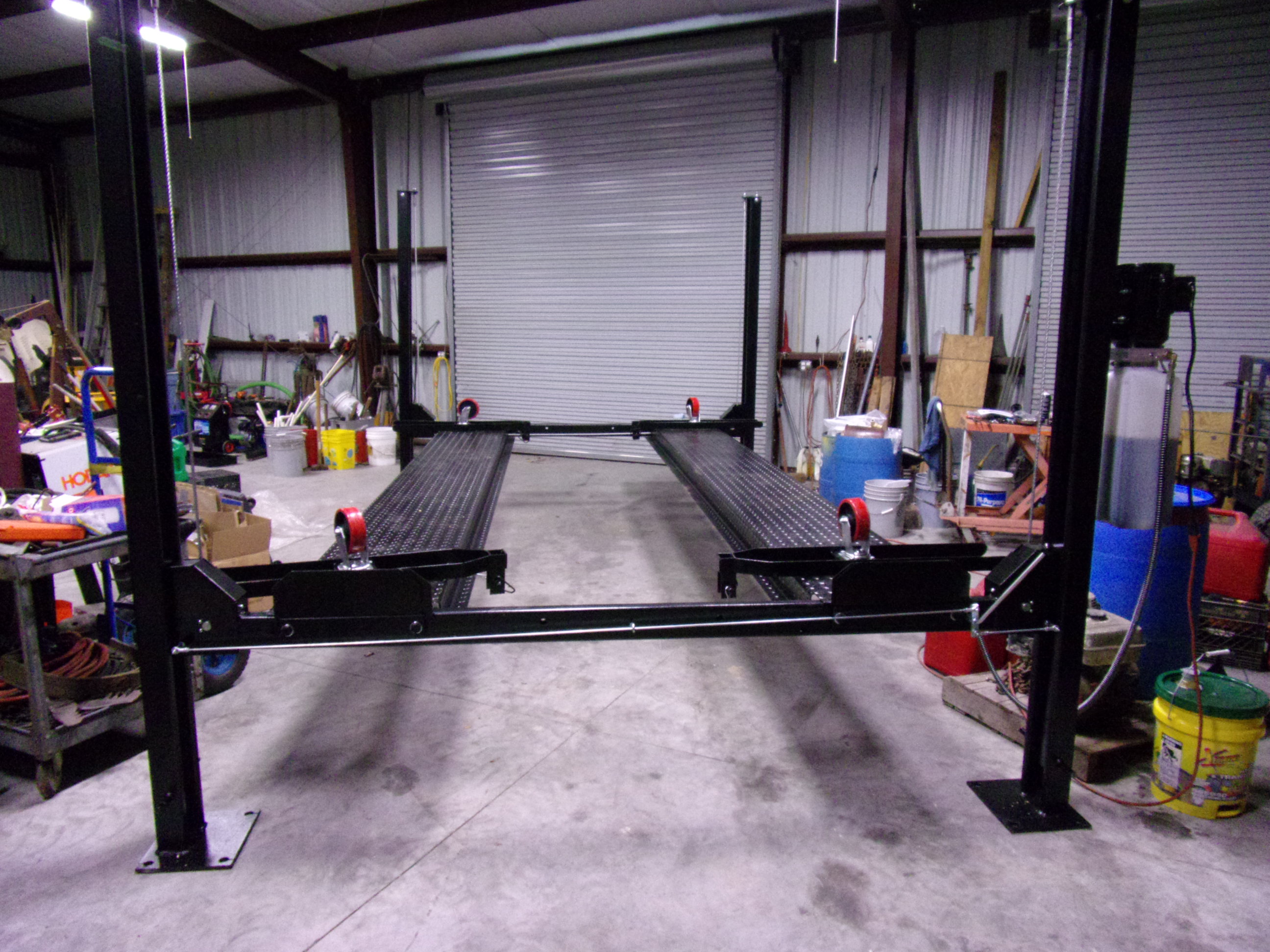

Santa brought me a 4 post lift last December!
It came with jack plate, casters and drip pans.
Picked up in Orlando was $2420.00.
I got the extended length for my extra cab PU.
It is a 8000 lb lift, model # XLT 8000, found it on ebay and dealt with seller on the phone.
I have a forklift but was easier to assemble with engine hoist.

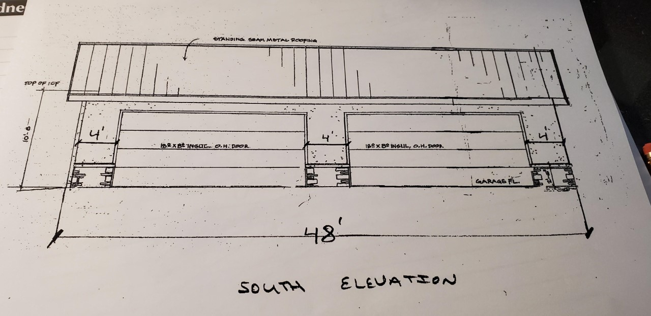

Attached is the lift I was looking at. Attached is my future garage build (48w x 28d). The overall car lift height is around 12' max. I was planning on placing the lift dead center underneath the glulam ridge beam. The ridge glulam beam is around 2' in height so that leaves me around 2' of clearance (16-2=14' 14-12=2') between the lift and the glulam beam.
With the roof slope and the other 2 glulam roof support beams, the height restriction drops to 12' but at that point it's still below the max of the lift so I don't see any issues with even a SUV or truck causing clearances issues with those lower beams. Only issue I can see is the garage door, when open, would interfere with a car on the lift. So I won't be able to open that bay door when there is a car in the air on the lift.
Any thoughts or input?

We did what you are doing same roof pitch, same width with 9" side walls. We can lift one ton 4 door pick up and it does not hit the ceiling. We also have in floor. So, it can be done. The best hoist is in floor out rigger hoist. Can get in and out of the car, not in the way when not in use. Not advisable with in floor.:) that is the best hoist IMOP if you are going to work on cars. Not practical in most cases but best hoist to work on cars with.
