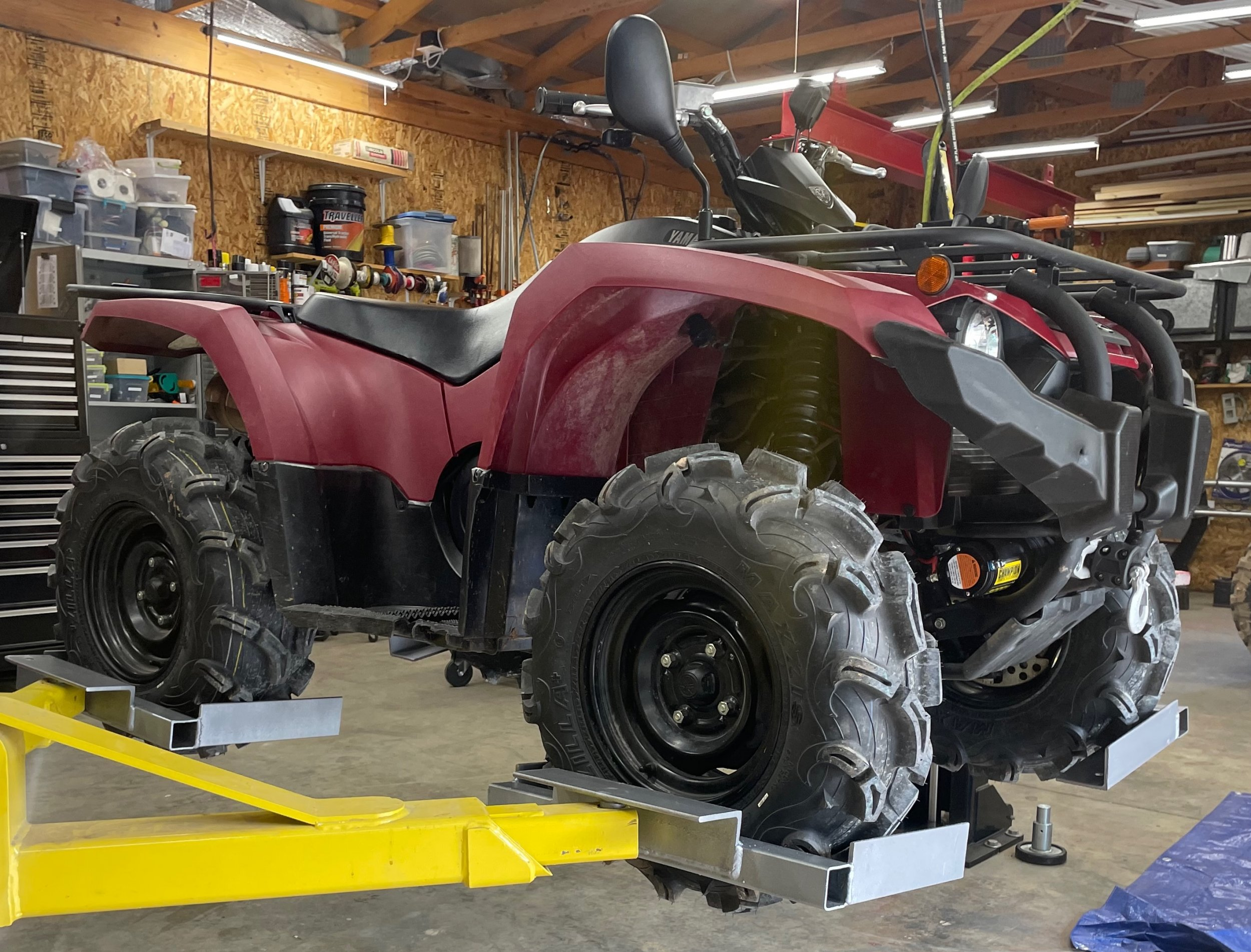

My ATV would not fit really well on my small two-post lift and it is a bit of a pain to crawl under the ATV to change the oil, so I made up a set of wheel lifts. You could do the same for a ZTR. I tested it to about 1600 lbs and it didn't flinch - made out of 3/16 x 3" x4" angle iron and had about $100 in it.

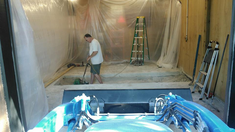

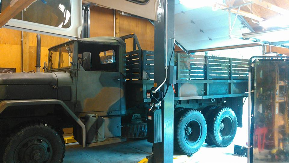

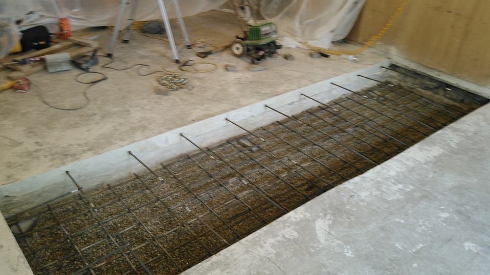

Put in a 2 post Bendpak. I didnt trust the floor thickness so cut out the concrete and dug/tilled down 14" Backfilled with peagravel and rebar. So I have a concrete chunk that is 14'x4'x12" to mount the lift to that is also keyed into the current slab.
