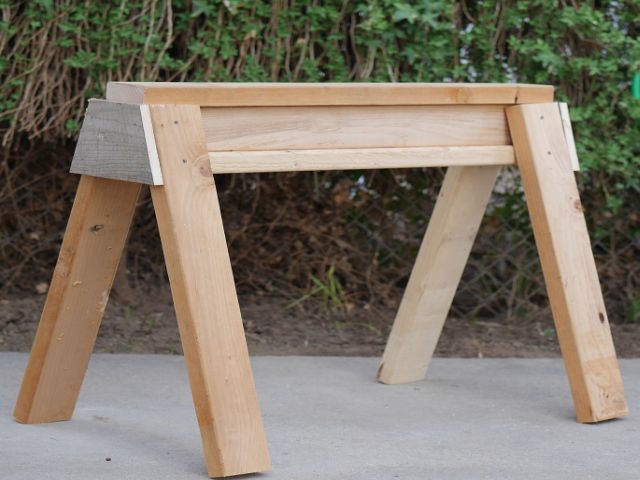

We usually made donkeys (saw horses) using three studs cut in half...two of them make 4 legs the other two pieces get nailed together like a "T" for the top...the leg angle is automatic when nailed to the "T"... scrap plywood gussets on the ends...lower cross pieces can be added for a step if the donkeys are being used to hold a walk plank etc...
Hate the plastic horses because they push over too easy...especially when you try to slide a stick of lumber across the top...
A handy saw hanger can be made by simply driving a common framing nail on one of the legs leaving about 3/8"... hang a circular saw by top edge of the guard on the head of the nail...
I’m having a bit of trouble envisioning this. The “T” faces up like normal? And the legs get nailed to the angle between the top horizontal and the vertical part underneath that?

No Inverted so the "flat" 2x is on the bottom the one on edge on top...hold the top of a leg about 3/4" down from the top and the edge of the flat one will kick the leg out at a proper angle...
In the pic below the top member is not required...IMO scrap plywood makes better gussets than solid lumber...
overall sizes are arbitrary...
