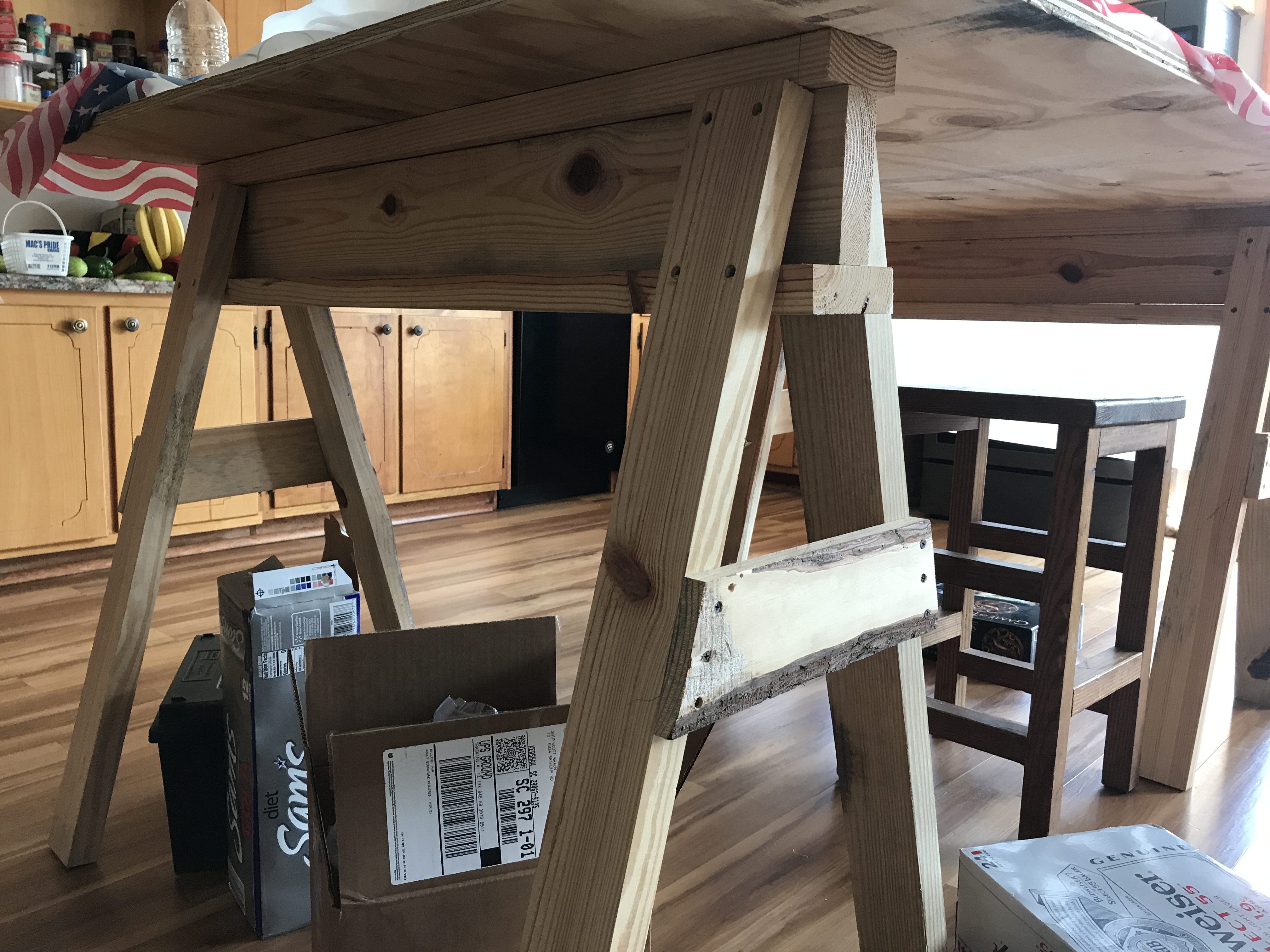

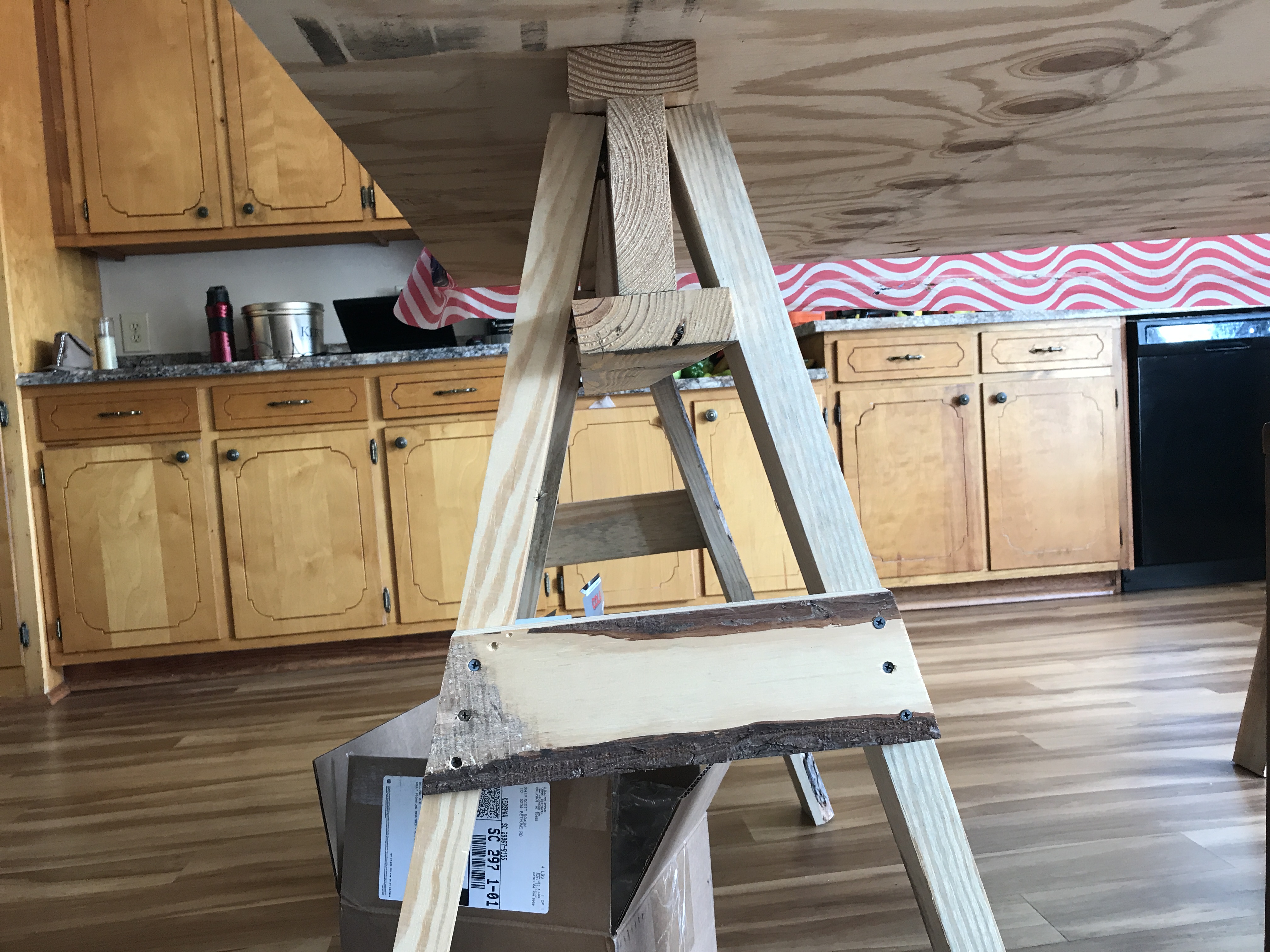

I知 having a bit of trouble envisioning this. The 典 faces up like normal? And the legs get nailed to the angle between the top horizontal and the vertical part underneath that?
Good simple tip about the nail to hold the saw. I just spent two days picking mine off the ground each tim I needed it.
I believe this is what he is talking about, you are making a little "I" beam on top. This way you can make them as long as you want, I used a 2x5 on the bottom to give the legs a little more spread. I normally cut my legs at 32-36 inches depending what I'm using them for. These are 36" and are for a temporary island in my kitchen.
