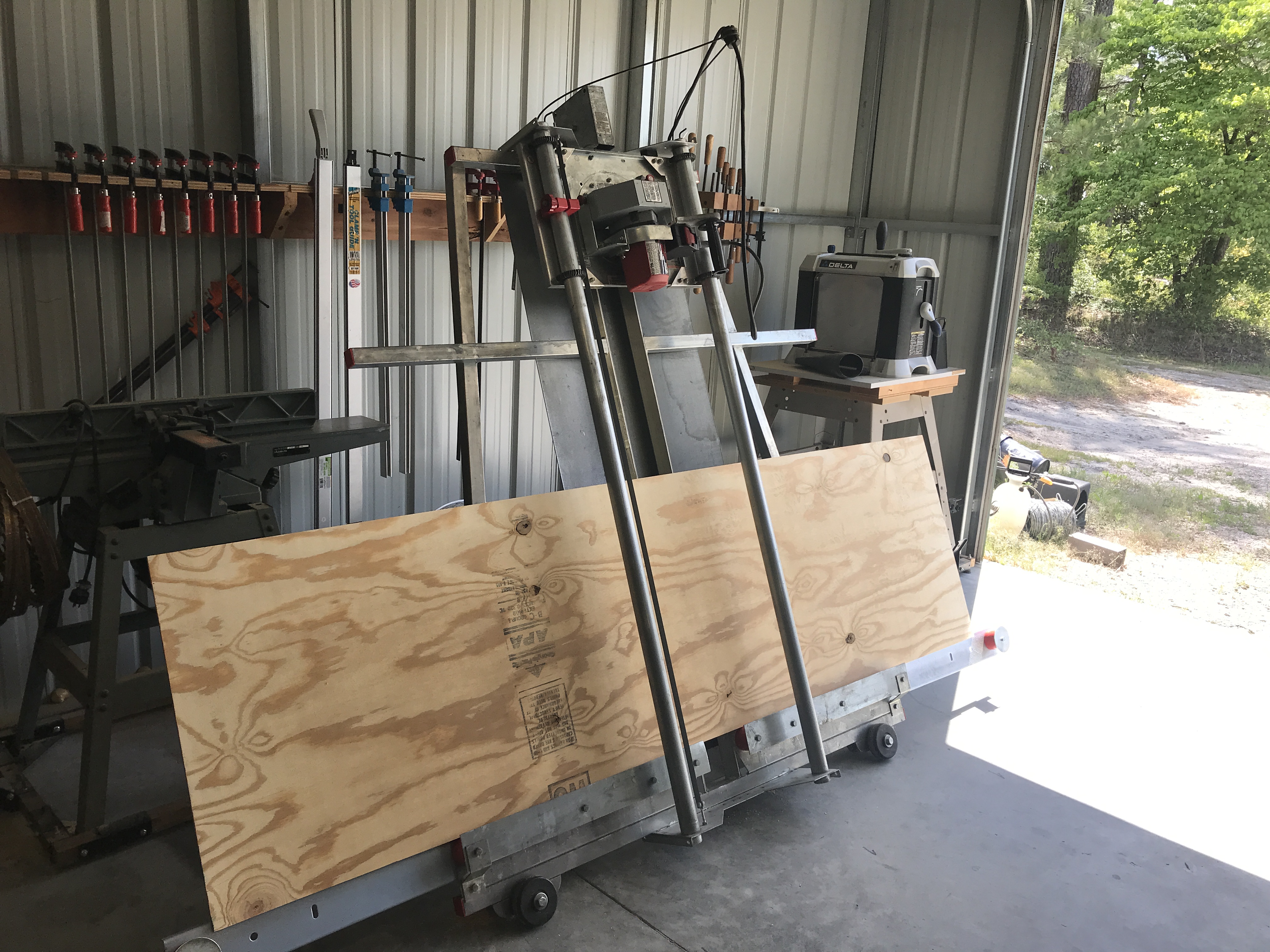

You have 8 red handled tools in that photo and I can't make out what they are. What?
Those would be some of my clamps, you never have enough clamps!!
That is my clamp wall, you'll notice clamps of different styles almost all the way to the corner.

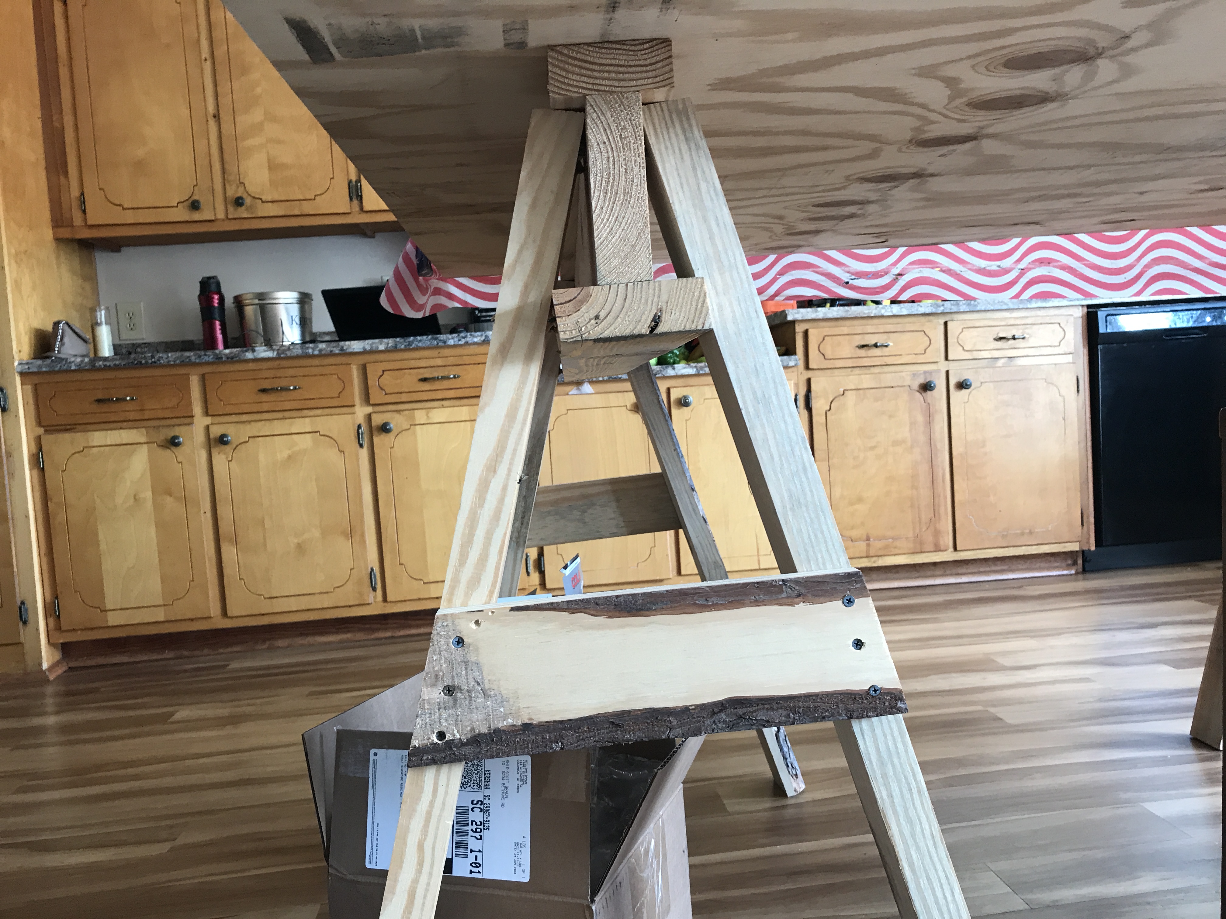

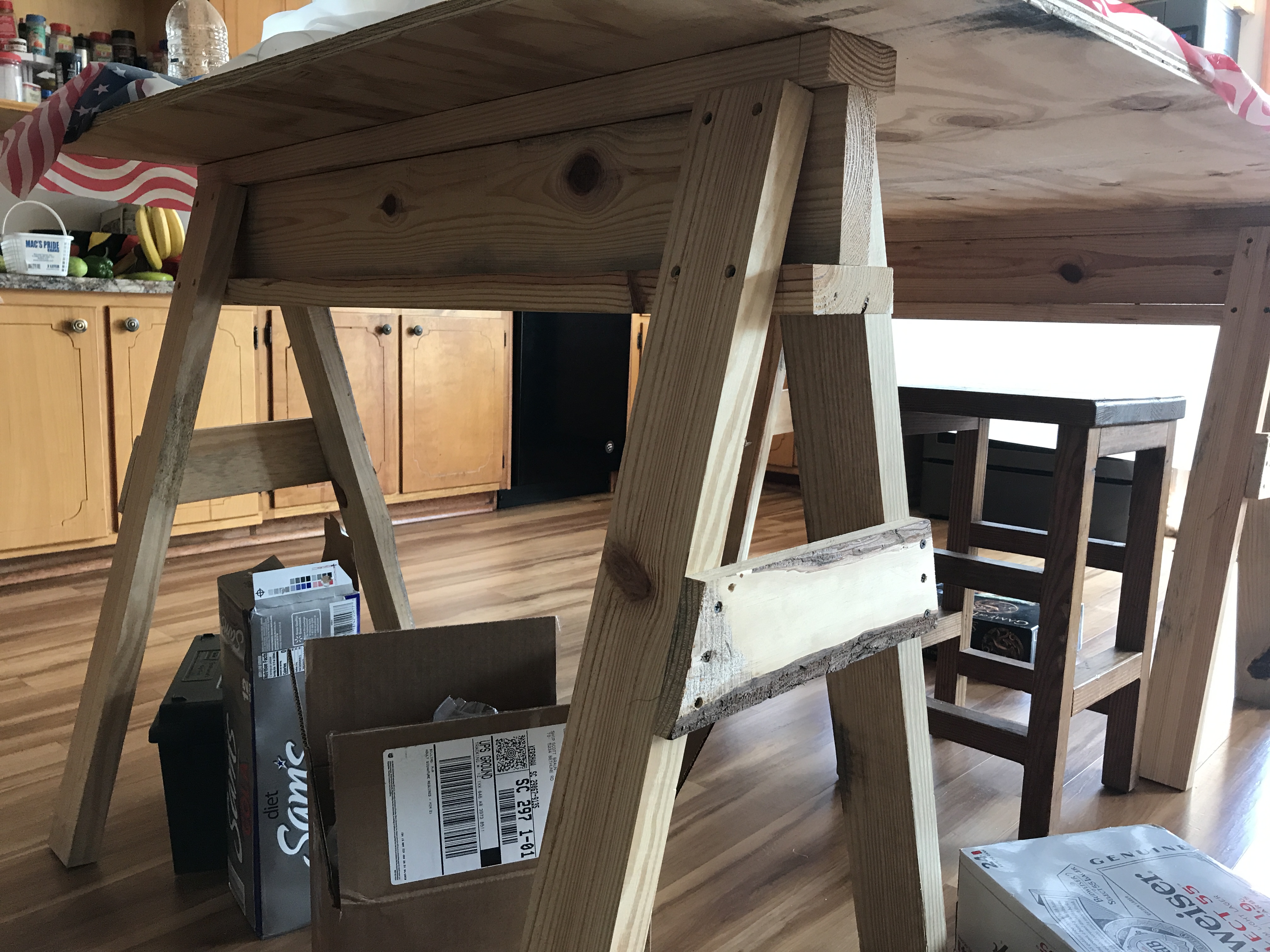

I believe this is what he is talking about, you are making a little "I" beam on top. This way you can make them as long as you want, I used a 2x5 on the bottom to give the legs a little more spread. I normally cut my legs at 32-36 inches depending what I'm using them for. These are 36" and are for a temporary island in my kitchen.
My dad used to make them like that. He'd knock out a few, as needed and get to work.
I was out in the shop today and counted the clamps on that wall in question. 45 total clamps there of several different varieties..:D
They are easy to make and very customizable, taller , shorter , whatever length you want, you can change the splay of the legs with a different width bottom piece. Whatever you want.
