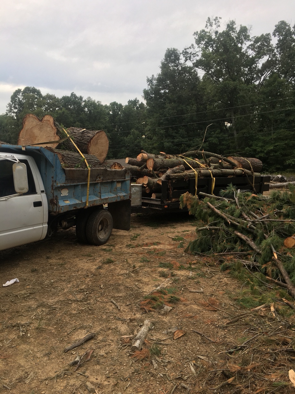

Here’s a load I hauled on my dually. It’s pine so not epically overloaded. IMG_4519.JPG
