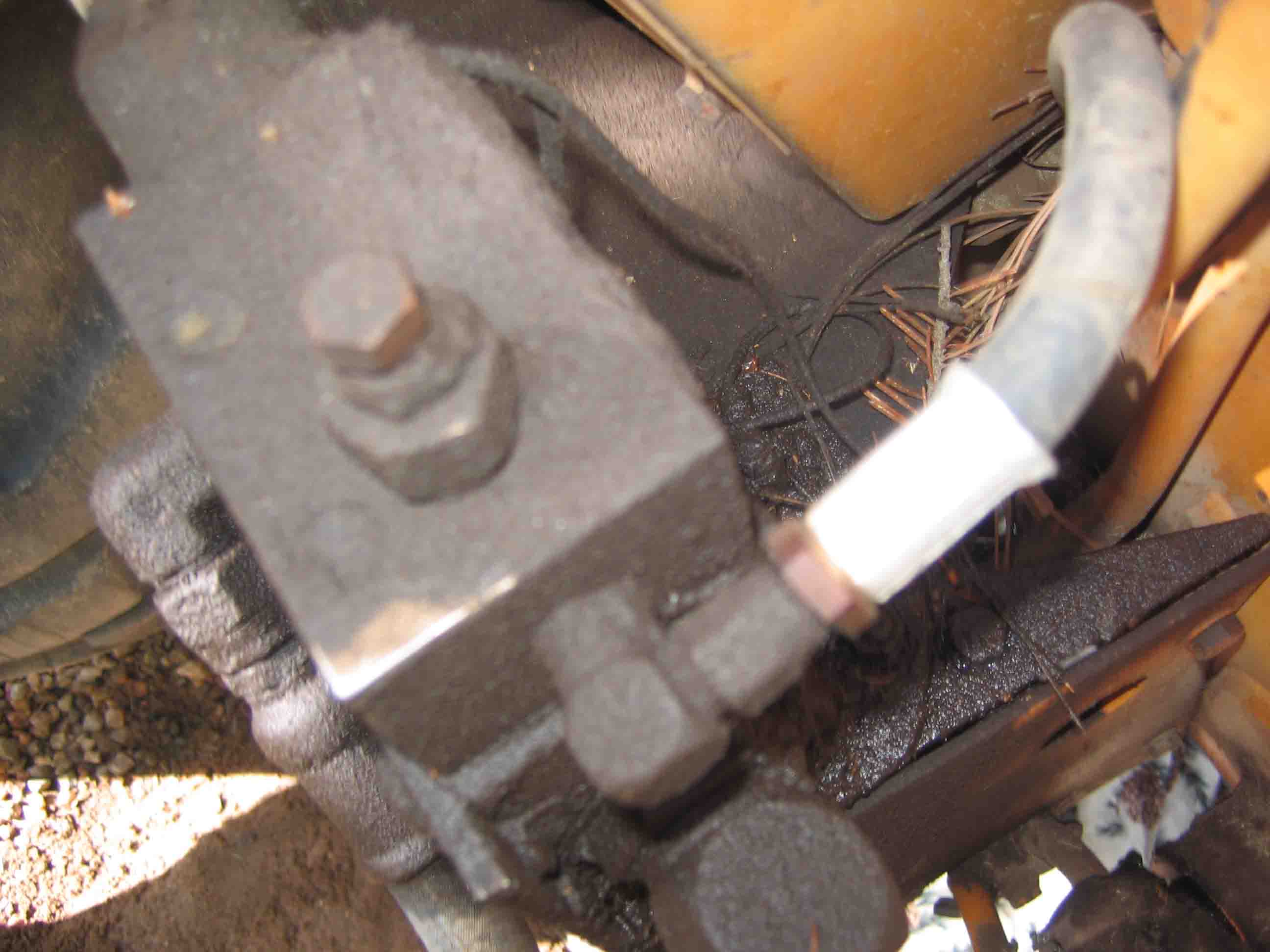

"there's no such thing as a stupid question,only stupid answers" with that said ,,i'm stuck on stupid appearently, i bought a shop manual have been evertwhere on internet ,even talked to ppl, on a 1986 case 580D backhoe i got a line comming out each side the lower backhoe arm where it swivels, with quick releases on them,, what are these lines 4 ,where do they go an is there anyway i can use to operate a hydro. rock hammer ?lines ,just spent the most part of this day with that machine,,the cab is very basic,only the controls in pictures,,. i even played in the dirt with it, i crawed under ,poked it from the rear with a stick n flashlight,i crawed under n followed the lines ,i lost them (2 lines )a top the rear axel ,,either it so common i
m missing it or it just vanished leaving no bolt holes drilled,,,,wires hanging, no handles floping, i been a mechanic for 30+years, an i'm havin the worst blonde moment of my life,,, going to try to enclose pictures,,,,,,,,,,,,thks case loader ooa.jpgIMG_1038 001.jpgbrackets.jpgdash oooa.jpgIMG_1044 004.jpgcase loader ooa.jpg

after spending a good part of the morning chasing/following ,,i found where at least 1, possibly 2 (both ) hydaurlic lines w/ quick couplers go but i cant find any reference to or picture of the pictured device,,,,,the 2 extra/aux. hydraulic lines are attached to it an there are a few wires leading from it (yet to follow ,thats another day) .it is located on the would be passenger side of tractor at the end of the loader bucket arm next the front of cab) any ides ? aux lines 002.jpgaux lines 001.jpg

There should be a Power Beyond port at the rear of the loader controls, should be a 3/4" line - this normally goes to the hoe valves alongside the right (passenger) rear wheel and under the floor plates, back to the hoe control valves.
Sounds/looks to me like yours has an aux solenoid valve that is probably plumbed in BETWEEN the loader valves and the hoe valves - if so, the PB out of the loader valves should be going to the solenoid valve, the tank/drain port of the solenoid would be teed into tank return (there should be a tee or two on the lower inside of the loader valves toward the cab, this is tank return) and the A and B work ports would connect to your QD's - finally, there should be a PB output on the solenoid valve that would continue on to run the hoe.
There doesn't look to be that many lines on the solenoid though - it's possible that ALL its ports can stand full pressure. if so, I'd guess that the two larger lines going DOWN are connected to your QD's, because the large line going rearward seems to be headed the right direction to get to the PB off the loader.
That's my best guess ATM without more pics and input from you. I'll be curious to see where the wires go, and if there's anything on the other end... Steve

The valve with wires could be a 3rd function valve for the hyd to the aux circuit on the boom for hyd hammers, hyd motors, or thumb, or a simple aux circuit.
Did you ever remove the QD's off those lines and see if yo had any flow with any lever activation.
If not, see if you can find a switch to activate the solenoid on the valve.
If it is in fact a solenoid valve, remove the wires and apply 12v and ground to the solenoid and see if there is flow out the aux hyd lines.
It should easy enough to put a meter on the solenoid and flip some switches to find the one for the valve.
It could be the valve that switches the hyd flow from normal flow to high flow.
