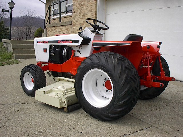

Thanks, again. The 4040H PowerMax is a really nice tractor with very low hours. It needs nothing and is ready to go. They are definitely fast becoming collectors items. Really well constructed, work-horse tractors, too. I still have a 48" Woods brush hog available for it, also. Make me an offer on the whole package - my new B2910 is on its way. Finalized the deal today!

Yes it has hydraulic lift w/ position control for the mower deck - works off of the 3-point, just like the new ones. No power steering, but it doesn't need it, as it steers really nice. Pretty simple operation - with the hand operated (3-range) hydrostat and live, independent PTO's. Yes, the Woods Billy Goat is a 2000 rpm, backward spinner. ;o)
I think you'd use it a lot more than you think. You'd probably start using it more than the 445. Heck, just shoot across PA and you're here. I'm 100 miles west of Pittsburgh. Check on www.simpletractors.com for more information on these tractors. They have quite a following.
