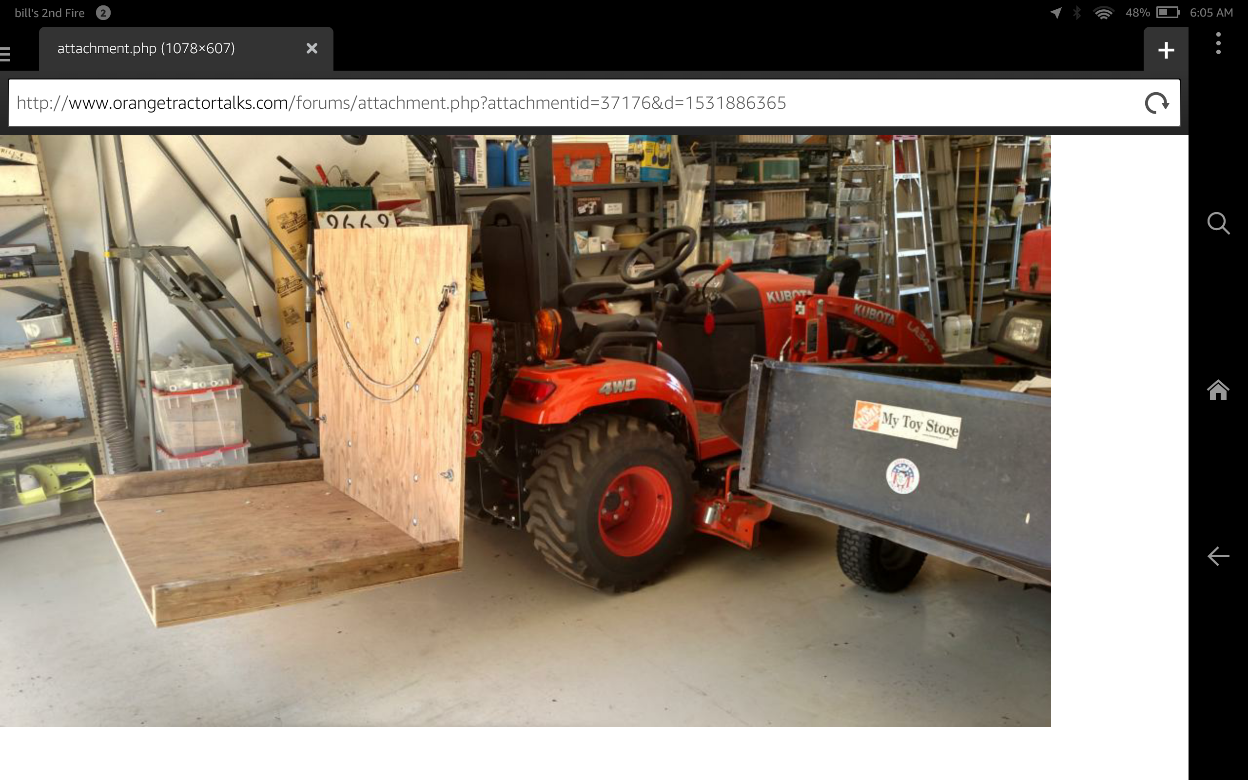

Regarding the carry all mine is 15 years old built a 2 by 6 decking floor and 3/4 plywood walls. I think they are 4 by 3 1/2 feet. I load that up with all the firewood it will hold. Never had a problem

The Carry All I had on my older tractor worked well with a home built deck and back panel much like the picture in post #18.
Now with the tractor we have (bigger) I'm going to get a set of 3pt pallet forks, build a similar deck and back board, but bigger as this tractor has more capacity.

I just finished my carry-all that I will use as a loader work platform, wood hauler.
