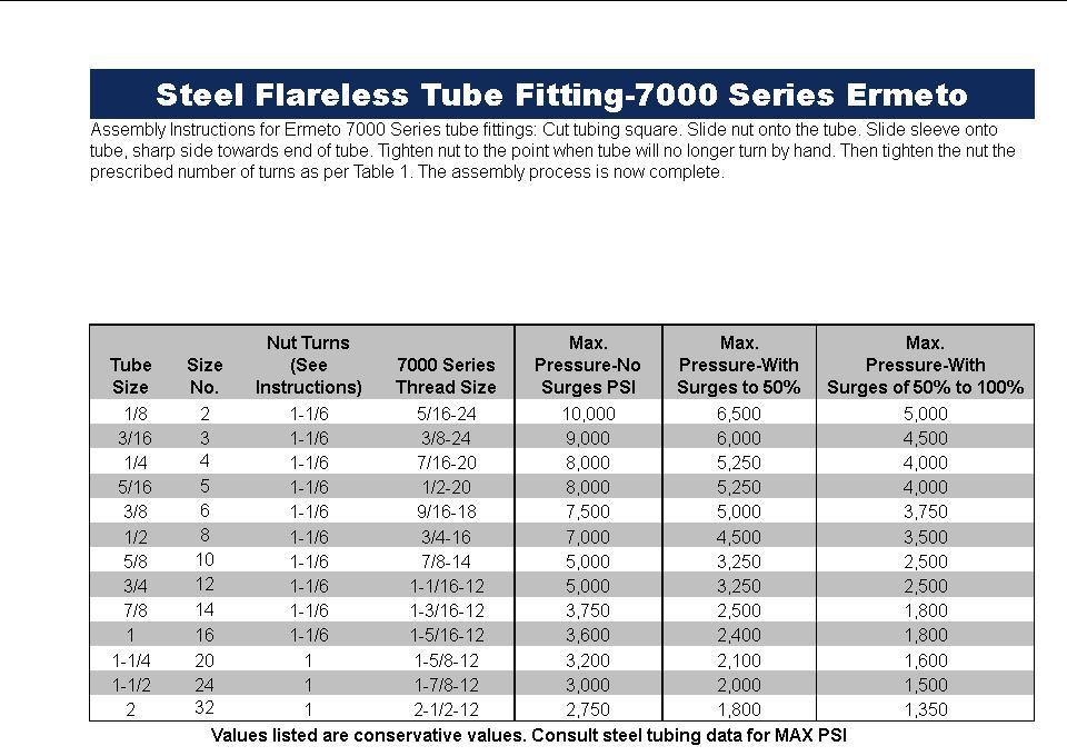

If you're just getting into Swage-lok stuff at work, they have VERY specific tightening instructions that vary somewhat with the size - the reason for that is removability - if you don't tighten the fitting ENOUGH, it will leak. IF you tighten it to spec, if won't leak and you can unscrew it and put it back together easily with no leaks.
If you tighten it TOO much, you will upset the end of the tubing that seats inside the fitting too much, swelling it so it won't come out. If you tighten it THREE much :D it's possible to get a stress crack in the fitting body.
These flareless fittings are NOT Swage-lok, but work similarly - with both, you want them tightened just til you can see a SLIGHT deformation where the sleeve fits around the tubing - less, and they'll come apart under pressure; too much, and they can deform and leak.
When I first started using the flareless fittings, I bought a few spares so I could screw up a couple as a learning experience - I found you can get it figured out in 2-3 tries by just paying attention, knowing approximately how much to tighten, and looking at where the crimped sleeve joins the tubing.
Here's a different brand's chart that worked fine for me... Steve
Stress cracks.........reminds me of making AN (JIC) stainless steel flares on lines for DC-9s. Tighten the flaring tool too tight and oops, crack.........start over
Thanks for the instructions.
hugs, Brandi

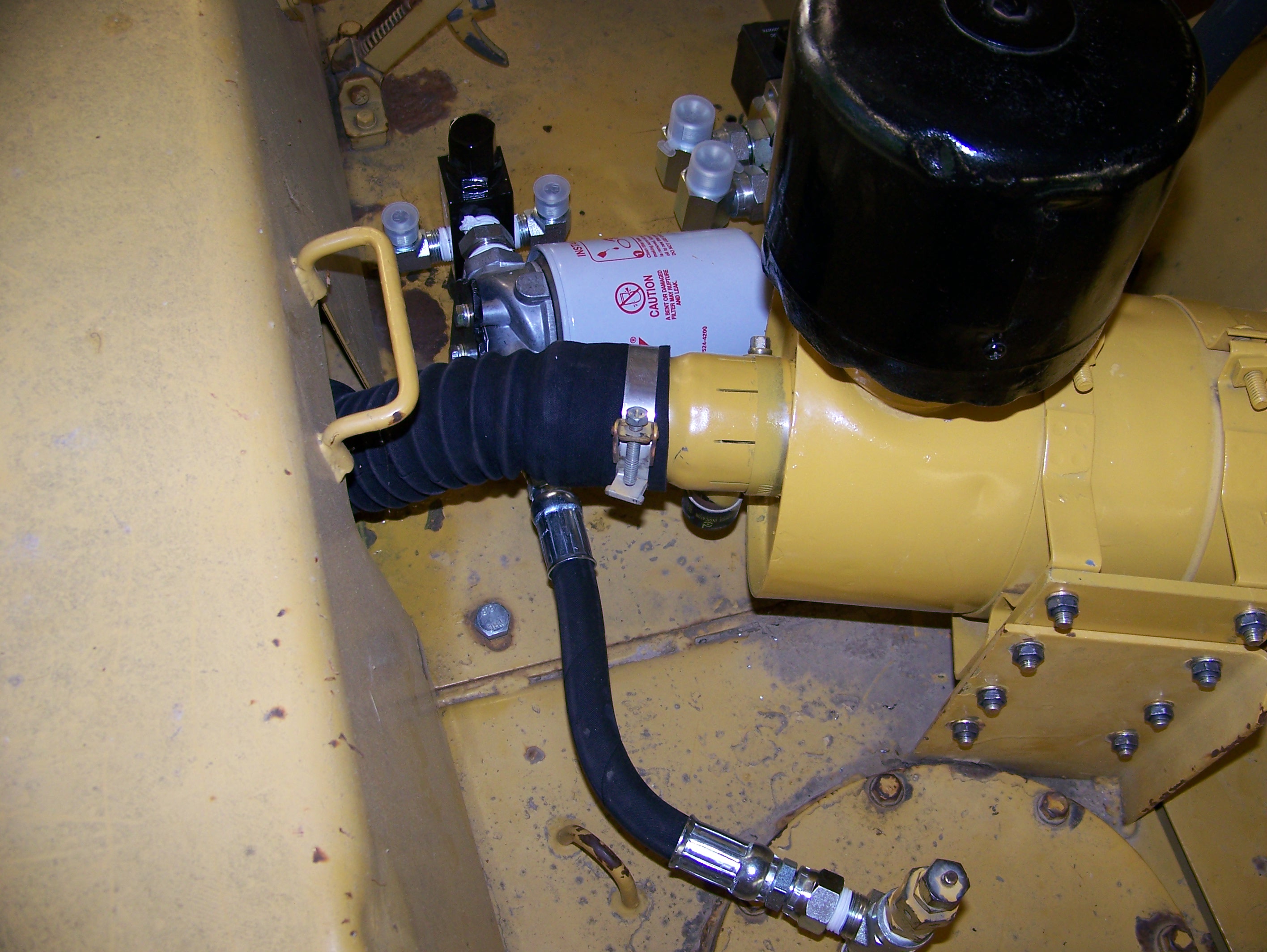

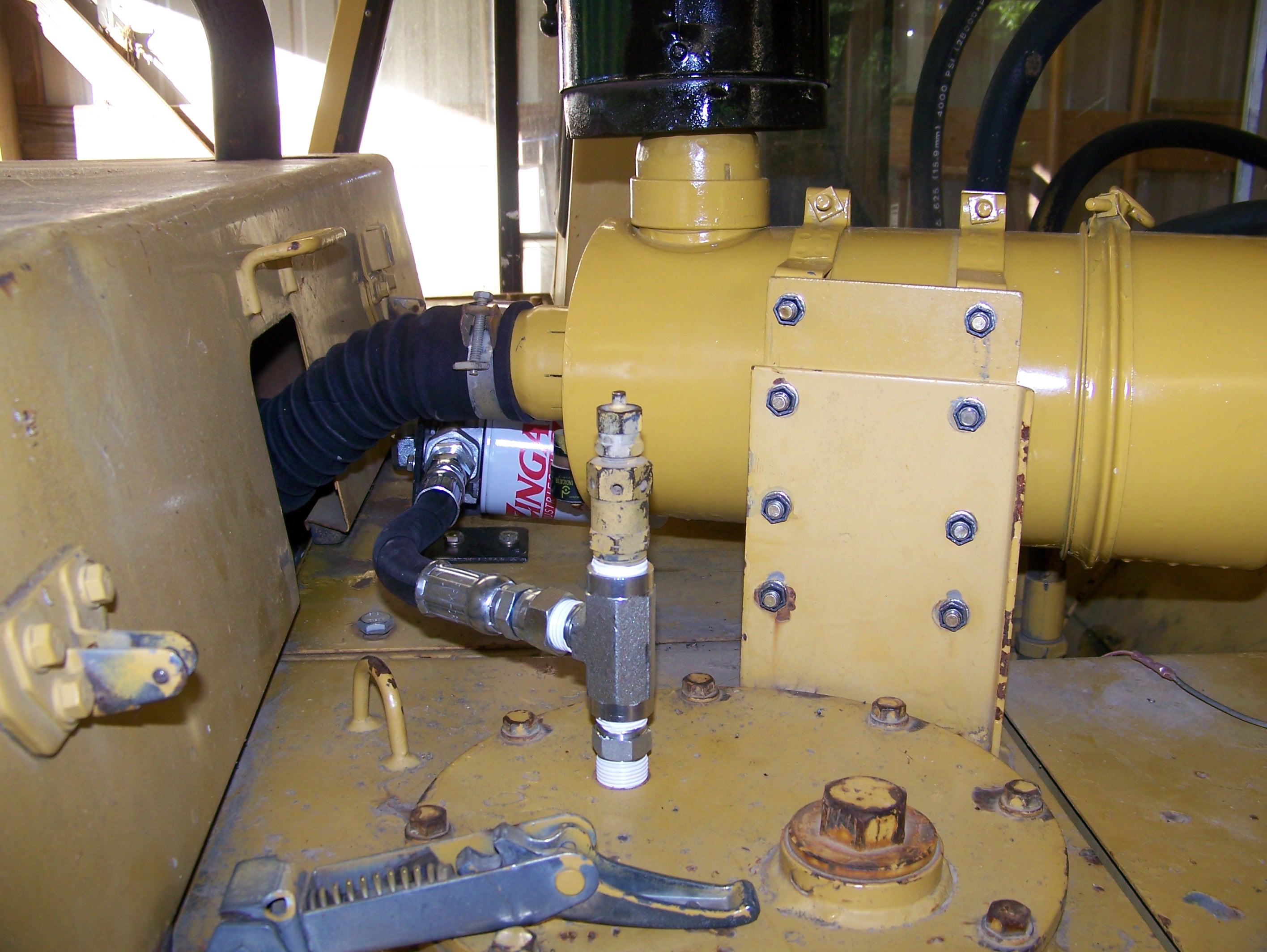

The air intake hose came in today. Here it is with the air filter assembly raised 2 inches.CAT Air Intake Hose Installed.jpg
Also the hoses from Discount Hydraulic Hose came in. Here is the relief filter to tank line installed.CAT Filter To Tank Line Installed.jpg
hugs, Brandi
