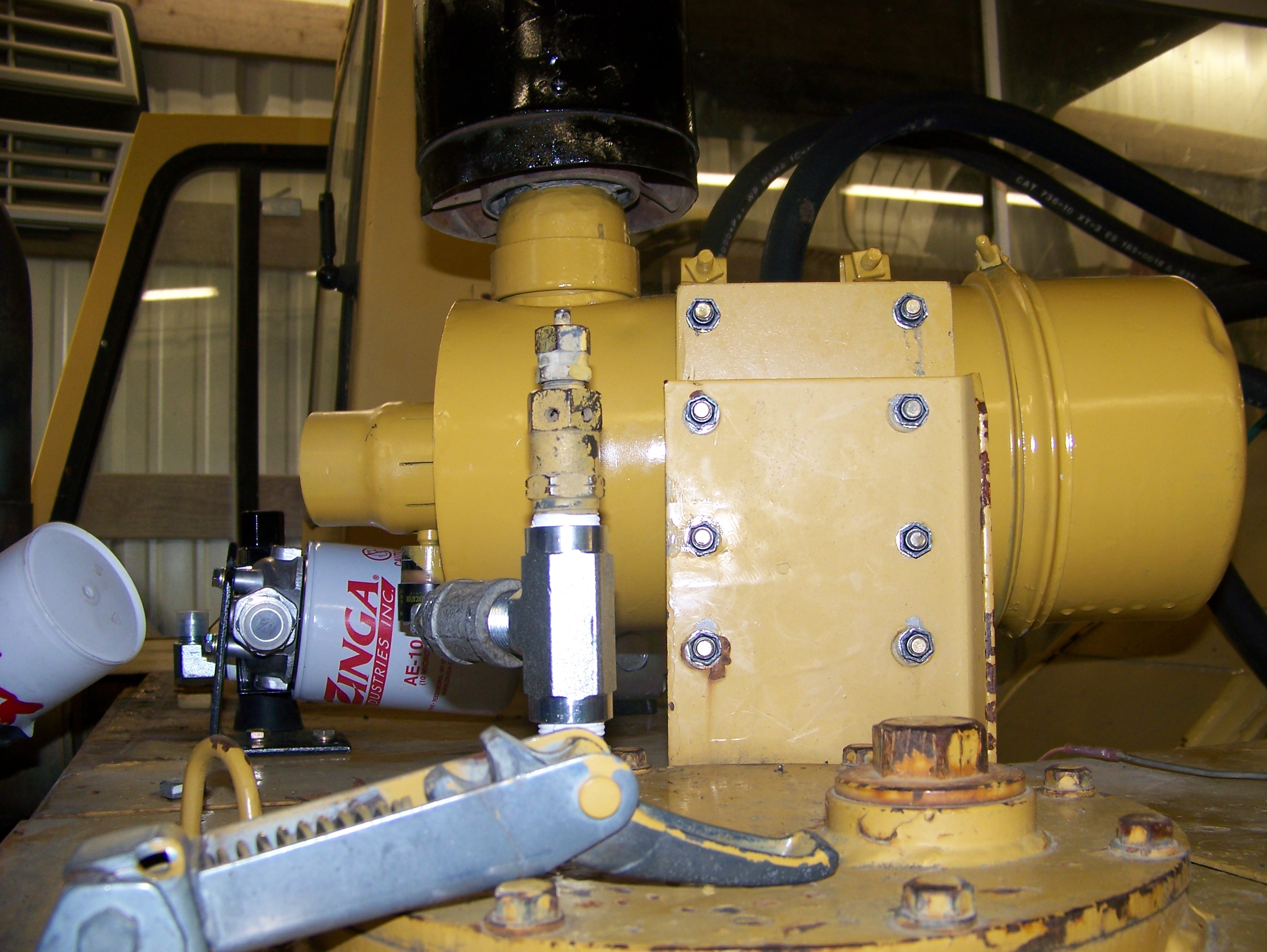

Air Filter back together and raised 2 inches. CAT Air Filter Raised.jpg Now the relief valve line via the filter back to the tank will clear.
hugs, Brandi

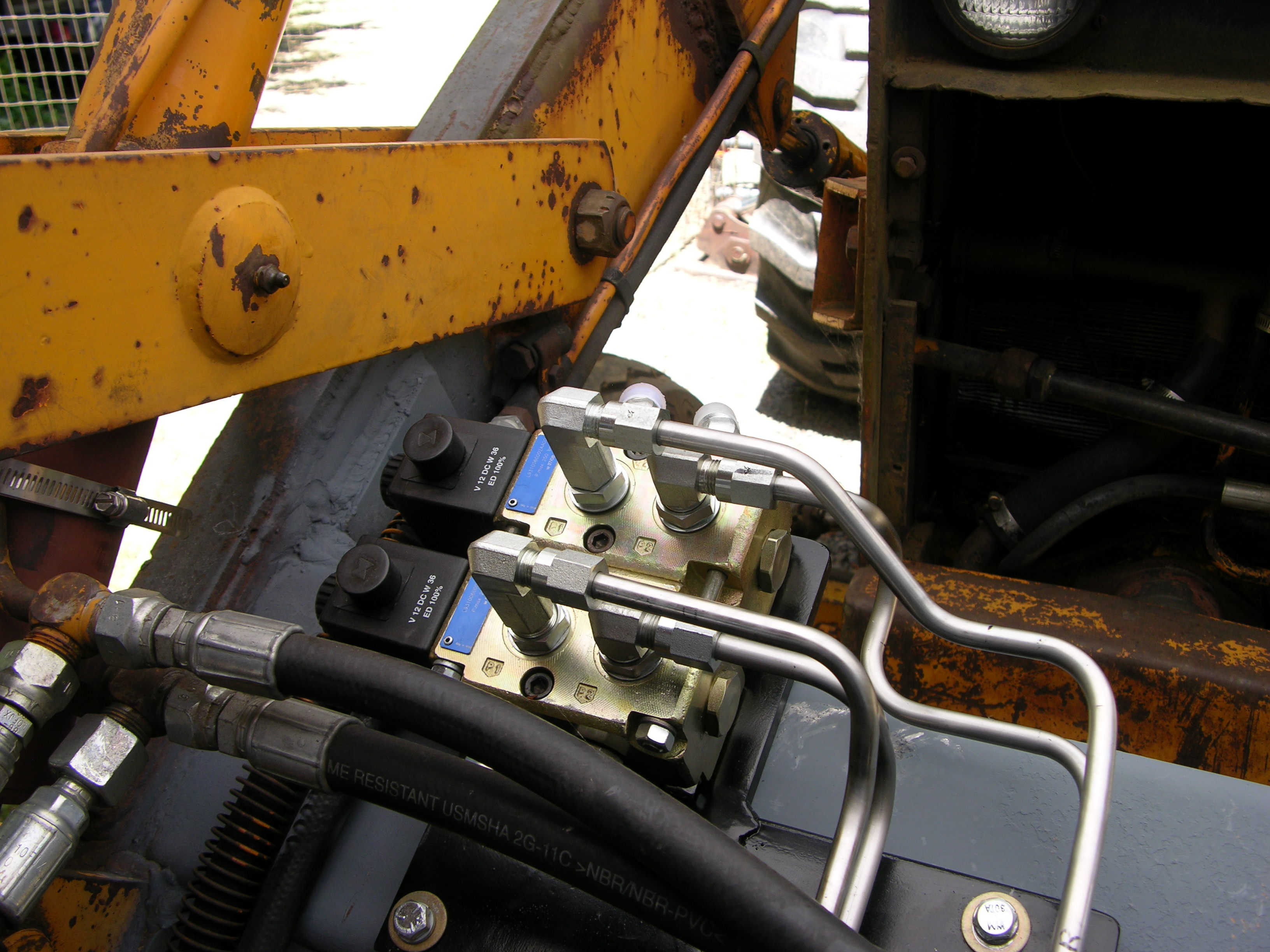

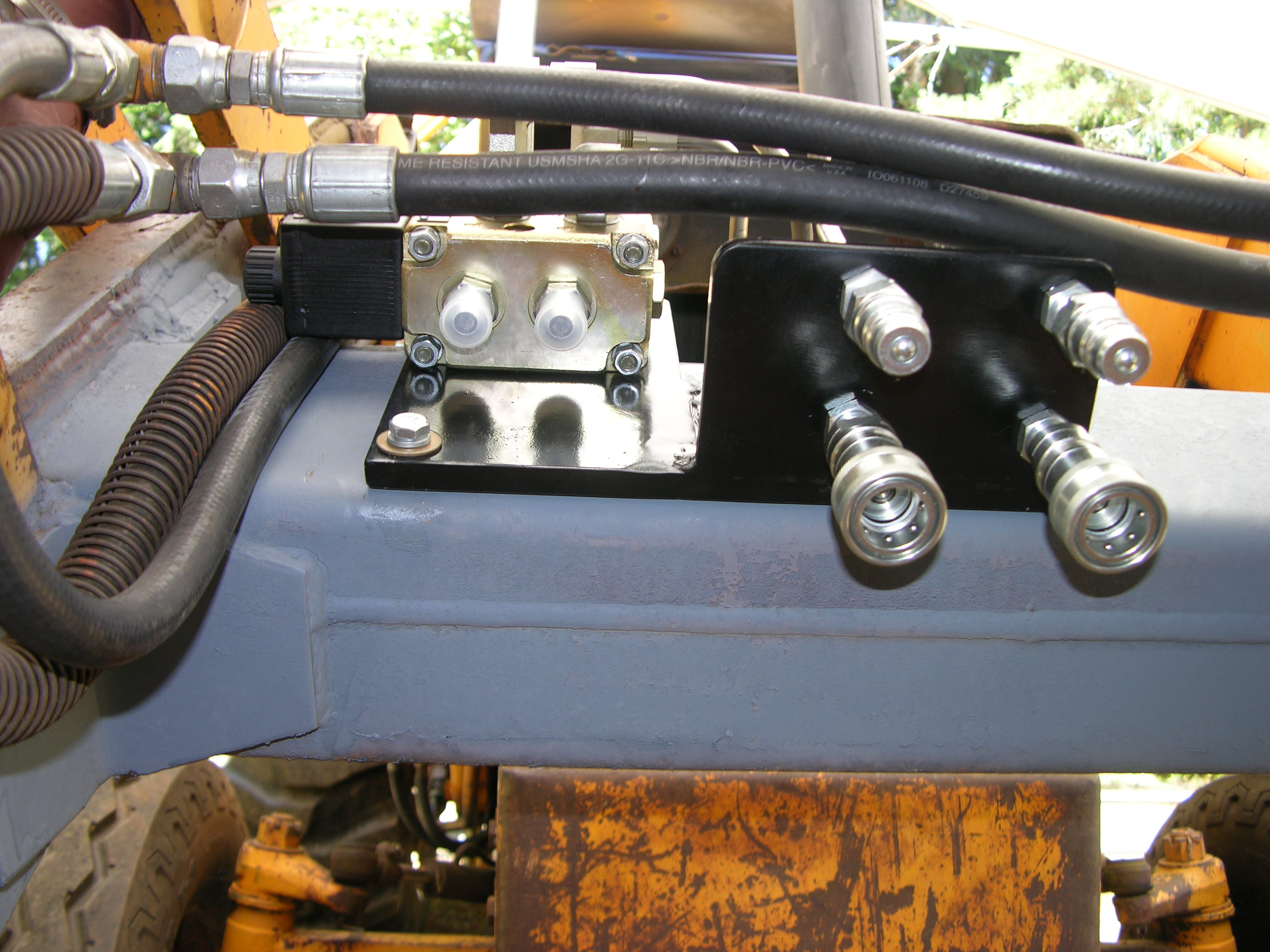

Found a couple pix of the flareless JIC's on my 580 (part of a larger project incl. loader QA, grapple, etc) - these are 3/8", don't need speed for anything these extra remotes will control - sorry about the "bundle of snakes", I wanted to keep these as low to the deck as possible :D
I like your installation with hard lines at the valves. What do the two valves do? Are those lines stainless?
Just price 1/2 inch JIC flareless connectors...........at $23.86 each!
27208-08-08 | 1/2" JIC Male x 1/2" Flareless
But the cost of the items seperate, the way you did it, is total....$$5.26. What is the difference? Or am I missing something?
hugs, Brandi
