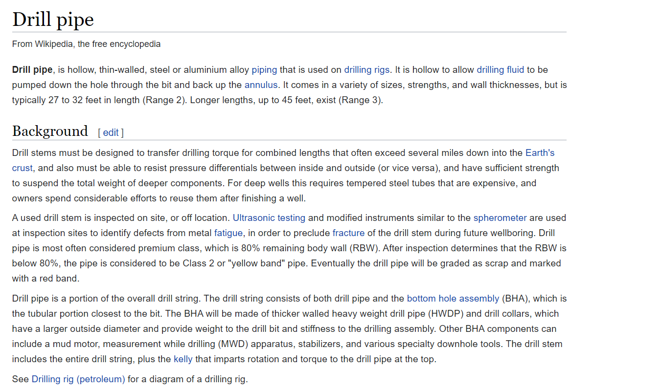

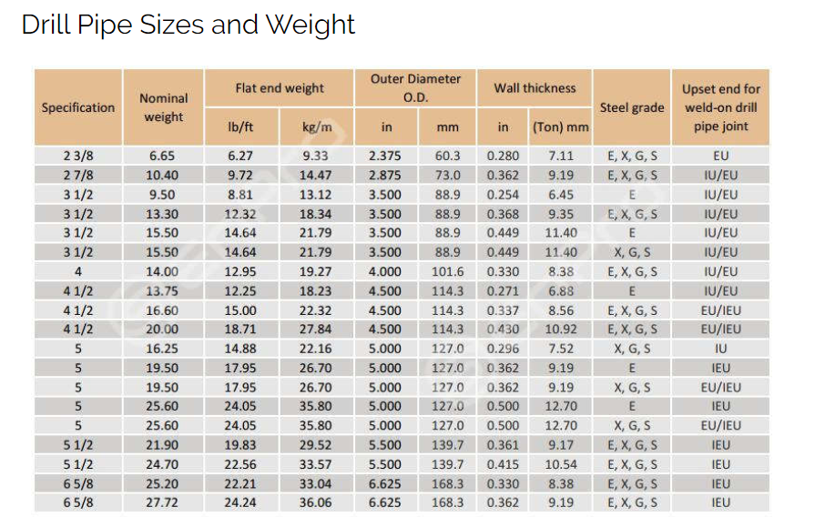

TX Jim. 2 and 7/8ths is well pipe. Drill stem is much larger dia, like 4"+ and much, much heavier. This is drill stem seen below and very much a different animal.

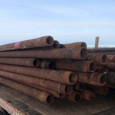

   / Cattle guards - make or buy #8
Down where I live the pipe utilized for my cattle guard is referred to to as Drill Stem identical to photo's below. I hope you have a wonderful day. I know I will!
Jim
Jim
2-3/8 and 2-7/8 pipe are not drill stem. Lots of people incorrectly call it that because it comes from the oilfield I guess. What they are is upset tubing used for pumping fluid out of the wells after they are drilled. Drill stem is much heavier wall and bigger in diameter. Drill stem is what is used on the drilling rig with the bit connected to the bottom to drill the well. The 2-3/8 or 2-7/8 would twist like a pretzel if used for this application. Go drive by a drill rig and see what they have sitting on the racks it ain’t the stuff people are building fences out of.
   / Cattle guards - make or buy #15
You got that right bdog. Drill stem is so, so much heavier and I've never seen used and up for sale.. I'm sure some come up but that would be rare, but old used well pipe is everywhere and for sale. Seems like I welded 2-7/8s every day for three years. Did enough of that. o_O Maybe they call it "drill pipe" because that sounds better?
