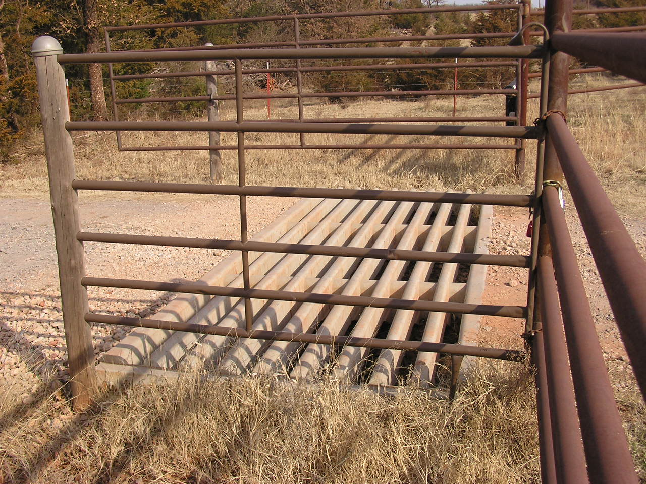

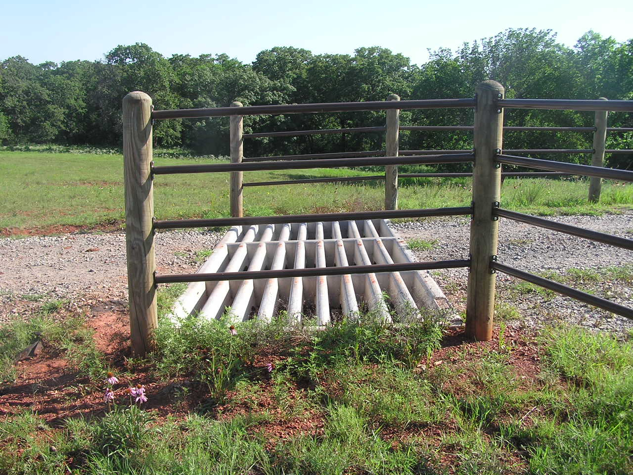

This isn't saying much, but in my area I've actually never seen a "commercial" production cattle guard. They are always home-built, including mine. (Which has been laying on the ground for 2 years waiting for me to dig a hole and pour concrete 😐).
The top pipes are usually 2-7/8 used drill pipe for residential guards, heavier stuff at businesses with more traffic.
Similar to a previous post, the friend who welded it together delivered it on a flatbed trailer. We chained it to the tractor and he drove forward till it dropped off the trailer. After that I was able to move it by chaining up one end to the 3pt and dragging it.
   / Cattle guards - make or buy #13
The previous owner put in two cattle guards using 2 1/2” water pipe. Wasn’t durable with big trucks. Repaired with well drilling pipe was stronger. Rebuilt using 3” square tubing, 8” wide channel sides, capping H beams and 50# of 7018 rod. 4 - 1.5” bolts hold each grid down. Made where I can remove and clean under if needed. Thru the woods steep driveway. Held up for past 21 years. Last week 75K# gravel trucks crossed them. At the time I could have bought used railroad rail for the same price as the new tubing, ~$500 for each guard. Just too heavy.

Down where I live the pipe utilized for my cattle guard is referred to to as Drill Stem identical to photo's below. I hope you have a wonderful day. I know I will!
Jim
2-3/8 and 2-7/8 pipe are not drill stem. Lots of people incorrectly call it that because it comes from the oilfield I guess. What they are is upset tubing used for pumping fluid out of the wells after they are drilled. Drill stem is much heavier wall and bigger in diameter. Drill stem is what is used on the drilling rig with the bit connected to the bottom to drill the well. The 2-3/8 or 2-7/8 would twist like a pretzel if used for this application. Go drive by a drill rig and see what they have sitting on the racks it ain’t the stuff people are building fences out of.
   / Cattle guards - make or buy #15
You got that right bdog. Drill stem is so, so much heavier and I've never seen used and up for sale.. I'm sure some come up but that would be rare, but old used well pipe is everywhere and for sale. Seems like I welded 2-7/8s every day for three years. Did enough of that. o_O Maybe they call it "drill pipe" because that sounds better?

We had good results with concrete: Farm Products | SI Precast Concrete
