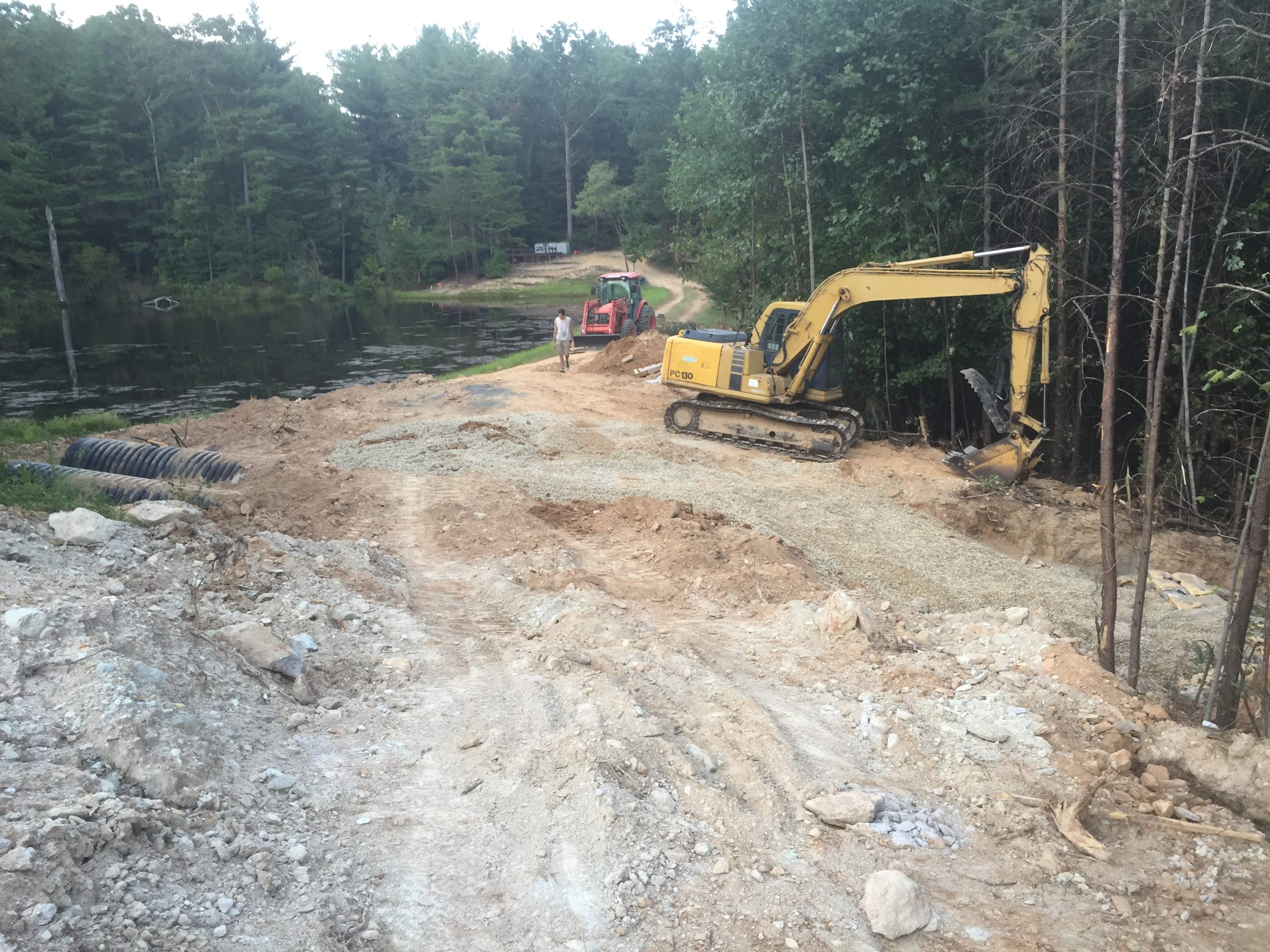

I was back at it yesterday. I had another load of gravel delivered to the bridge. I focused on getting the cement bag retaining wall started at the outlet end, so I could backfill with gravel. First I dug out a space under the end of the pipes that was wide enough for two bags. I removed about 4 inches of gravel and less than 4 inches of dirt before hitting bedrock on the pipe on the left, and the pipe on the right was already at bedrock when I spread about 6 inches of gravel on it so all I had to do was pull that out. IMG_4711.JPG Then I started moving cement bags. I am going to include a picture of how I stored them on the site for the last month, because I was very happy about how they held up. I was worried about getting moisture from the ground and air into the bags. IT has been very humid and we have had a few hard rains. Overall it has been dry the last month so I think part of this was just luck. I covered the entire stack of cement (10 Pallets) with black plastic and used gorilla tape to keep it tight on there. I had already started opening it on the right hand side when I decided to take a picture.
There were about 48 bags per pallet. 80Lbs each. My tractor can pick that up but the whole thing was bouncy. Part of that is the springiness of the pallet forks. I didn't like how it felt, so I offloaded 2 loads of 12-14 bags to my Bobcat UTV and moved them to the bridge. Getting the bags from the road, down to where I wanted to use them was a chore. I had brought a large plastic sled with me thinking I might have to load 2 bags at time and drag them down the hill of gravel. I decided that was going to be too much work, so I knocked down a few more trees on the hill and built up some dirt so I could get the excavator close enough to dump the bags as gently as possible onto the ground right in front of the work area.IMG_4713.JPG
Some of the bags were broken before coming off the pallet. I set those aside for later. dumping the bags resulted in about %20 bags breaking. Broken bags were placed on the inside stack and severely broken bags were left on the ground and the cement was shoveled behind the stacks, and mixed in with the gravel backfill.
Having to move the bags 3 times was not a lot of fun. I got thru 2 pallets yesterday and backfilled up to the level of the stack wall.
On the far left of wall you can see a little zigzag pattern that I did because I wanted to incorporate a natural protrusion in the bedrock, into the wall. As I go up, there is a large ridge sticking out that will work well to keeping the wall locked in place.

I found out that my boys can lift those bags. So can my wife. She outworked the boys... darn near outworked me. We got 4 pallets of cement stacked up. On average, the pallets had 42 bags. 6 layers of 7 I might have miscounted the pallets I did yesterday. Today, the tractor absolutely did not like lifting the top pallet off the bottom pallet. Not enough ballast on the rear. I have my 84 inch landscape rake on the back, and not the box blade. So everything was carried in the UTV. We have had 10 pallets to start, and we have 4 pallets left. That makes me think I may need to get some more cement...either a couple pickup loads or a good trailer load. We will see.
The first thing I did today was increase the backfill and then we started moving cement bags. My boys were not shy from the work, so I was happy. And once I showed my stepson what was needed with knifing in the gravel, he threw himself into that task as well. We spread the 18 tons that were left on the bridge this week, and my wife brought down about 7-8 more tractor loads from the pile at the road.
I drove a couple dozen 4 foot long, 1/2 inch rebar rods into the stacks to pin them together and a few rods thru the stacks into the gravel backfill.
We made pretty good progress today. The walls for the retaining wall are two bags deep, except the ones that border the clay wall of the ditch.
The backfill is 4 feet high, all the way the the end of the pipe. I will even it out then start loading clay on it. I may go another layer or two with the bags just to match the edge of the ditch.
There was a fair amount of concrete mix left in a pile. I figured it would be fine, since I intend to come back and dump 10 tons of riprap down there to help slow down some of that fast water coming down the pipes.

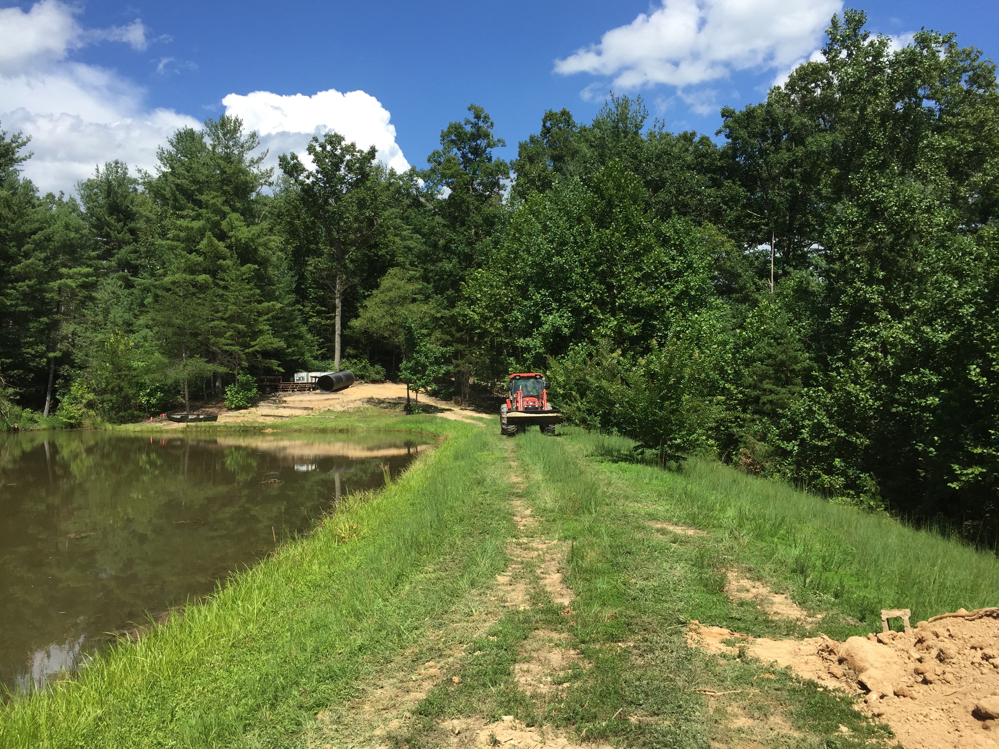

The view from up the road, looking down at the bridge isn't too bad. We are getting there.

Your view from the road rotated upright:
/ Cement Bag Retaining Wall
#74
I hadn't noticed that two of the pictures display upside down when enlarged. How did you fix that?
/ Cement Bag Retaining Wall #75
I opened yours, saved it locally on my PC, resaved it there after rotating it 180 degrees, and then attached it to my response. Not sure why they do that sometimes, but your picture looks much better upright. ;)
