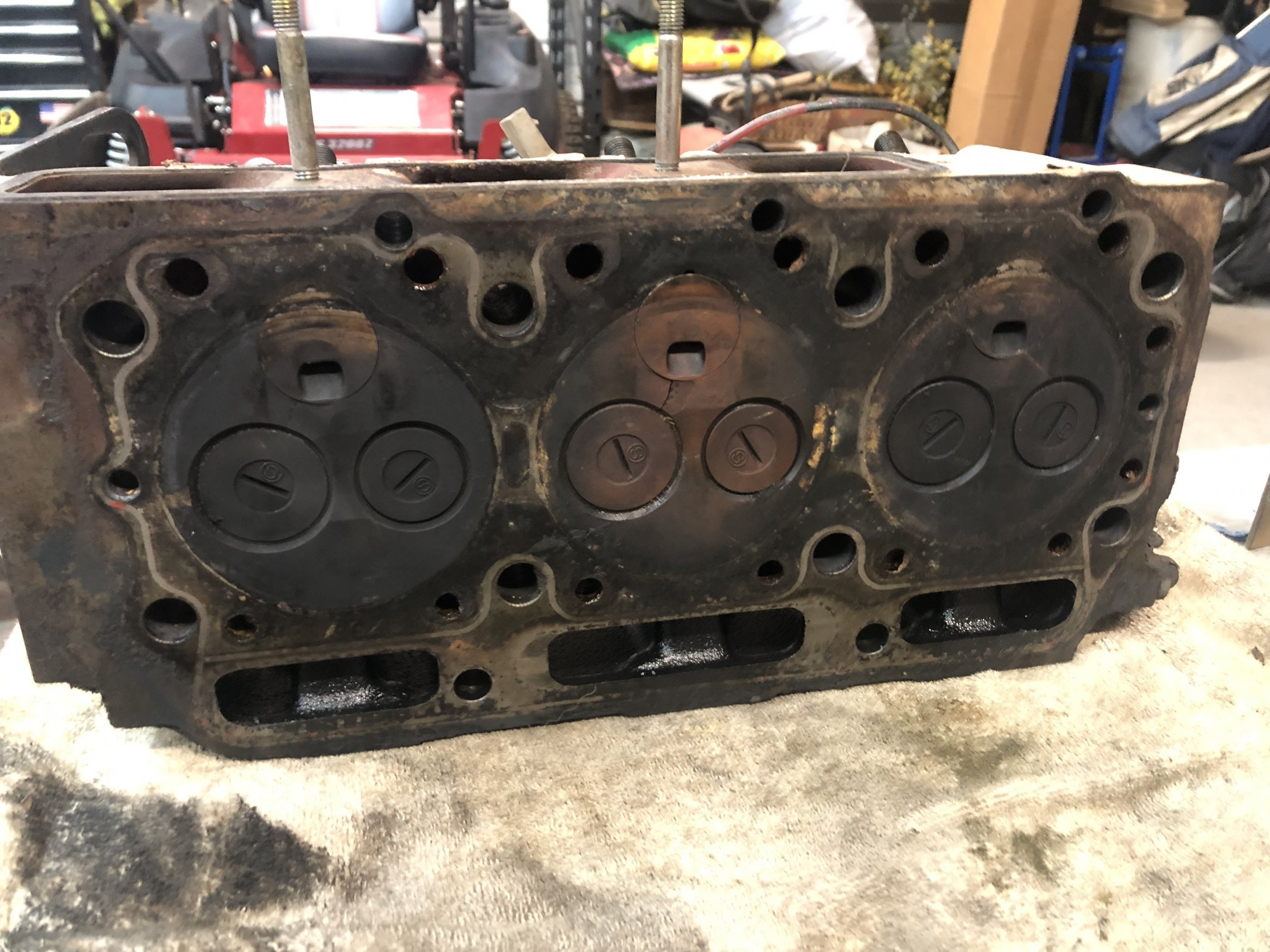

I actually did have a picture of the cracks.

Tore it apart today to replace the head gasket and there are 4 cracks in the head. Anyone know of a source for a new head?

That's crazy! looks like every cylinder has a crack near the valve. did it get overheated a few times and finally gave up? or just would not start one day?
Don't' forget to take some repaired pics. also once you get it back together run it hard and fast for hours LOL 😂

It did. 4 cracks total. I was tilling my track and it just started boiling over. It looked like a steam engine. It had never run hot before that which was odd. I will post pictures when I get back from picking it up tomorrow.

Interesting that the majority of cracks are between the IDI pre chambers and Intake valves.
More common to see cracks between cylinders or near the exhaust valves.
Guessing the head will be checked for straightness, coolant pressure tested , magnafluxed, plus valve seats and valves be re ground before you re install it?
Glad you were able to find a shop that could repair it. I bought a remanned Pontiac 455 that had a few cracks including valve seat areas on the passenger side head re welded and then remachined, ran great and never had any leaks or problems with it.
