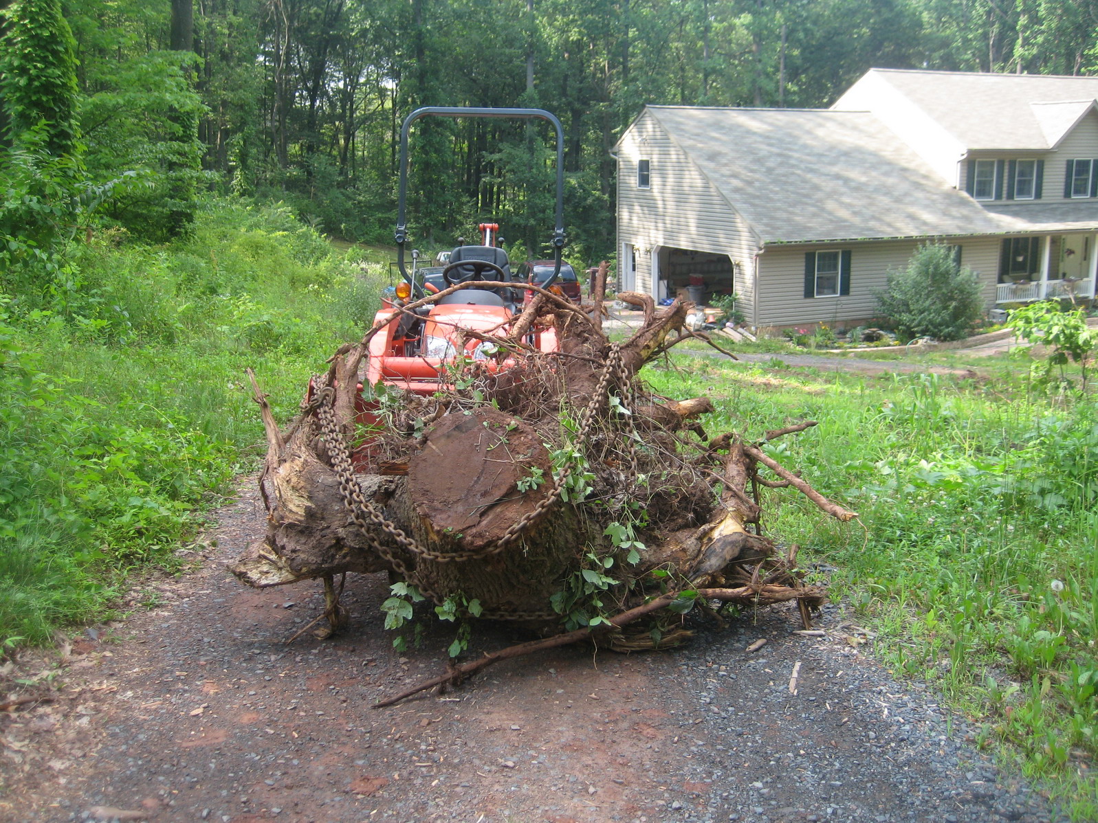

Here's the picture that I like to show off that contains the chain that I use. :) The chain is very, very overkill. It's what my dad used years back when he had a service station that had some tow trucks, before rollbacks became so popular.

   / Chain for my FEL bucket? #16
rdsaustintx said:
Is it me or is that stump wrapped with poison ivy??
Well, I hope it's the stump and not you that's wrapped in poison ivy. :D I see some leaves at the bottom left that are leaves from the tree (tulip poplar), but elsewhere, I guess those leaves could be poison ivy. All I know is that poison ivy has three leaves. I can't really identify it otherwise, because I'm lucky enough to not be allergic to it. My wife ID's poison ivy around our property, and I just grab it and rip it out and wash my hands later.
I tried the stumps I had and they laughed at my BX.
