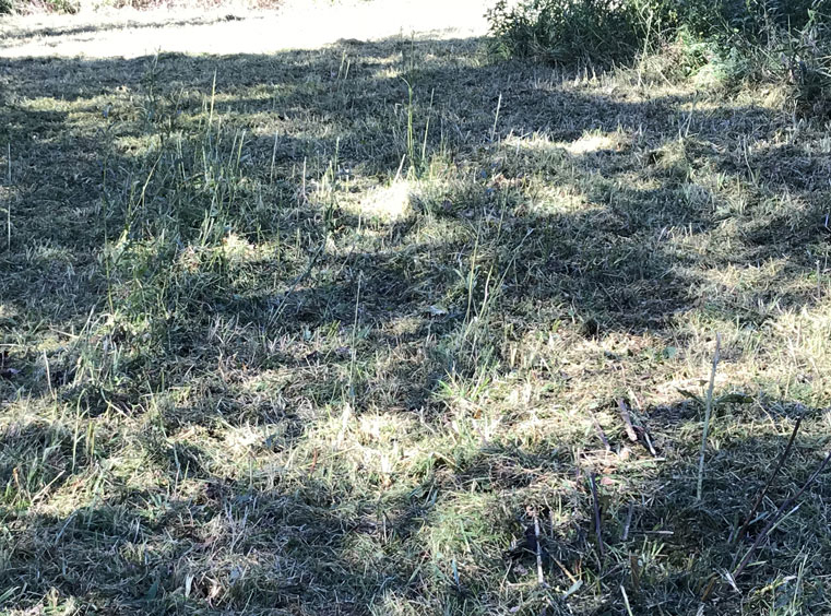

On my flail mower, I used bailer belting. It's pinched between the mower housing and a strip of 3/16x1 flat iron. The blades spin forward and I've never had an issue with uncut weeds/grass. The cut is as good as any finish cut mower. It uses the cup/spoon blades.
That's about what came on it from the factory on mine. It has hammer blades. Here's the result when mowing in the fall with the guard on:

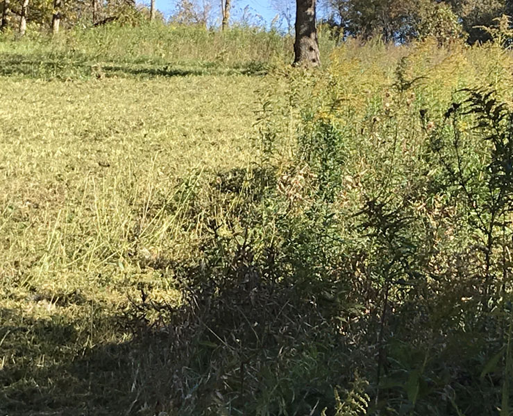

Here's what I'm trying to cut:
I've looked at the designs that put the top chain link through a notch and hold them with a rod, but making 60 or so notched holes looks challenging. So I'm leaning toward toolslinger's design that puts the chain sections on a rod held by mounting brackets. I'm not considering the designs that have the chains welded on a mounting bar.
