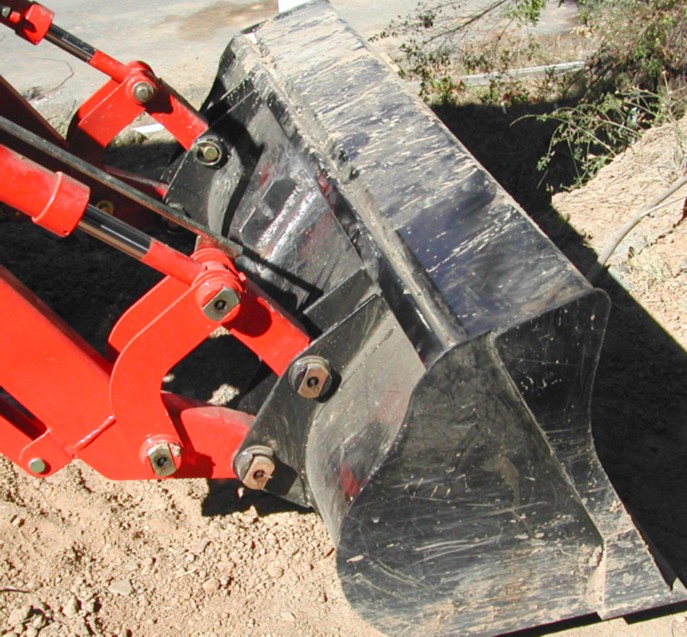

I just welded up another chain hook for my recently purchased new
Kioti. I like to install just one hook, mounted to the middle of the
back of the bucket. I use a chunk of 1/2" steel with a 1/2" wide
slot cut into it at an angle. I weld it perpendicular to a 1/4" reinforcement
plate of about 6x6". I got this idea many years ago from a
commercial b/h operator I hired. The slots work better than hooks
cuz they can be unhooked by just curling the bucket. Mounting
to the back of the bucket increases lifting capacity and avoids
bending the front bkt lip. Mounting to the bkt center avoids tweaking
the loader and/or tipping the tractor with very heavy loads. Kubota
bkts are a special challenge in that they have no flat spot on the
back of some of them.
   / Chain Hooks on JD 419 /JD790 #9
Here is a CK20 loader bucket with brand new chain slot-hook.
