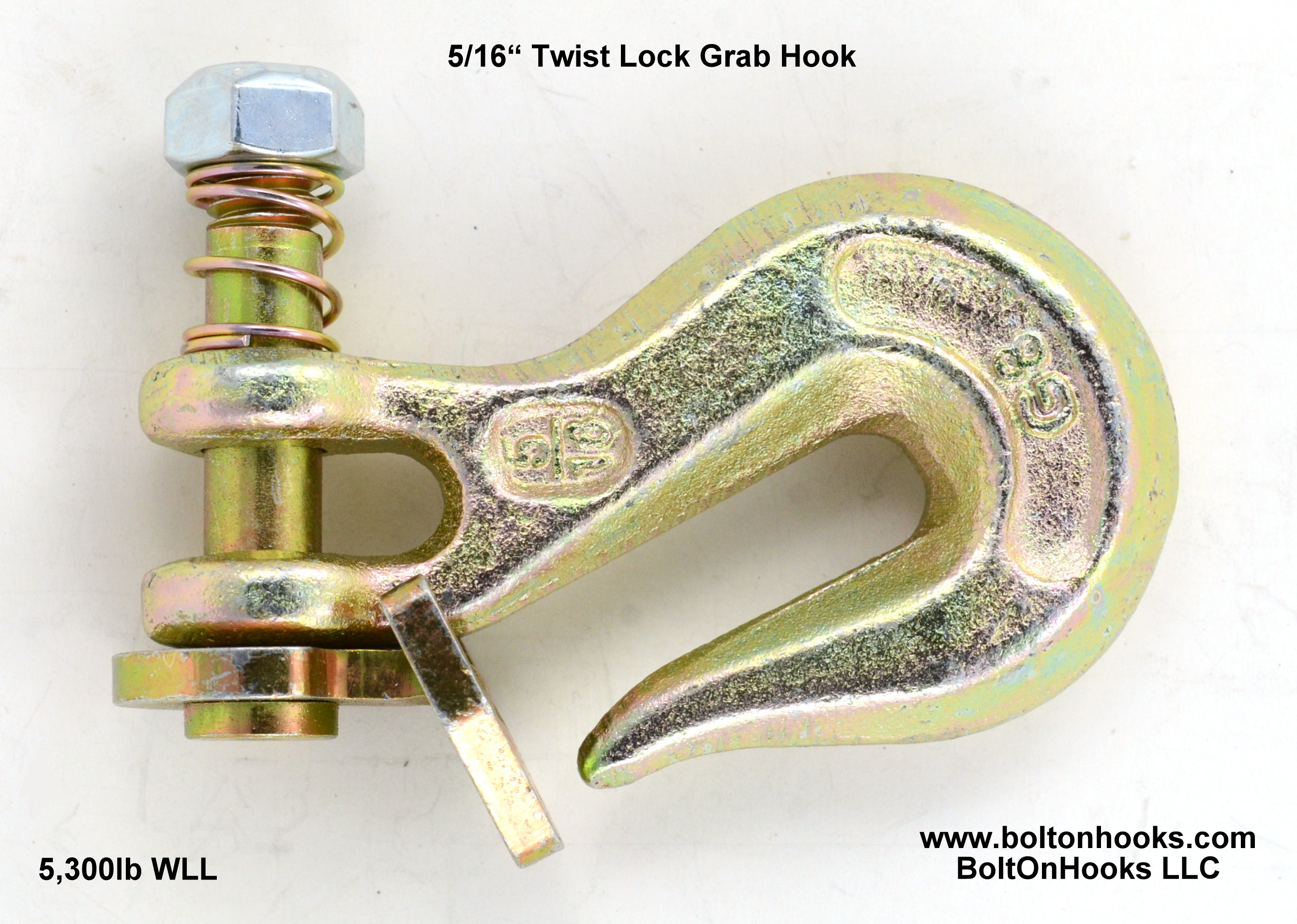

I'm sorry I wasn't clear. A shackle, of the right size for the grab hook, will be able to go where the mouse wire would.
So the only addition would be a shackle.
Electric tape, baler twine, wire are usually simple enough for when gravity can't be trusted.
Dale please try not to hurt yourself or someone else.
THis was hole point of this tread.... last thing I want is to get hurt and someone else to get hurt....
Have see one chain come loose and leave tracks in tailgate of PU truck... Its enough to make one what to be very sure that chains stay where they are supposed to....
Dale

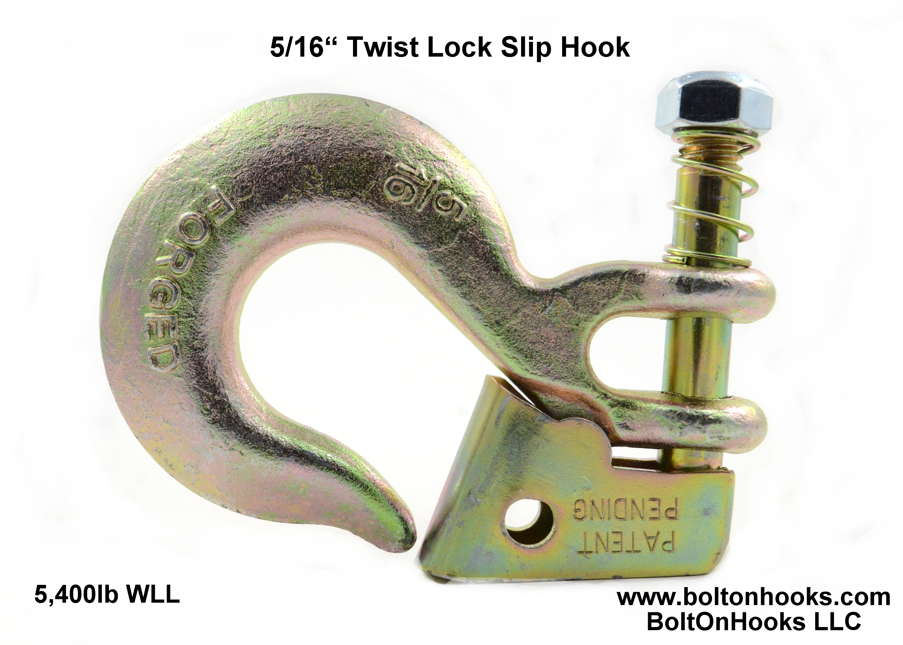

I have found that having a grab hook mounted on my bucket is the best remedy for hooks coming off.
As far as slip hooks with bent up clips yes i still have them but i do have many that still do work. The bent ones got bent draging logs out of the woods.
They do make a better slip hook with keeper. The end of the hook fits into a notch on the latch to keep it from getting bent to the side.

If one is relying on outer tip of hook.... Keep off my property....
Wire only keeps hook in place till one can bring tension on chain/hook...
Dale
Not a bad idea. Did you run the wire through the chain loop or just across the hook?

IN picture on bench setup I was not very careful and wire went through the chain link, my error in picture composition.... In field the chain is properly seated in hook and wire (mousing- term learned later) is merely across opening of hook to keep hook and chain from departing company before I can get tension on it to "lock" things in.... All things considered if chain is not seated in base of hook slot and under tension there is always chance it will not hold....
