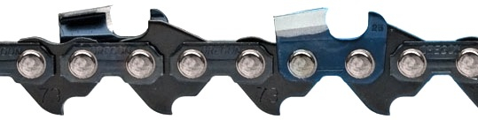

Perhaps we should define what we mean by "safety chain", as there are varying degrees.
There is the safety chain with the huge extra bumpers which often comes on saws sold by the big box stores. When someone says "safety chain", this is the first thing that comes to mind for me. (I absolutely hate this stuff. It cuts slow, and it doesn't bore cut worth a damn.)
Then there is the pro-grade chain which incorporates some safety features, such as the Oregon LPX series. They have a ramp on the driver link which come up next to, but separate from the depth gauge. The ramp reduces kickback energy, and some folks do refer it it as a safety chain, but this is not technically a "safety chain": Oregon still calls it a "yellow chain". I find the performance of this chain not all that different than their chain without these ramps. It cuts acceptably fast when properly sharpened, it bore cuts well, and it's a smooth cutting chain - not much vibration during cutting.

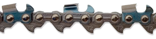

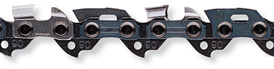

Then there is the Oregon LGX chain (and their EXL chain, which is Oregon's intended replacement for LGX). About the only kickback reduction feature is the fact that the depth gauge itself is ramped a bit. No one that I'm aware of refers to this a s a safety chain or a low-kickback chain. It cuts very well both bore cutting and regular cross cutting. It perhaps may not be quite as smooth in operation as the LGX style, but if there is a difference, I don't really notice it. (It might be more noticeable on older saws with less vibration dampening features?)
My only real complaint with some of the LPX and LGX series chains I've purchased is that in Oregon's eagerness to provide their claimed cuts well "out of the box" performance, they don't seem to follow their own chain sharpening guidelines. The chain often comes with far too much hook on the tooth. It does cut well right out of the box, which probably provides some "wow" factor to some users. However, it is simply not a durable geometry: that exaggerated hook with it's narrow point wears quickly. I've also found that sometimes their depth gauges are taller than their own spec. (Perhaps this is in an attempt to prevent that exaggerated hook from being too "grabby" or aggressive for unsuspecting users?) After a sharpen or two to bring it closer to the geometry that their sharpening instructions actually call for, the combination of cutting speed and durability suits me much better.

Thanks for the picts. I'd noticed that extra little ramp on the chain, but didn't really think about why it was there. The top one is definitely "safety" chain. A while back, went over to help neighbor clear some storm droppings and picked up their saw. It didn't cut worth a darn, and like you said, a big NO on the plunge cut. I went back and got my saw.

First picture is true ansi safety chain with the raised tie straps that block the cutter as it goes around the bar nose.
The second picture is not safety chain since the bumps don't block the cutter as the go around the nose. Their purpose is more to reduce chain vibration than anything else.
the last chain is true full chisel non safety chain. and the issue that you talk about with the hook is called X-grind. Makes it sharper out of the box, but could reduce durability. And is not achievable outside of the factory grind. Nobody makes files or grinding wheels to duplicate it. I won't argue about the depth gages since variation could be possible from then factory.
As noted in my description, Oregon does not consider their LPX series to be "safety chain". As you noted, the extra ramp next to the depth gauge does help reduce vibration. However, it does in fact also reduce kickback energy should the "kickback zone" at the tip of the bar come in contact with a log. ORegon specifically lists that "Bumper drive link" as a kickback reduction feature. From the description in their brochure on LPX chain: "• Ramped shape helps reduce kickback energies • Smooth cutting action"
If you imagine that chain bent around the radius at the tip of he bar, that ramp fills some of the gap between the teeth, pushing the chain a bit further out of the wood than it would be otherwise.
I remember reading something about X-grind a while ago, but Oregon's descriptions of the LPX and LGX chains do not mention it. IS that something that is associated with their newer EXL chain?
BTW, the extra hook I was speaking of is not shown in the photos. It can be duplicated by just sinking the round file a little too deep when sharpening.
