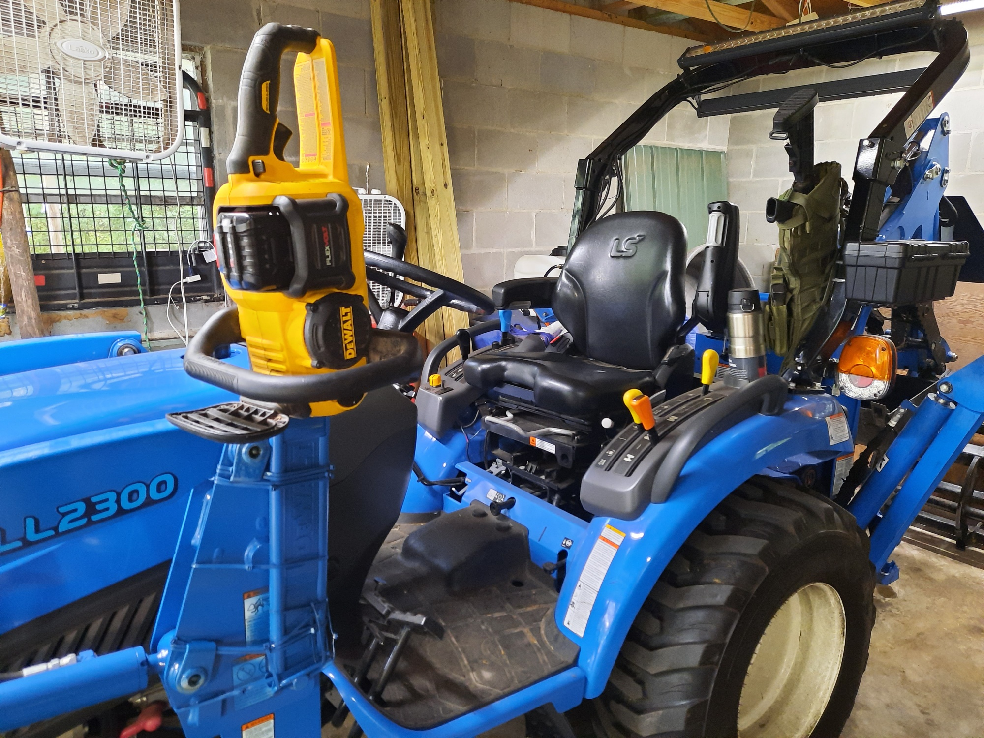

I just got a Dewalt 60 volt 16" chain saw and this works great! I have been cutting trees from 26" up to 36" with no problem and most of my trees are white & water oaks.
It will run a few hours on the battery glade I got a few more but after marker ones.

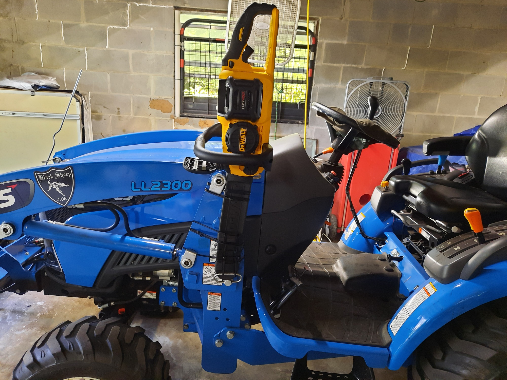

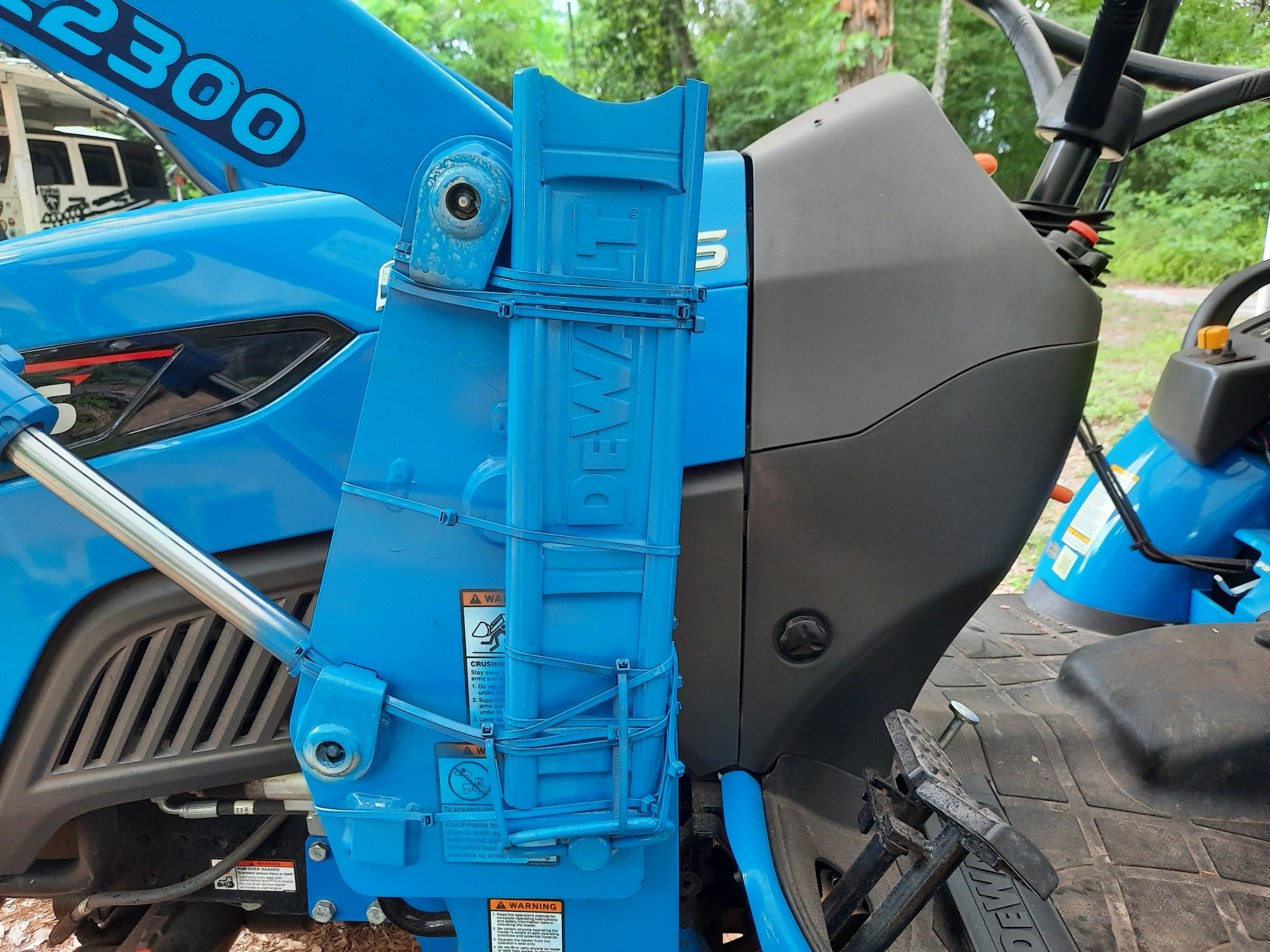

To mount it to my tractor all I did is tape the blade protector to the FEL arm than used some 125 lbs cable ties them removed the tape. The blade protector is made from some heavy duty plastic.
My land is not flat so it stayed in place for over 2 days now so I am happy with the mount and it did not cost me anything but a few bucks in cable ties. The saw is about 10 lbs with out the battery.

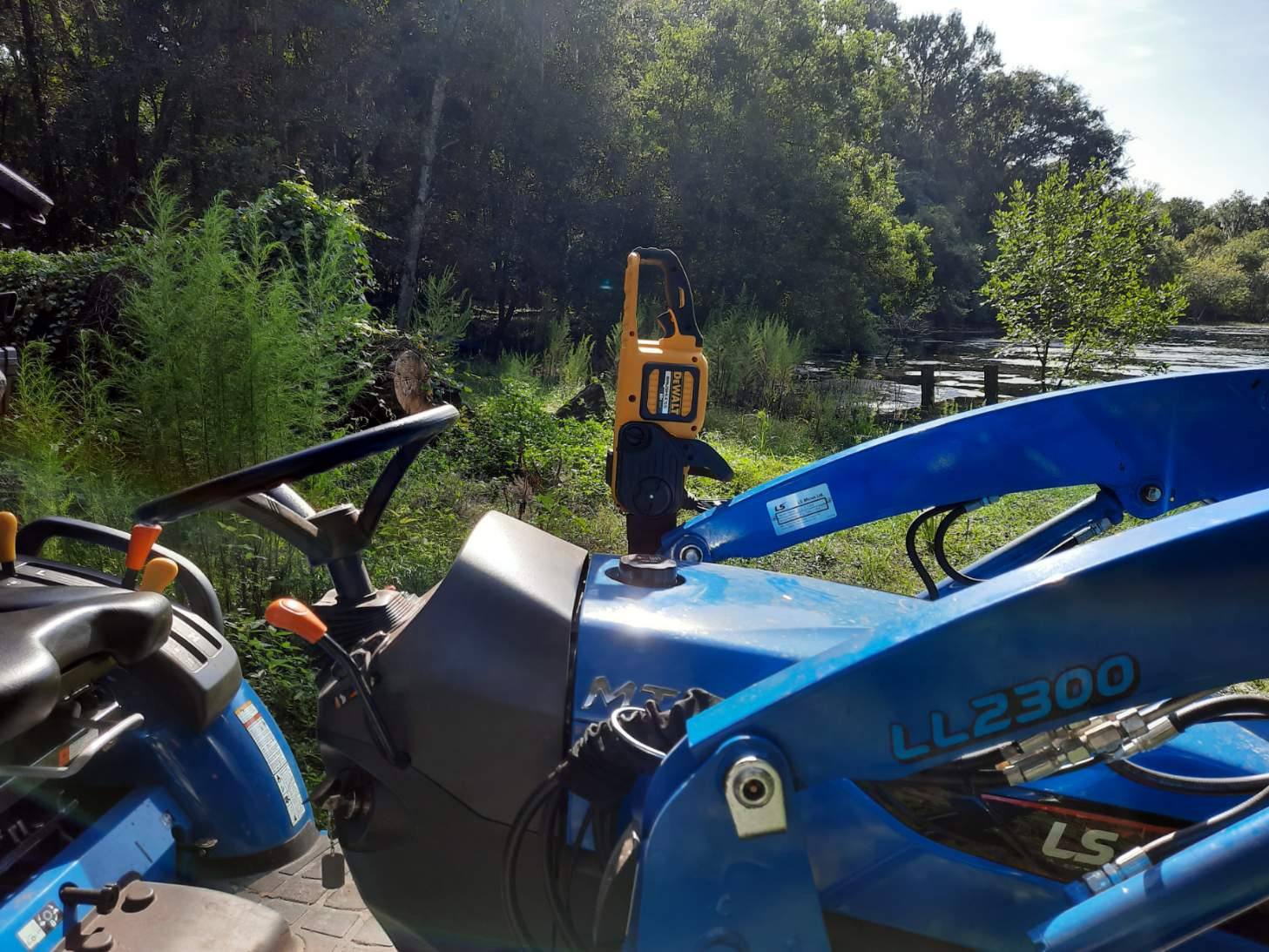

I like the idea and I have the same DeWalt 60v Max saw. I would love to mount it to my F-3680 roll bar, but I would be concerned the weight of the saws power head (especially with battery) might damage the bolts/bolt holes where it connects to the cutter bar while it bounces around.
Im interested in trying your method. Have you found the saw head flail-around on bumps?
/ Chain Saw Mount
It has been on for about 2 weeks now and is holding strong if flexes a little when I hit the big ruts but 0 problems and my saw still cuts straight.

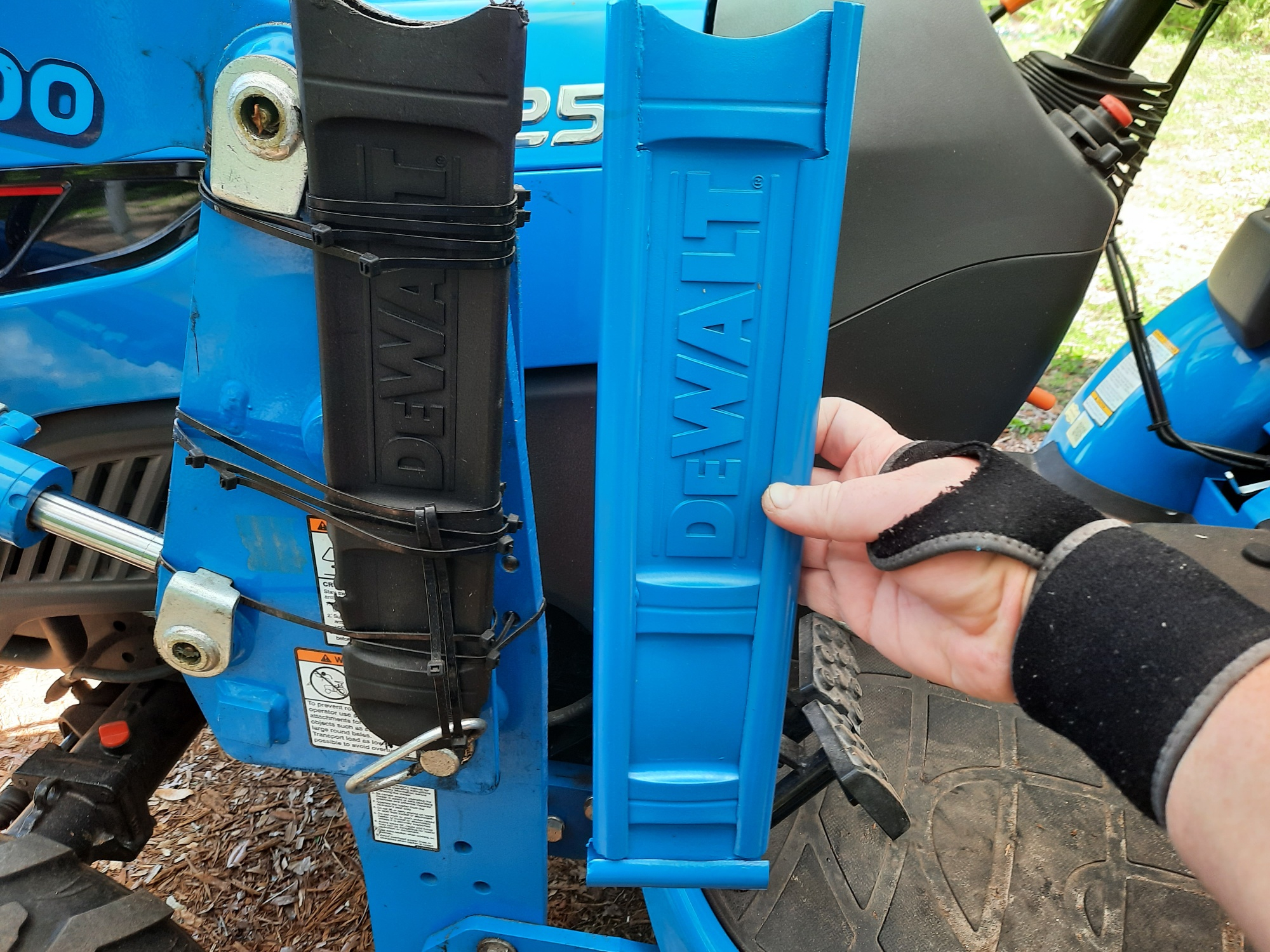

So my chain saw mount I just notice the chain was starting to rip though the edge so after 9 months I thought that was a good run.
Upgrade time! I took quarter " PVC cut it to fit the sides so it was a super tight fit. I put RTV on the sides and snapped the PVC on. Now there is 0 flex.
Next did the same on the bottom & drilled to small holes in the bottom sides just in case for drainage.
Than painted and mounted it up it should last years now.
Old next to new.
Now mounted.
