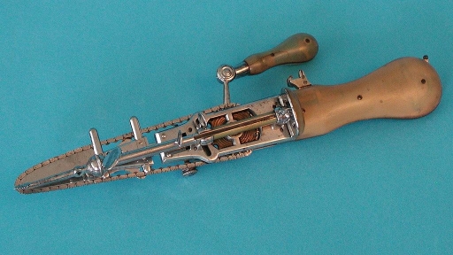

Chain saws weren't introduced for wood but as a medical instrument - bone saw.
First I've heard of that, but I have heard a story that the guy who invented the tooth shape for chain saws was inspired by the mouth of a wood beetle that he saw while logging.
