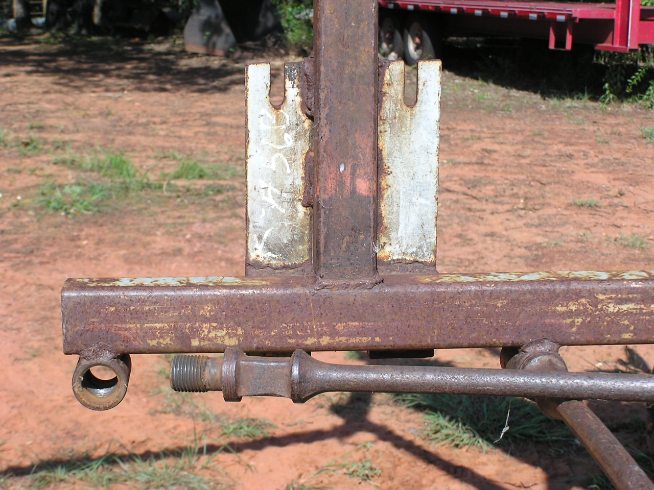

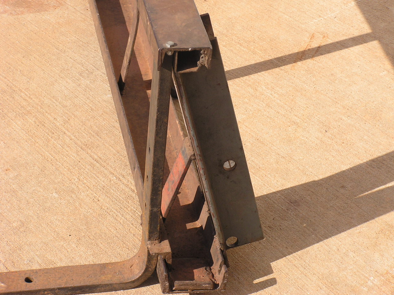

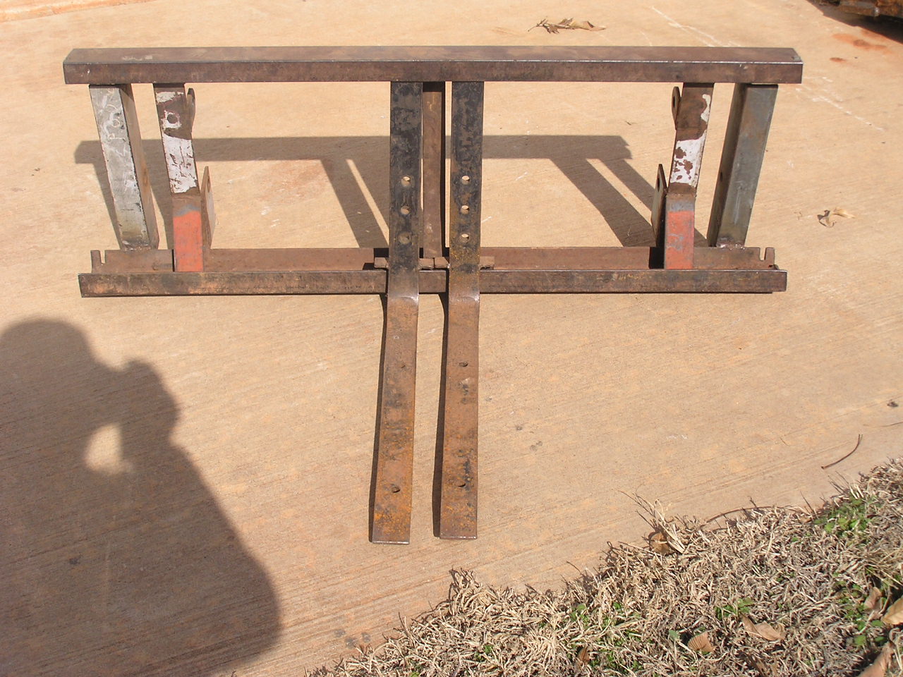

I put chain slots in the bottom channel iron of this fork frame that was used on three different loaders over the years.
Note the shadow of the slot.

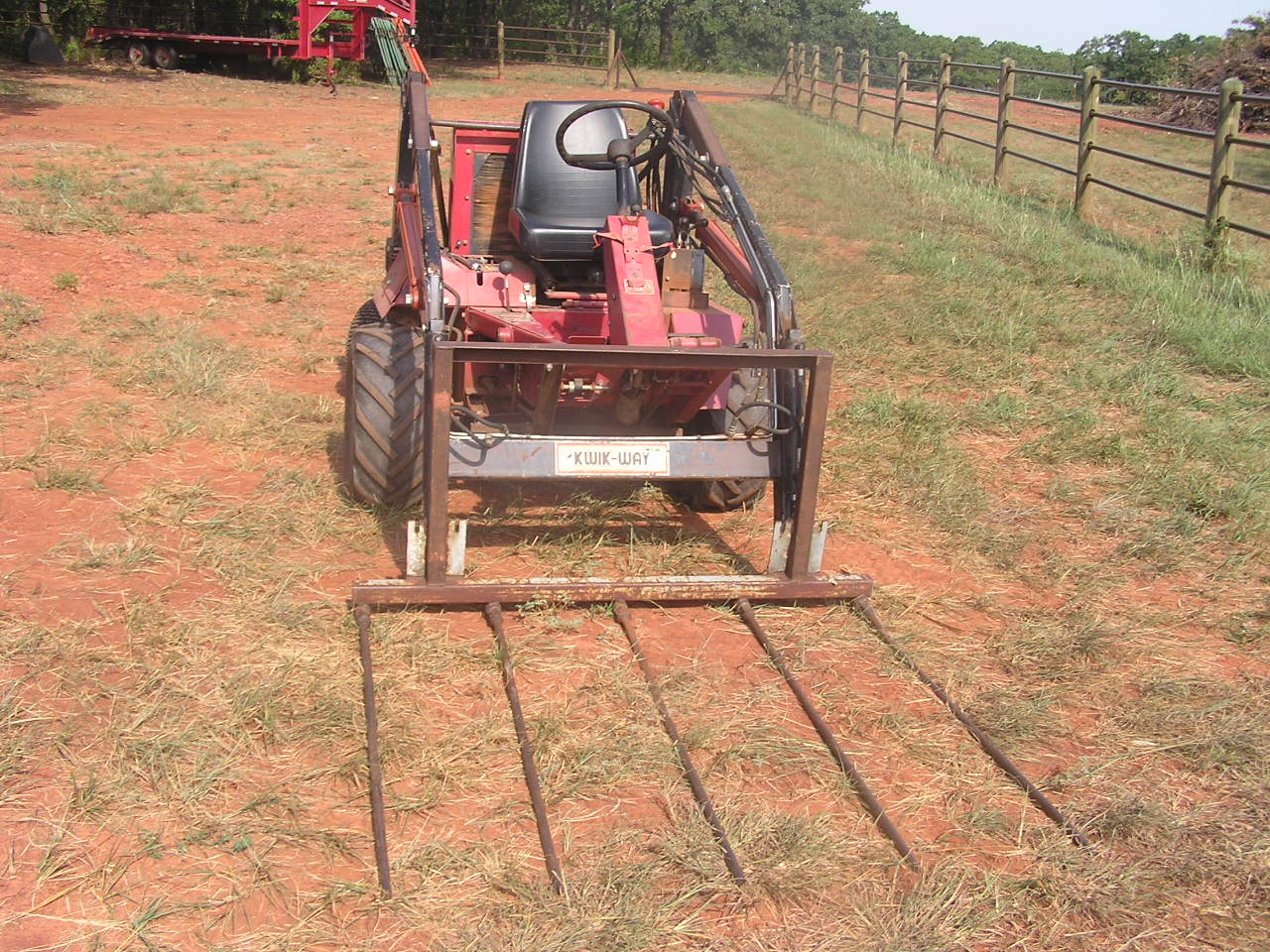

And two slots on each side on the brush fork. :thumbsup:
