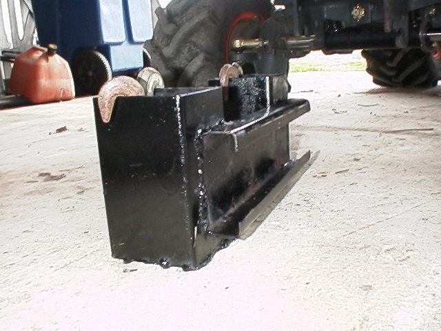

After trying to find a spot where I could mount some chain boxes on my BX220 I decided to put them on the front bumper I had made last summer, I used 4 inch square tubing mounted on 4 inch purling (both Left over from when they built my RV barn and used expanded metal to let the mud and water run out. they are 7" long and are 11 inches above the ground. Picture 1 is the bumper I made

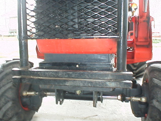

ANother try for the buckets mounted on the bumper

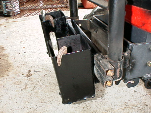

And a front view with chain in them. The best thing about this mounting is that you can remove them if you don't need the chain.
Thanks again Jim for the very handy idea, I will keep my eye on you for your next great idea
Jim C

Oops that was a side view, here is the last one, the real front view
jimc
