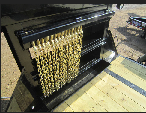

I used a chain rack I built similar to the one in the pic., except they hung on the inside of the neck facing back of truck, rest of the chain was in tray at bottom of neck. had a fold over piece of metal that I could pad lock. That worked until I was in Houston one night, out of hours and got a room. Next morning chains/binders gone. I bought a 48" under bed tool box, mounted in trailer in front of the front axle. Inside the box about 3/4 way up I welded flatbar the length of the box. Thats what I hung my hooks on, rest of chain laid in bottom of box. Binders same way with 1 hook hanging on flatbar at other end of box. Trick is to pull last chain put in, gets pulled out first, no tangled mess that way. Chains/binders out of site out of mind was my theory. No pics of the box, but it worked good.

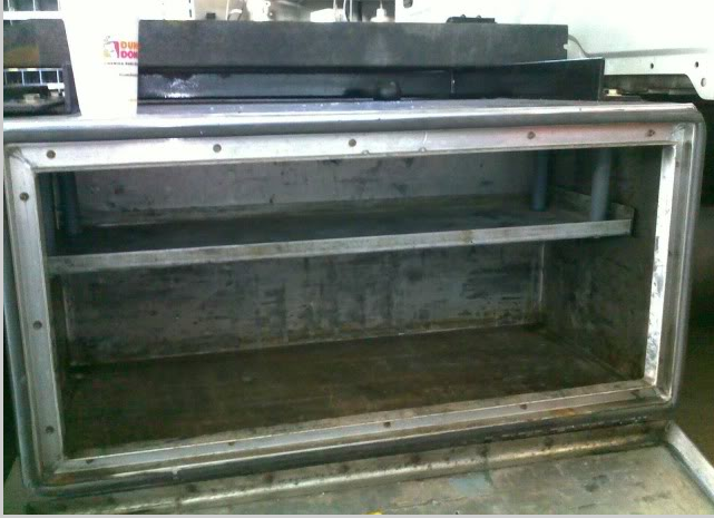

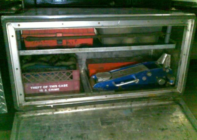

This is the closest pic i can find as to what I did on my box. Sold my 40' trailer about a year ago so I cant get pics of it. This one has a tray, mine I just welded flatbar to hang the hooks of chain and I did 1 hook of the binders.
This is the style I had built in the neck and had it pad locked when everything was stolen. They were able to pry hard enough to bust the lock.
http://loadcovering.com/lockablechainracks.htm

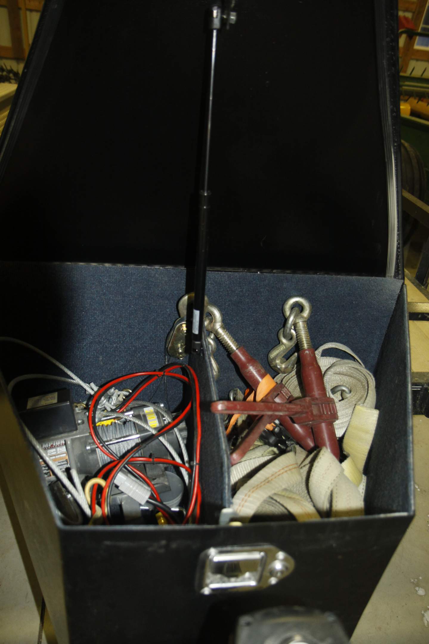

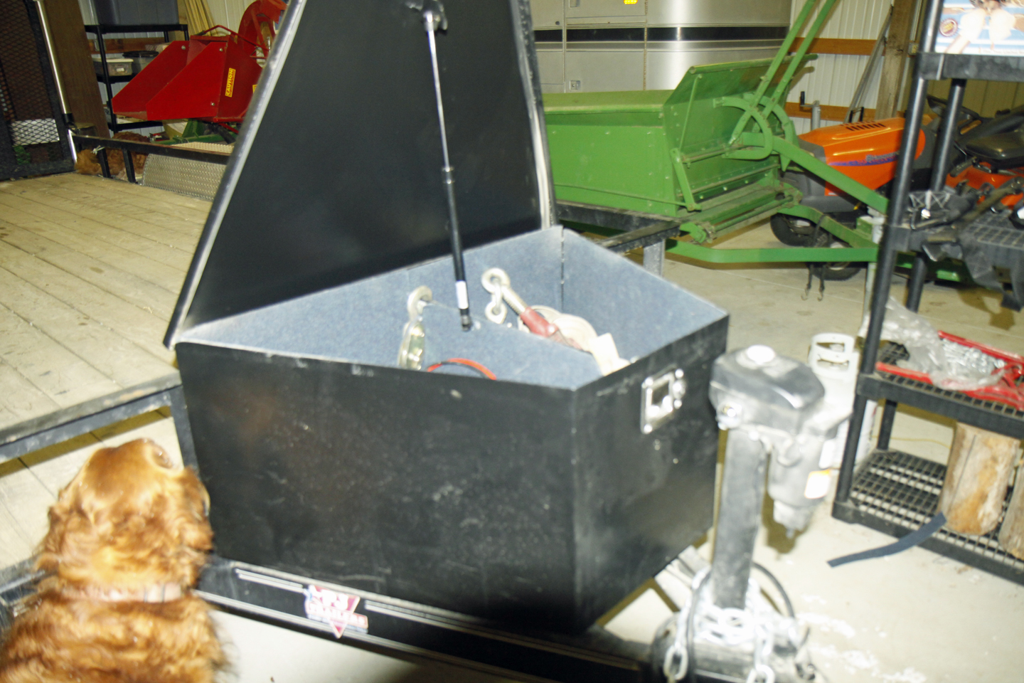

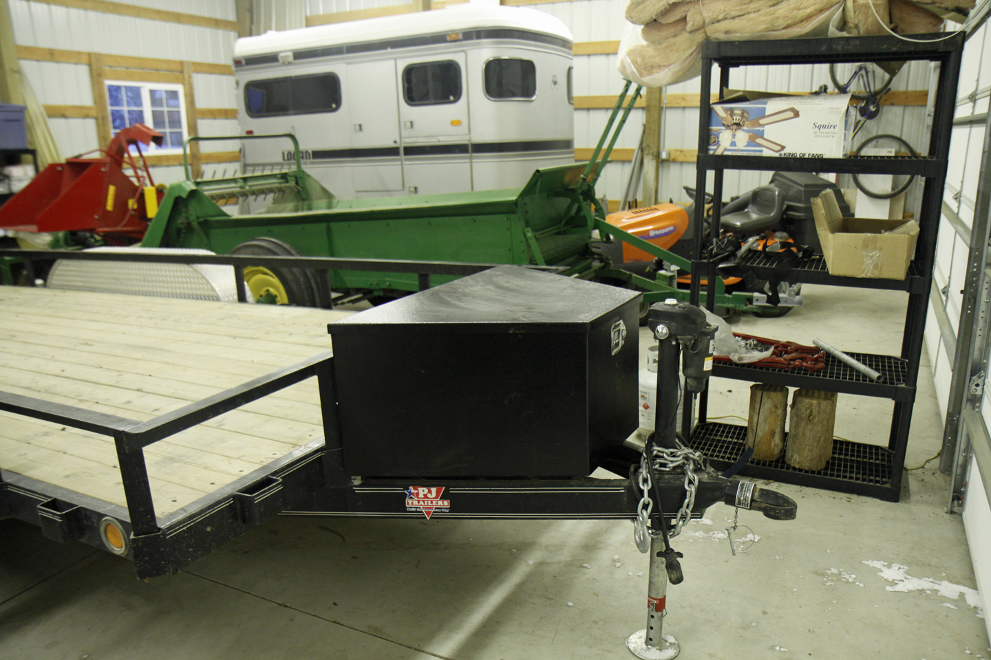

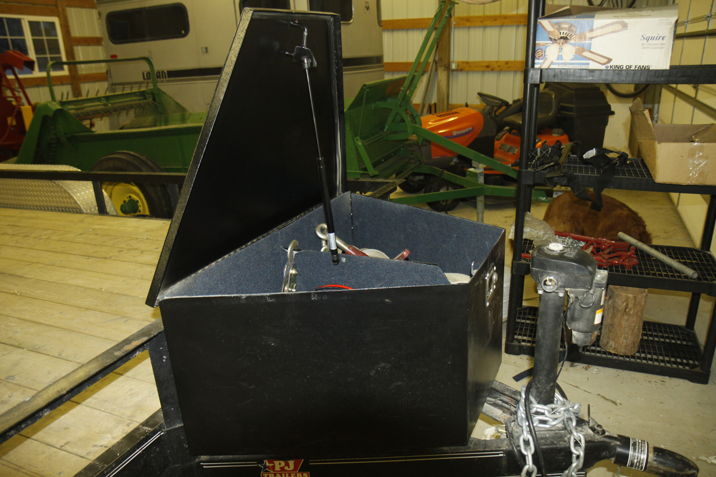

i built myself a storage box for my 16' trailer. Made it out of 16g metal. holds everything i need, and is locking. Here are a few picstrailer 1.jpgtrailer 2.jpgtrailer 3.jpgtrailer 4.jpgtrailer 5.jpg

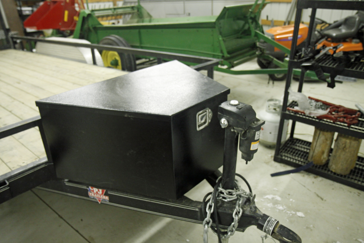

Mine came with a locking toolbox where I keep all of my tie down stuff.

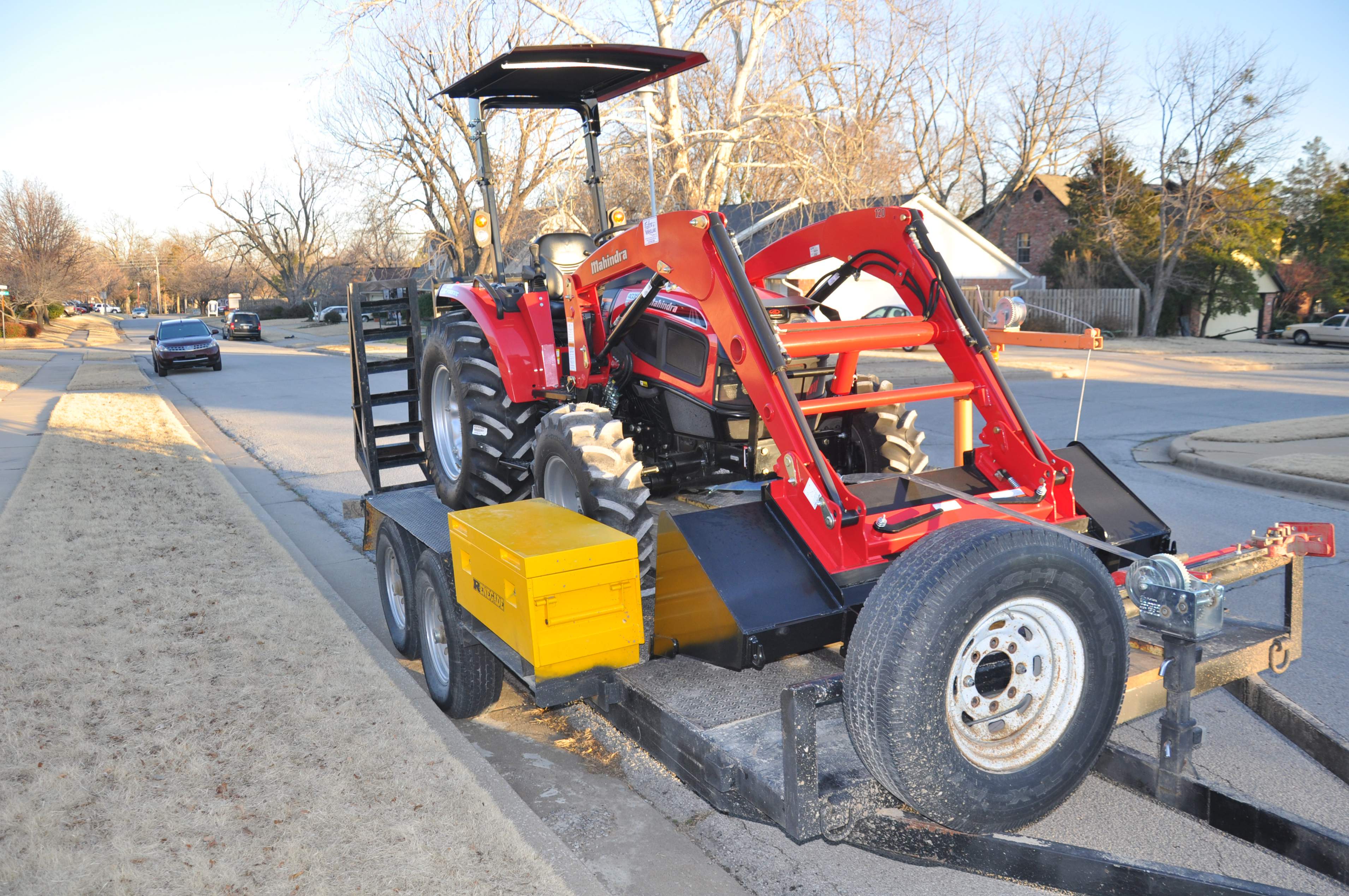

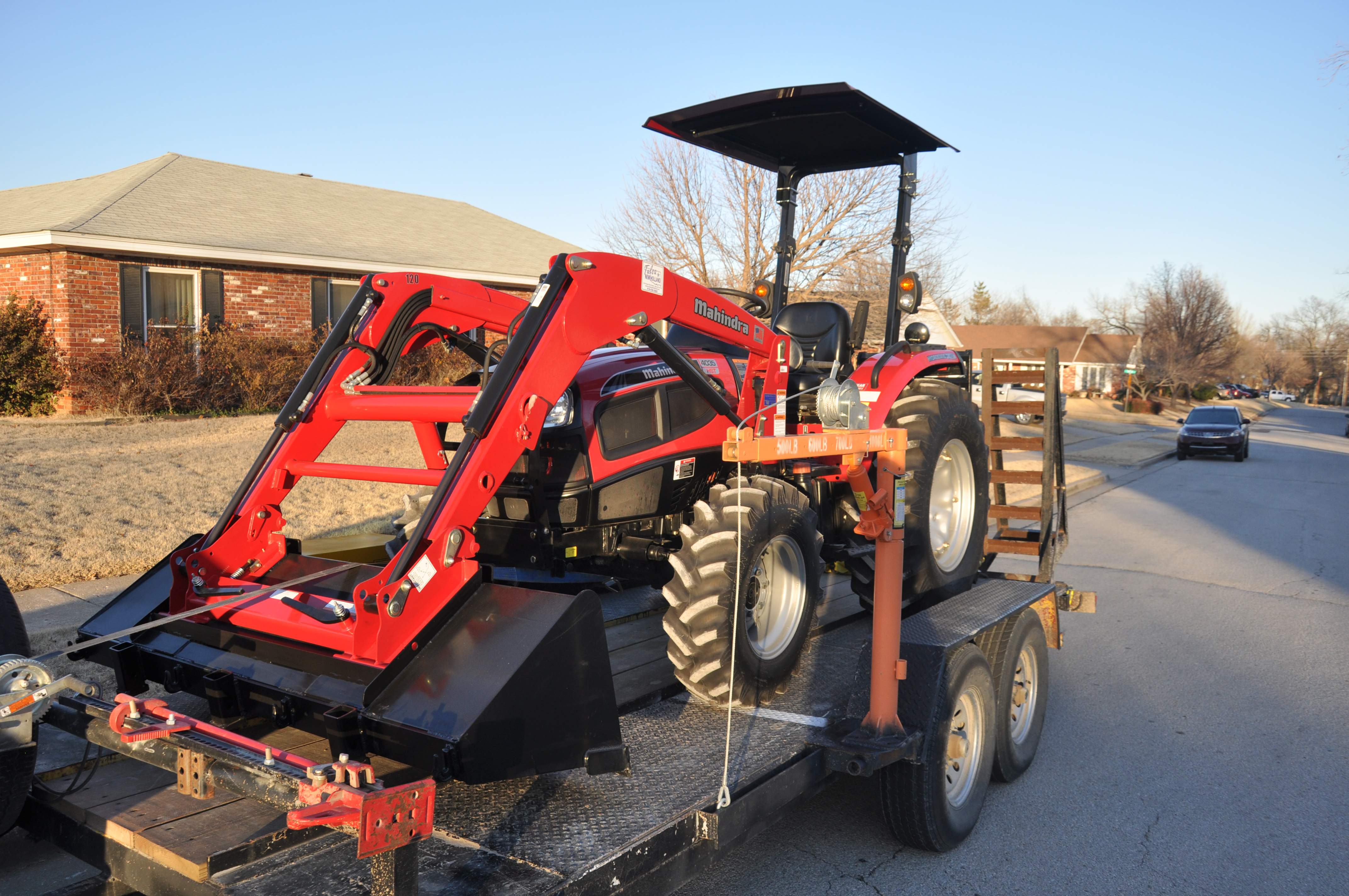

We expanded the width of the deck out to the width of the fender and welded on a box for straps, chains, boomers, jacks, etc. The photo of the other side of the trailer where the crane is mounted better depicts how the deck was expanded. It also shows an attachment point on the front of the extra deck for a trailer jack or drop leg in order to stabilize the trailer when lifting with the crane. I think that was overkill on my part. The trailer has 7,500 pound axles and so far I have not lifted anything heavier than a box blade with the crane and the trailer did not budge even without the stabilizing jack.
