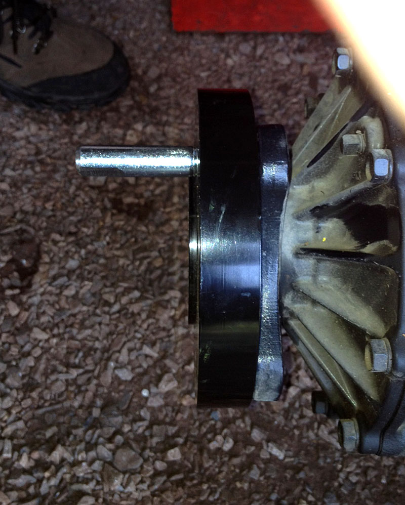

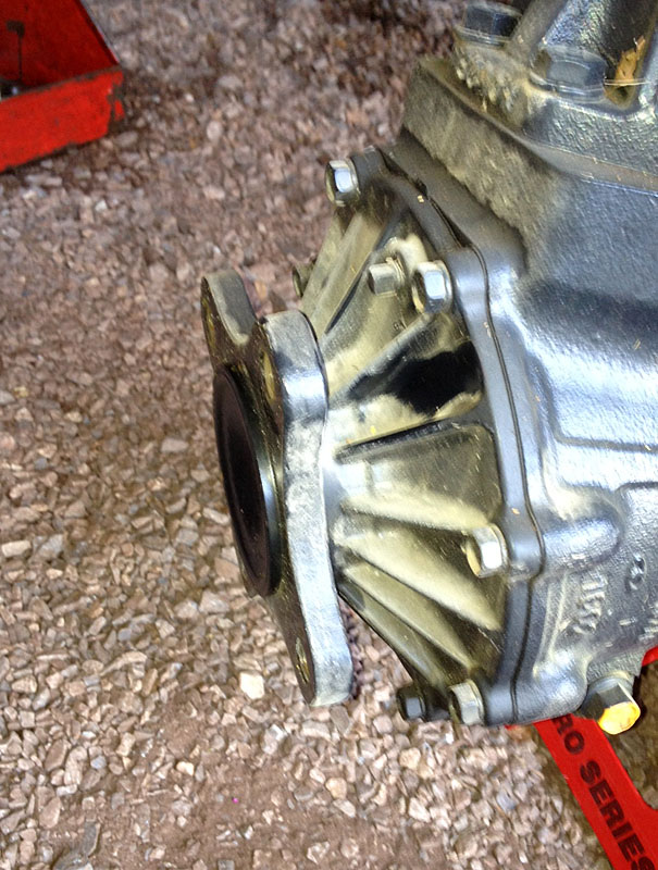

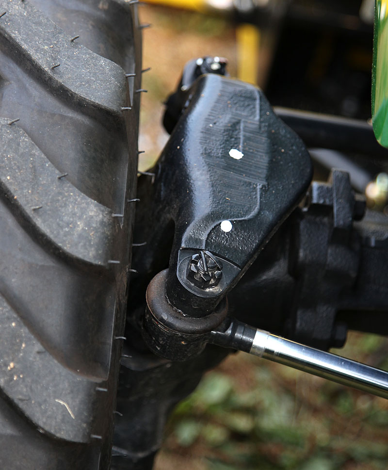

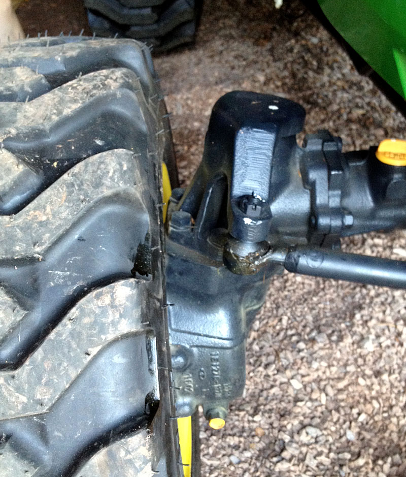

The Yanmar SX3100 is pretty much the same tractor as the JD 2720 / 2032R. The clearance on the front steering linkage is very tight. JD sells front wheel spacers specifically for the purpose of creating more clearance for front tire chains. I doubt they would offer chain-specific spacers if they didn't want you putting chain on the front tires.
I've had the spacers on my 2720 since new and use chains on all four wheels every winter.
Below are some photos which show the spacers along with before and after clearance.
