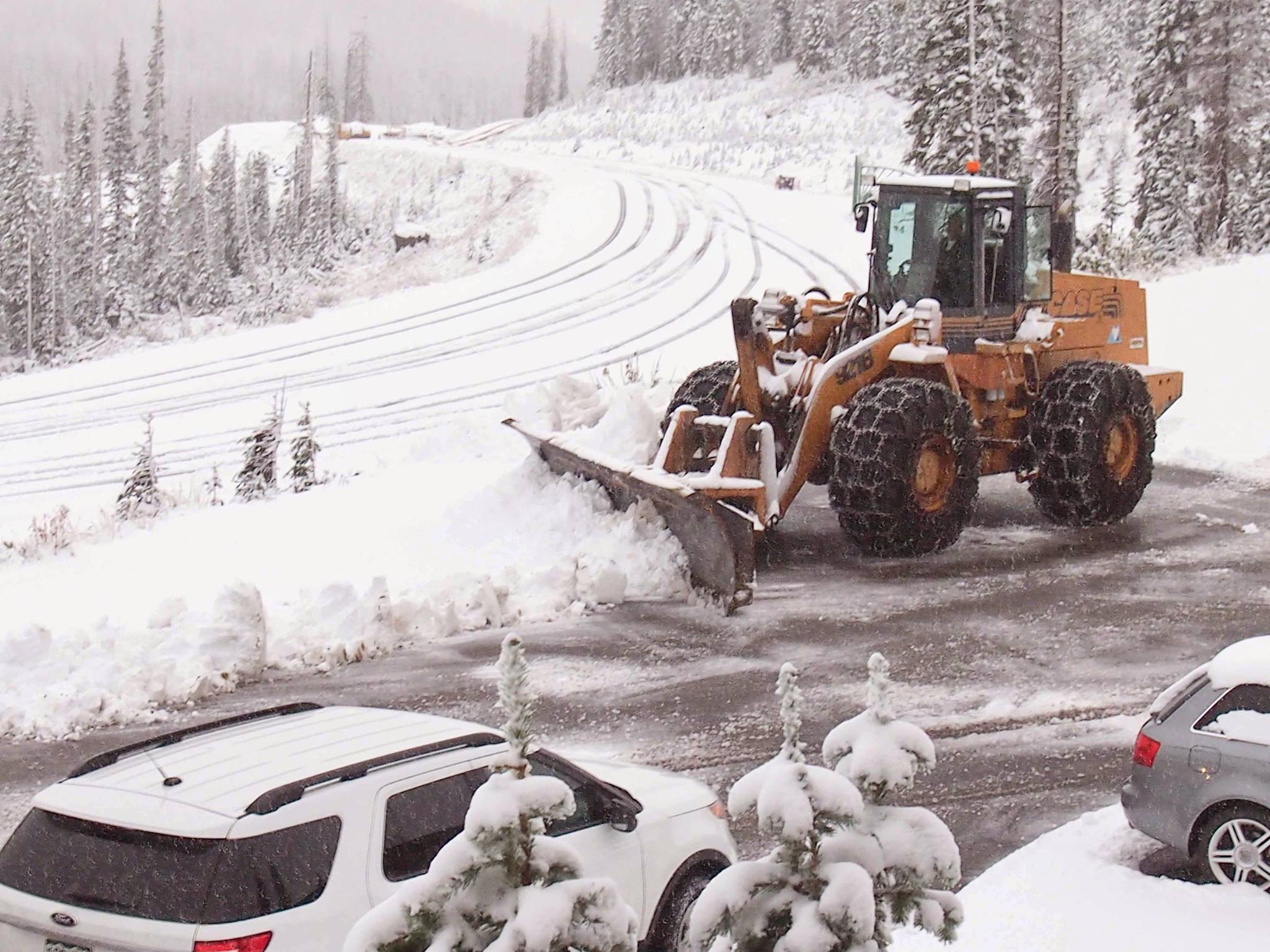

To my thinking, if you feel you need chains on the front wheels too, your tractor is too small for the job you want it to do and should be using a bigger tractor. :confused3:
So this guy at Wolf Creek (Colorado) should size up to what?

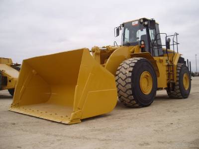

I was referring to the need for chains on the front wheels of SCUTs and CUTs, not industrial machines. But I think you knew that. If not you should have. That's what the thread was about. :rolleyes:
/ Chains #46
It was a joke, Peter's was better but his Cat needs some chains!
