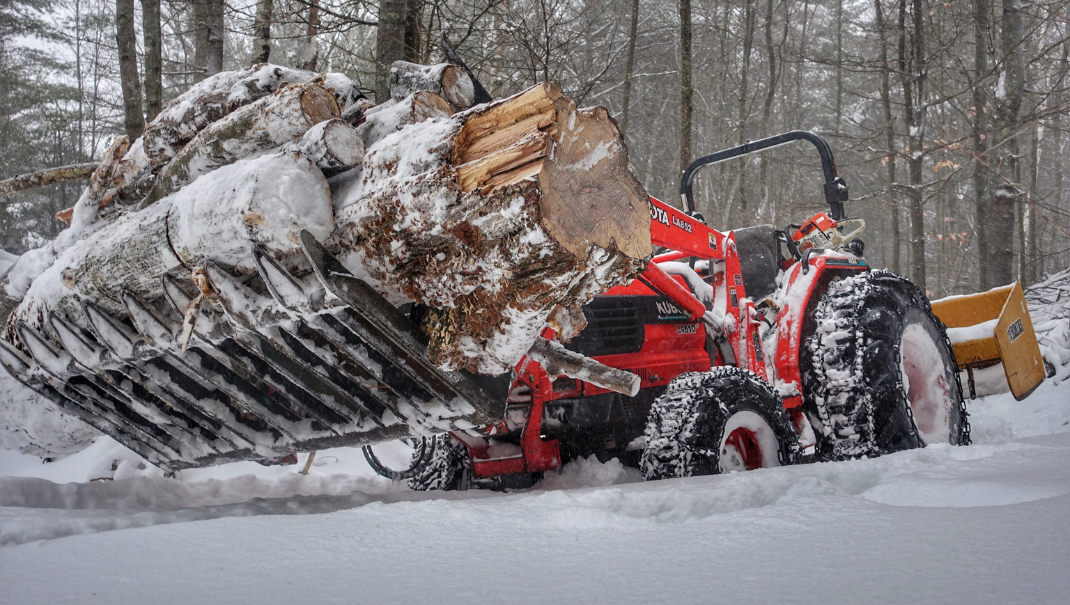

Chains aren't optional here most winters. Use chains on your equipment or stay home. On the Kubota I use the net style on the front, Duo's on rear. No pavement. 1522245166087.jpg

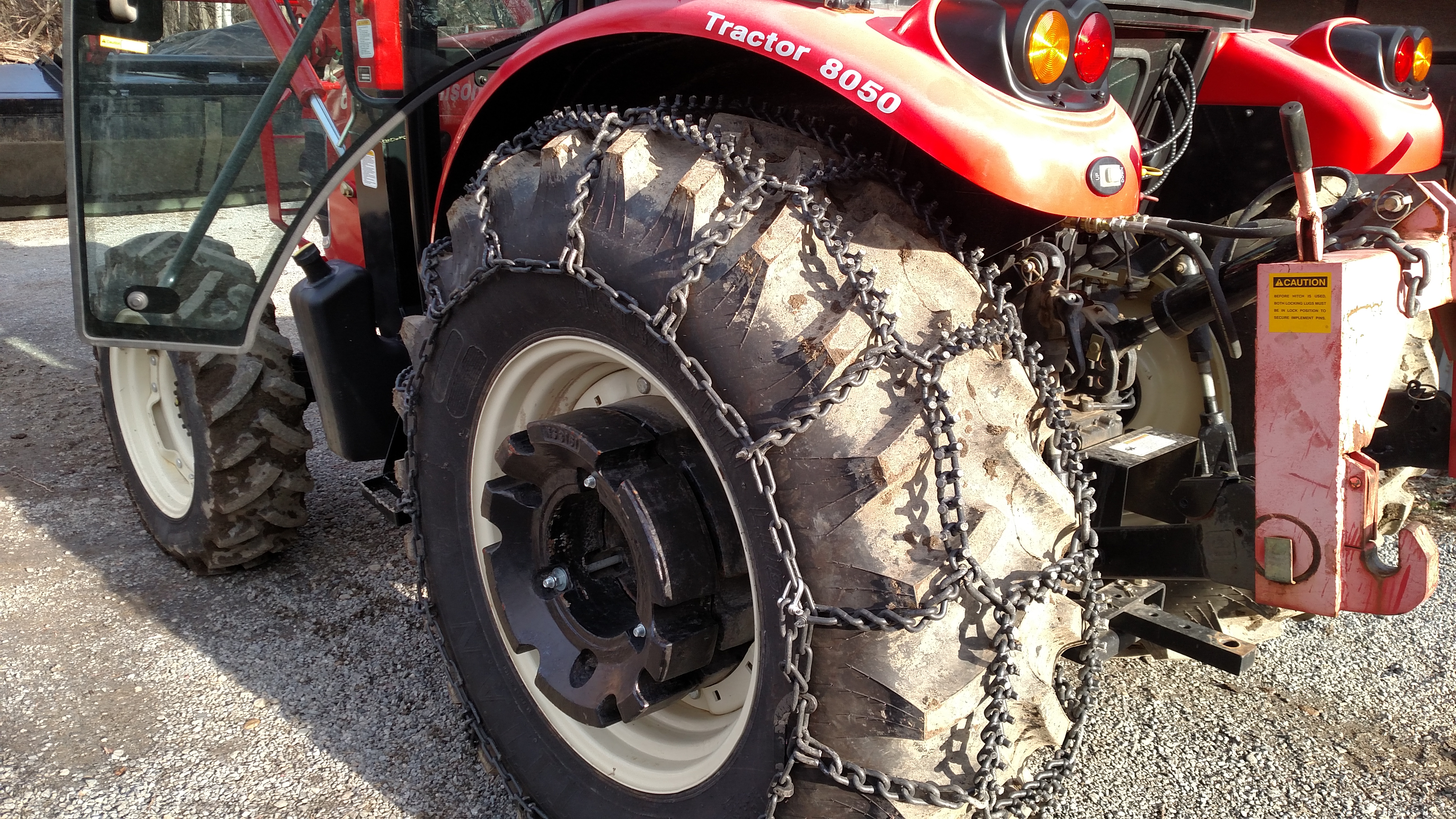

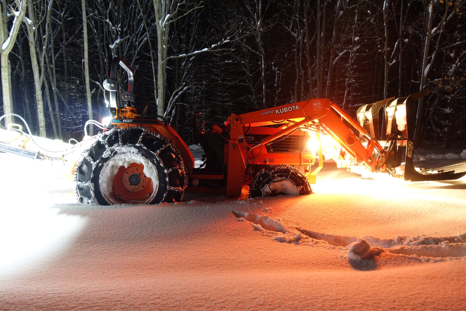

Since we are getting more and more strange winter : extreme cold then melting down! Our gravel/crush stone driveway is more like a toboggan extreme slide! Since the very beginning I have installed chains on front and rear tire.
For front tire (light chain with studs):
TRYGG FAST TRAC W/SQUARE STUDS
TRYGG Kjetting
For rear tire 3/8 Aquiline Talon
11.2-24 AquilineTalon Tractor – Tire Chains by TireChainsRequired.com
A blessing for today whether!
Philmedsmall.jpgAQ_Talon_Tractor_AST_c27a8_1024x1024.pngsouffleur martin action.jpg

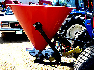

in conjunction with tire chain, I had to buy another attachment for keeping up with our new crazy weather: crush stone gravel anti-slip device!
I now stock about 30 bags of crush anti-slip stone (40 lbs each). I have an average of 3 to 5 severe episode of icing of our driveway ¼ mile. So far a good solution!
