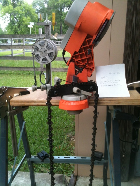

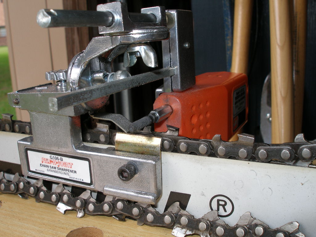

I "lower" my rakers using one of these sharpeners. Pretty inexpensive too.
I lower them a little more than most people do. Depends on the power of the saw you have.
