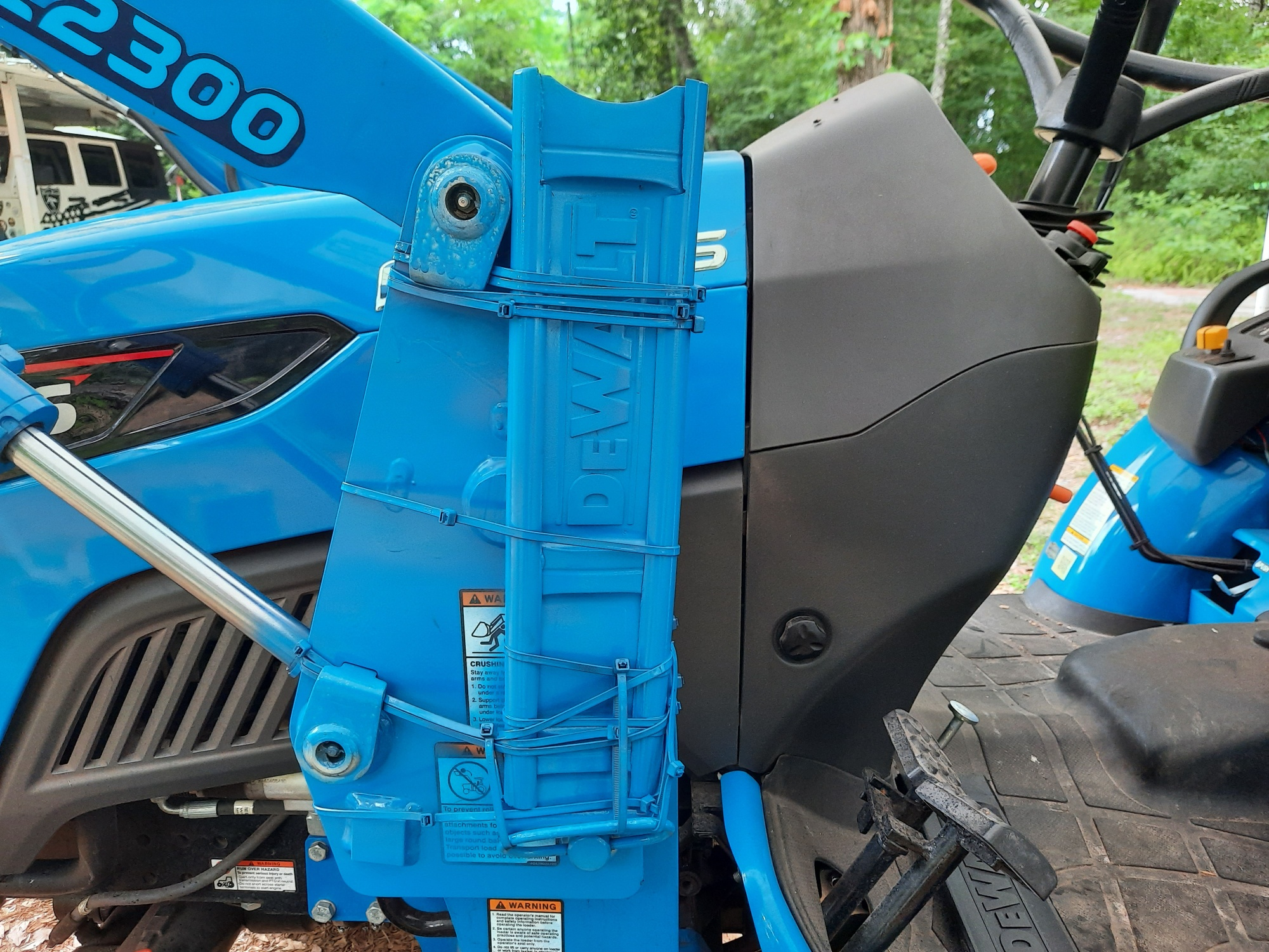

This is what I did with cable ties & reinforced the sides and bottom with PVC than RTV them on.

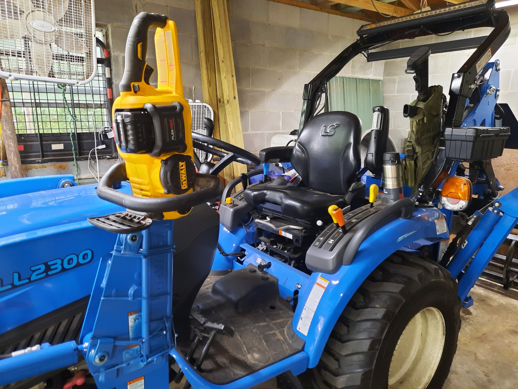

This works for me.

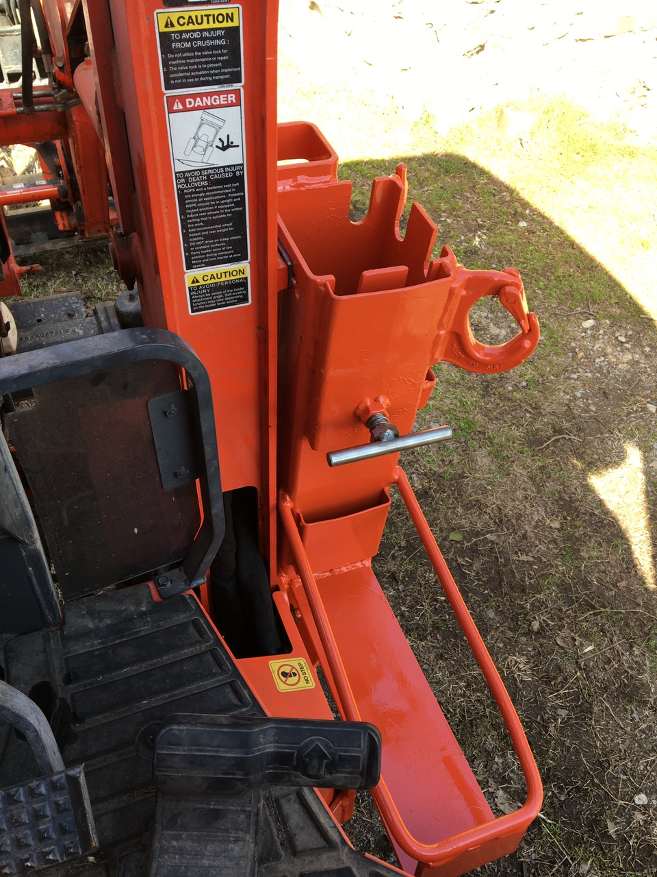

You may or may not be aware of this, but the SawHaul kits actually come in a larger size for larger tractors. If you look at them on Amazon, the only option is the one standard size (too small). The larger size can be found at the link below. It basically comes with a larger u-bolt to clamp the larger loader arms.
SawHaul Complete Kit for Tractors
I bought the large kit, then decided I didn't like where it sat on the loader frame with u-bolt kit. I ended up drilling two small holes in my loader frame and mounting the scabbard using two 1/4" grade 8 bolts. If you chose to go this route, you'd just need to buy the base kit with your scabbard length of choice. I really like mine.

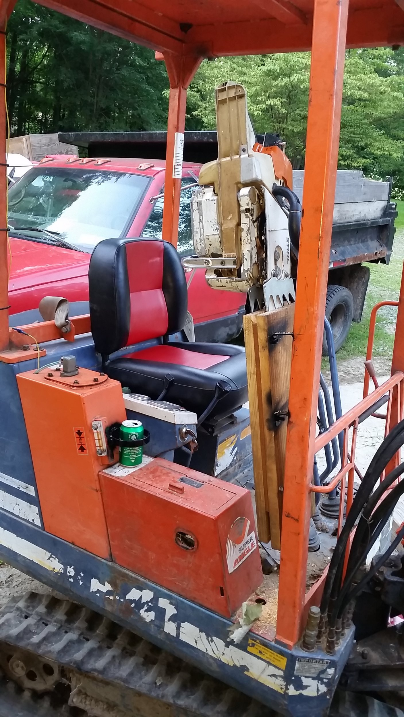

I made two of them from wood with a metal frame to attach it to the equipment. Pic is on a mini ex. Theres hardly room for a 6' tall person much less a 72cc saw with a 28in bar. It dosnt stick out of the rops and isnt in the way.

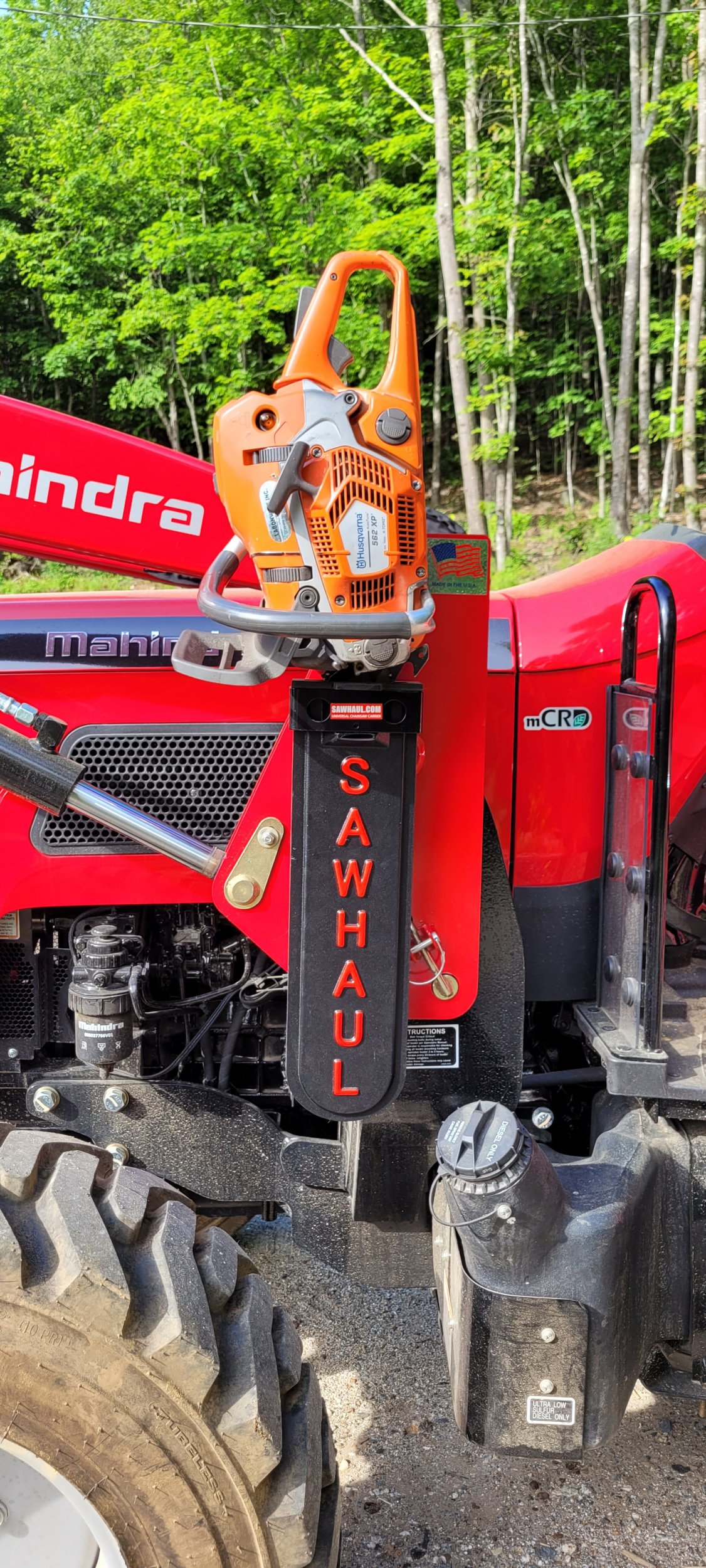

I used a Saw Haul brand on my MX5400 with no modification. As I recall there was a version on the SawHaul site that was a perfect fit. It's a great piece of kit by the way.

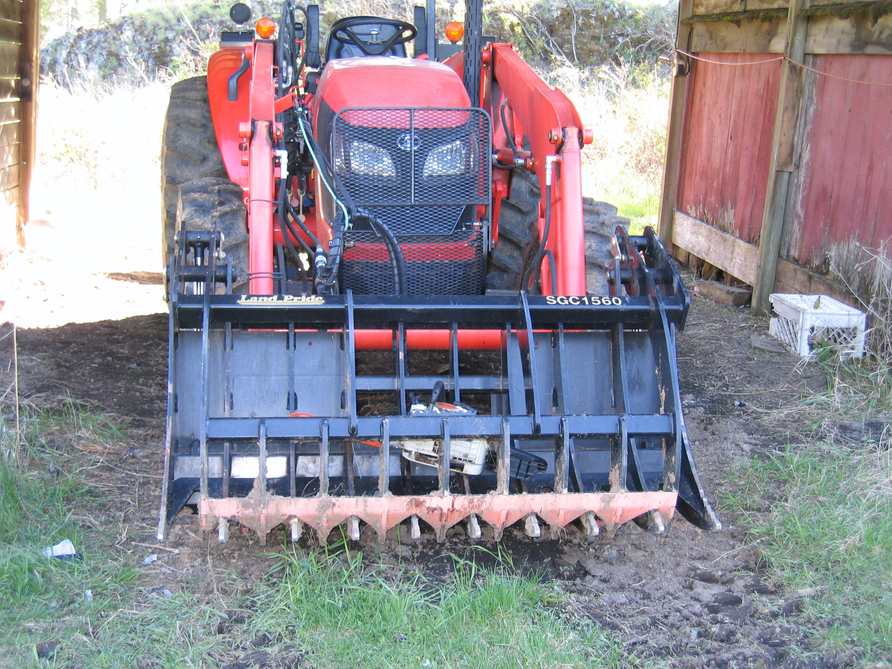

Either bucket or grapple. 40+ years without a problem. Recognize - I only carry a chain saw when I'm going out to do a job. It's not there all the time.
This is the way I carry most all my tools when going out on the property to do a job.

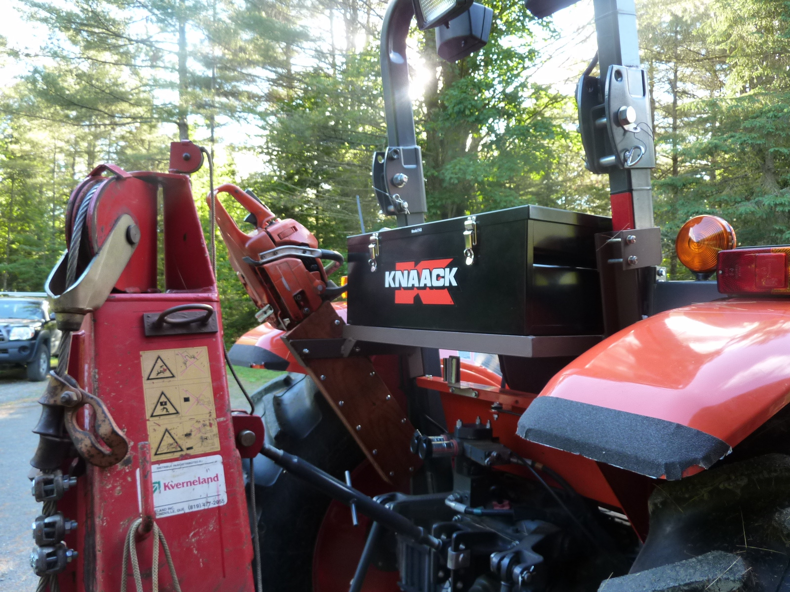

Wow. I even seen a setup that looks worse than mine in this thread! Mine holds two chainsaws. I just used the chainsaw to bore a slot into a treated wood piece. Two of them one on each side of the loader arm.
/ Chainsaw scabbard #18

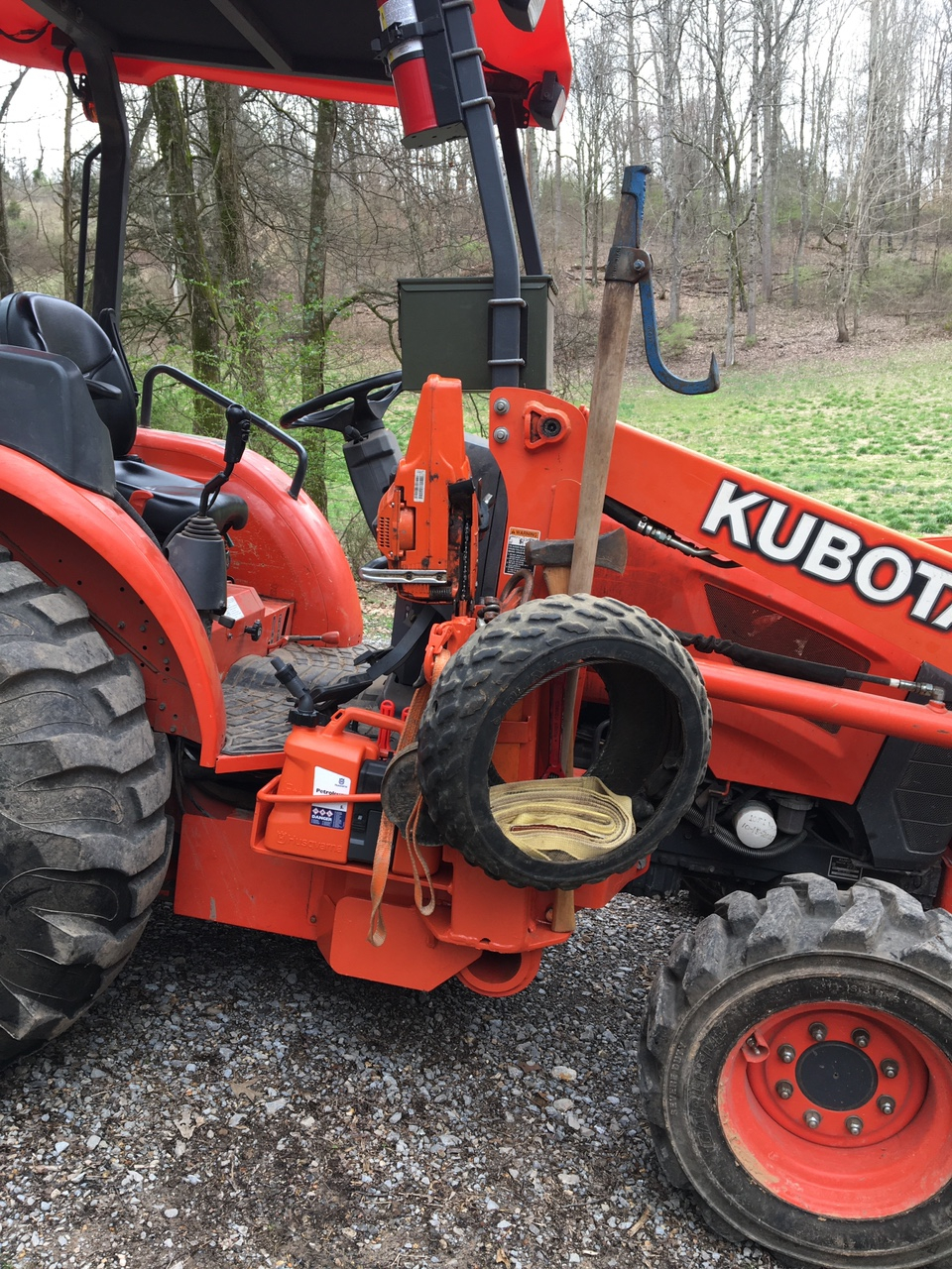

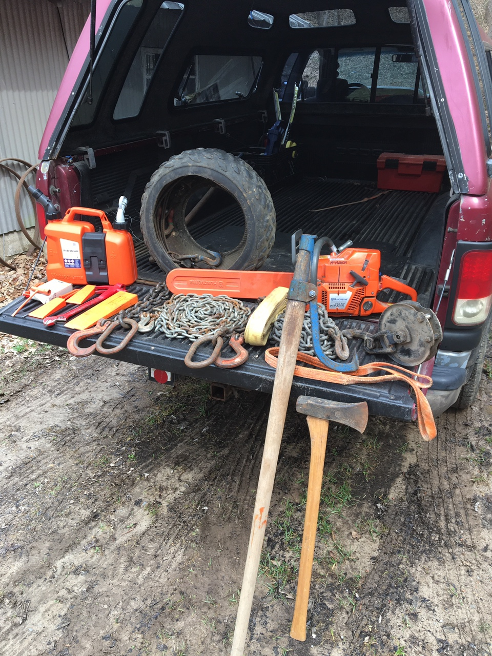

Kubota M5640 - Plywood scabbard and go-to saw behind the loader post on one side.
Gas and oil under the loader valves on the other side.
Second longer saw and tool box in the back.
