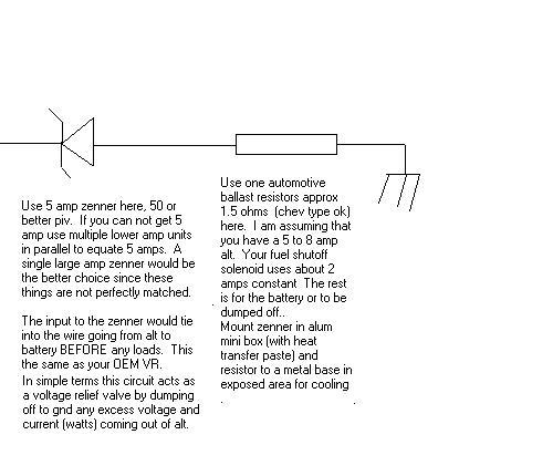

Soundguy & Greg, for what it's worth, most likely not much, here is my idea for cheapo voltage limiter circuit.
The ballast reisistor shown can be found almost anywhere for a few bucks. The hi amp zenner, however, may take some work. Low amp zenner units in parallel will also work here.
A 12 volt regulator would not work at all since battery voltage, with engine running, is almost always above the standard 12.6 volts. The 15 volt unit, though a bit high, should fly.
Don't confuse battery surface charge voltage with true battery voltage when checking batteries.
This is my first attempt to put a schematic on the net, I hope it works.

   / Charging problem #119
Keoke,
Thanks for the drawing. So far, I have found 15volt zener diodes in 1, 5, and 50 watts. Nothing is rated in Amps. What do I need in terms of watts. I assume that the ballast resistor is a coil of ni-chrome wire wrapped on ceramic of some sort?

   / Charging problem #120
Wow! What a thread...
Comments (from an electrical engineer):
-Putting 78xx and 79xx VRs in parallel is a bad idea. I am fairly certain that they will suffer from secondary breakdown without proper current balancing circuitry, however, it will work because of they are thermally protected. They will probably turn on and off like Xmas tree lights, and they will take turns running very hot. Even though they are rated for permanent shorting, it is best to derate the specs of components in circuit designs to prevent failure from long term heat damage.
-There is no feedback to the alternator on the few tractors I have seen.
-The zener diode idea is technically correct, but it requires a rather large and expensive zener diode to dissipate that much heat, so it is not the most practical design.
-The relay idea might work with sufficient filtering, but relays are generally slow for regulation response (which stresses other components in the system) and the rapid duty cycle to reach a steady state combined with tractor vibration and a high switching current on the contacts would likely cause the relay to eventually fail.
-The output from the full bridge rectifier is a DC signal at twice the frequency of the original AC signal. The ground reference (that makes it a DC signal) is relative only to the tractor chassis. You could use any any reference for anaylsis, and the frequency component of the signal will be present.
-The wires in the 1110D schematic are not correctly connected to the full bridge rectifier. The Y wire should connect from the VR to point R on the rectifier. The R wire should connect from the VR to the + side of the battery. For the 186D, there is also a wire for the battery voltage feedback from the keyswitch to the VR and a lamp indicator wire output from the VR.
I looked in my service manual for the 186D, and it the VR is a fairly complicated gadget. The VR is really a current limiter (as specified in the manual), and simply uses a zener diode as a reference voltage (to compare to the battery voltage) which is then used to bias a transistor (current switch) and reisistive load pair. The pair reach a steady state of shunting excess power and charging the battery based on the battery voltage. This is a more cost effective and elegant approach then the above mentioned zener circuit. Now for the complicated part. The VR actually has seven modes of operation (2 for starting, 2 for charging, 2 for no battery, and one that I forgot), and this includes additional circuitry to protect the alternator, battery, and the VR for reverse polarity.
Long story short, it would be an interesting project to build a VR, but probably not cost effective if you include the protection circuitry, additional modes of operation, and packaging. I am certain there are lots of alternate VRs available that would work great and cost less (like the Datsun one!), the trick is to find the information to cross reference and/or check the circuitry compatiability.
Or you could keep it simple with a with a zener diode, transistor, load resistor, and heat sink...
