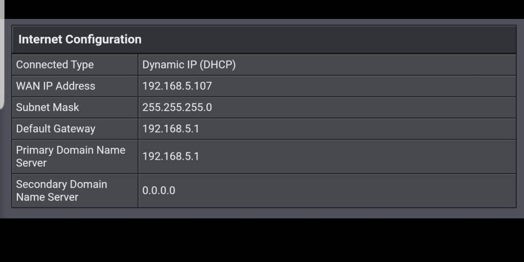

Now the problem I have is I can't get the router to work with this Netgear. First off I had the trendnet set to WISP mode and realizing that's not correct I switch to a router mode and the DCHP I left with the Netgear and turned off in the trendnet. The trendnet is is seeing the Netgear and shows the internet connection with the Netgear IP number. I cannot get to the internet through the trendnet I'm not sure what the problem is there I've got to do more head-scratching.

Cheap $20 a month Stand Alone Unlimited Rural Internet through AT&T Wireless
Let your netgear be your home network, and hook up router as an access point for wireless.
Wisp is not correct.

The DHCP addresses in the Netgear Modem start with 192.168.5.20 through 99 by default with the gateway being .1. My Netgear Router DHCP starts with 192.168.1.2 with the gatewat being .1. I have the DHCP turned on both by default and it works fine. My Netgear router is pulling IP address 192.168.5.69 from the Modem. You will need DHCP turned on in the modem or put it in bridge mode.

DHCP is on in the Netgear, it is not on the trend net. I did change the number assignment to 192.168.5.101 thru 199. Here is a snapshot of the trend net Internet configuration... And it has the netgear as the gateway. SmartSelect_20200313-192347_Messenger.jpg

DHCP is on in the Netgear, it is not on the trend net. I did change the number assignment to 192.168.5.101 thru 199. Here is a snapshot of the trend net Internet configuration... And it has the netgear as the gateway. View attachment 645344
I may be misunderstanding what you are trying to accomplish but why is the DHCP on the Netgear when you are connecting wireless to the Trend Net? I think you have your config backwards but that's my opinion. How is a wireless device going to pull an IP from the Trend Net when you have DHCP turned off in that device?
   / Cheap $20 a month Stand Alone Unlimited Rural Internet through AT&T Wireless #1,620
As you said... I agree. It is the way I had it set with the mobley....and the way I tried it first. Something erred out, but I'm wondering if it had to do with all the other issues. I need to retry that. But got something new now.... The trendnet says internet connection is there.. On..in the configuration page... .. But logging on and trying to use it, it is not.
