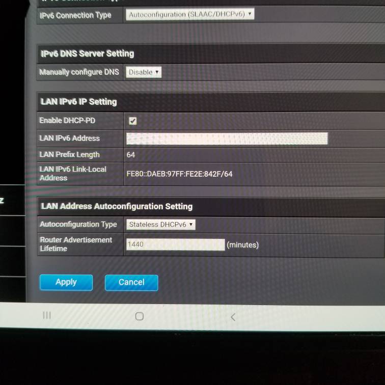

There is just no way for a device to pull an IP and use the internet from the Trend Net with DHCP turned off.
   / Cheap $20 a month Stand Alone Unlimited Rural Internet through AT&T Wireless #1,622
My problem is in the IPv6 IP setting in the trendnet it was configured to local only I set it to Auto config but I still missing something cuz it's not picking it up. Do I need something in the IPv6 address area on this picture I took of the screen. 20200313_213150.jpg
I've never used the trendnet as a router before.... It was setup with Wisp with the Mobley, and that's why these config issues are dribbling out.
   / Cheap $20 a month Stand Alone Unlimited Rural Internet through AT&T Wireless #1,623
You don’t need ip6
   / Cheap $20 a month Stand Alone Unlimited Rural Internet through AT&T Wireless #1,624
If you are using it as a router, it needs to be on a different network than the netgear modem.
   / Cheap $20 a month Stand Alone Unlimited Rural Internet through AT&T Wireless #1,625
My problem is in the IPv6 IP setting in the trendnet it was configured to local only I set it to Auto config but I still missing something cuz it's not picking it up. Do I need something in the IPv6 address area on this picture I took of the screen. View attachment 645377
I don't know much about this stuff but when I tried changing the APN on the Netgear to IPv6 only it wouldn't connect at all. It connects by default to IPv4.
I would try unchecking that box on the router.
   / Cheap $20 a month Stand Alone Unlimited Rural Internet through AT&T Wireless #1,626
In my opinion you are putting way too much thought into this. There are no settings that need to be change in the Netgear modem. If it were me I would factory default the Trend Net and go through the quick set up if there is one. If it is a newer router there should be a quick set up tutorial and hopefully that will get you going. I think you are way too deep into the settings and you will be days getting it right when a quick default may solve your issues. No one at home needs IPV6 for any reason.

Even though I had gone through the setup wizard on the trendnet multiple times that's exactly what I did decide to do I did a reset on the trendnet and plug the Netgear in. Initially it had problems of sinking up between the two devices something flaky going on and is probably in the trendnet. Finally initial sign on to the trendnet took me directly to a setup wizard. And again the trendnet seem to have problems communicating to the Netgear. But finally they did sync up it did make a connection it come through and configured the trendnet and the configuration looks exactly the way it was before I started this process. However this time I've got internet that's broadcasting through Wi-Fi. There was something very odd in the trendnet that was just ruin the whole works up but in either event it's working now if this comes back I probably will get a new router. Thanks everyone.
