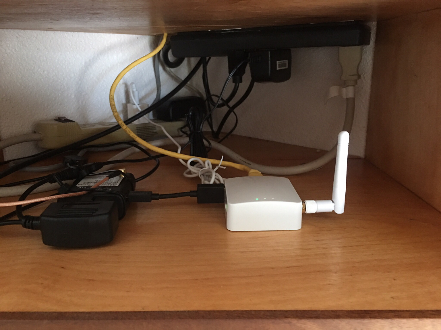

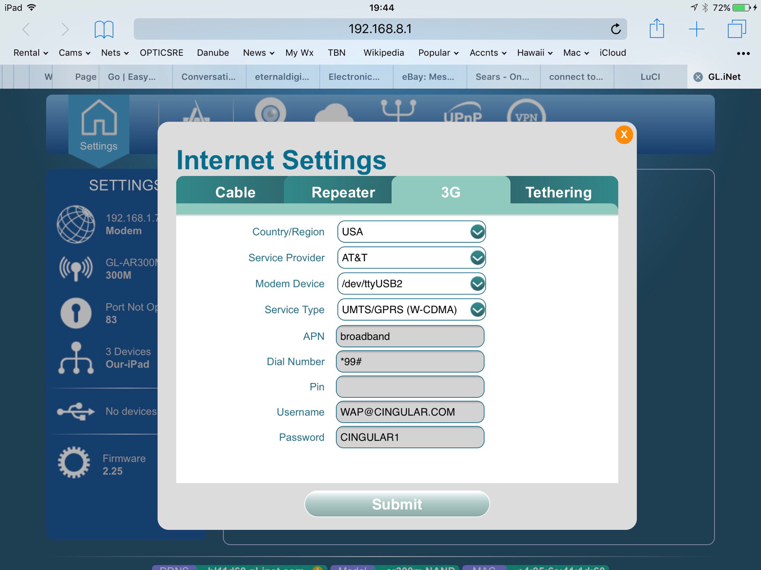

Works great. Can do USB to micro USB at Mobley. The Mobley port is covered with a label/sticker to peel off. Sometimes hard to see. I believe earlier in thread you'll find the configuration, very straightforward and as far as I read not the problems reported by the $80 Asus router.
I also have the ar300 but settings are the same:
USB to Mobley
