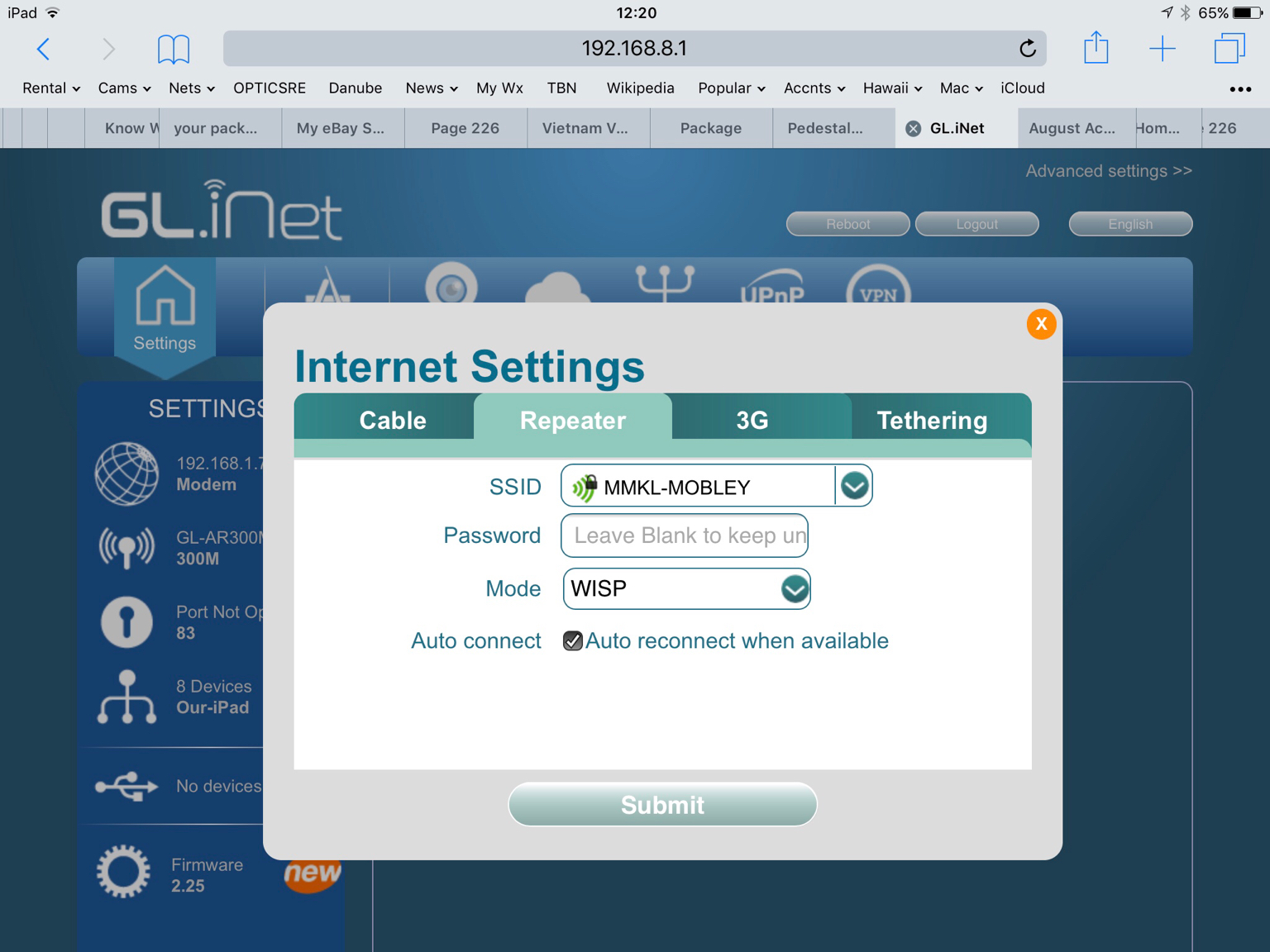

sodamo...need your advice on the GL-AR150.
I have it hooked to the Mobley. I can plug into the lan port to my laptop and I get the internet thru Mobley. router is usb to Mobley. BUT, I cannot go to the router via wifi. I see it trying to connect, network light blinks on the trys, but ends with "Can't connect to this network."
SO...it works via cable, but not the wifi.
Under internet settings....cable is DHCP, 3G is the same as photo you posted, if I try to do anything under repeater, it says can not update wan.
Lost as to what to try next.
I also set DNS on router to 8.8.8.8 and 8.8.4.4.

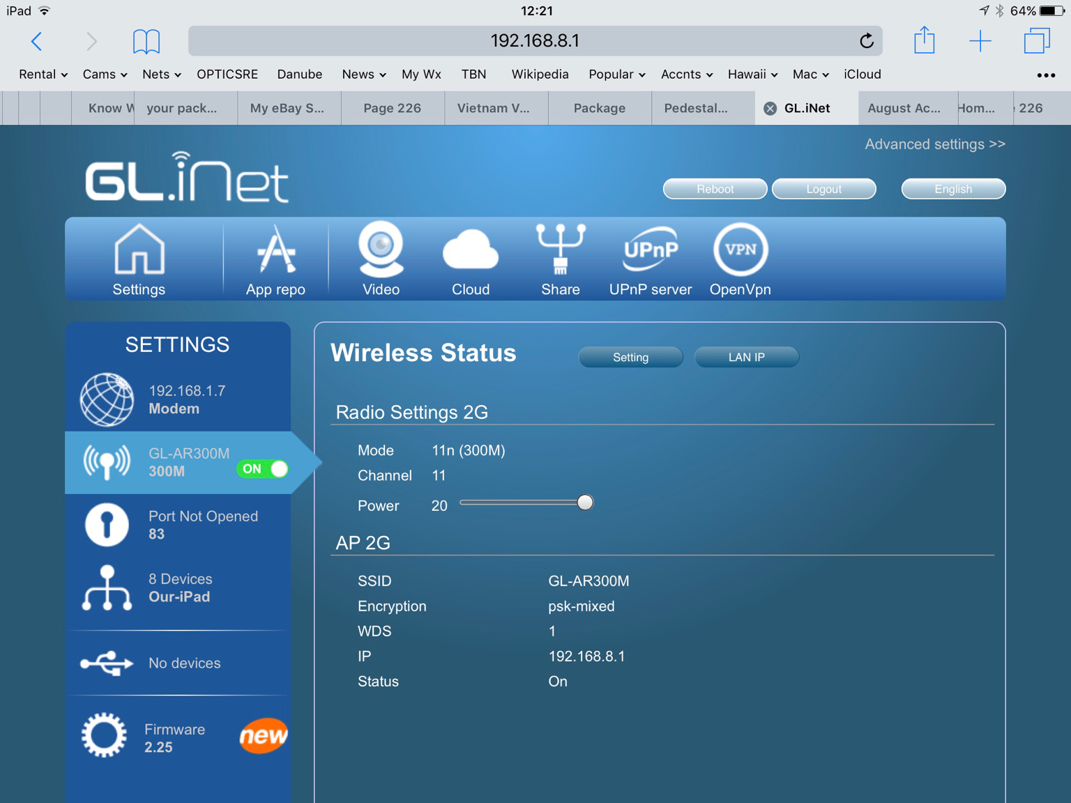

Ar150 not accessible from where I am, but ar300 same settings:
Hope it helps

Found the problem. When first logging into Mobley you provide the password. When setting up the wifi...you have got to repeat it. In the password field it says 'Leave blank to keep un' ..... and I took that truncated message as meaning to leave blank to keep unchanged. I guess not. I repeated the password in that setting...then wifi worked.
Speed test shows very little difference between being logged direct to Mobley or on the GL-AR150.
Good to go.
