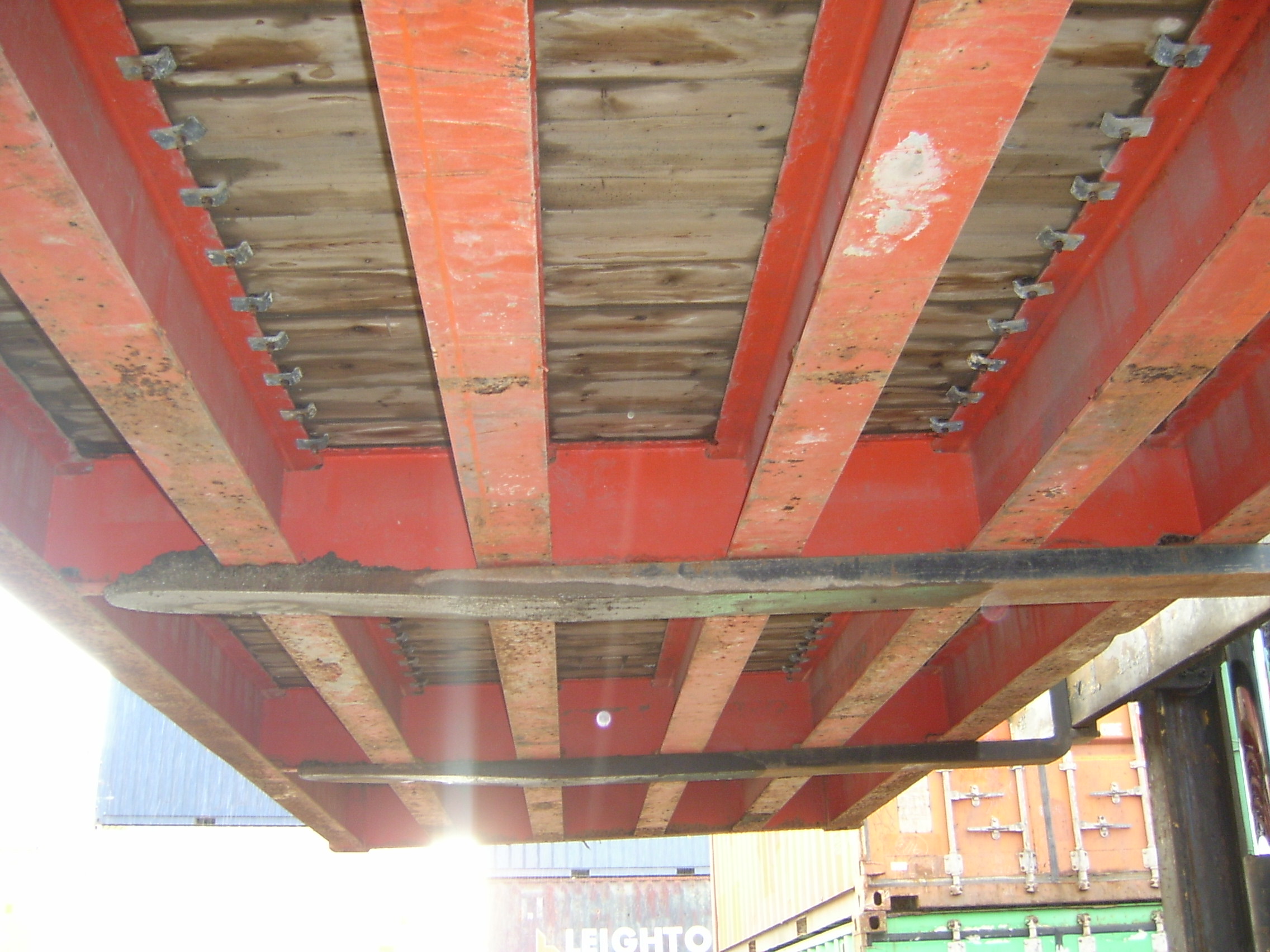

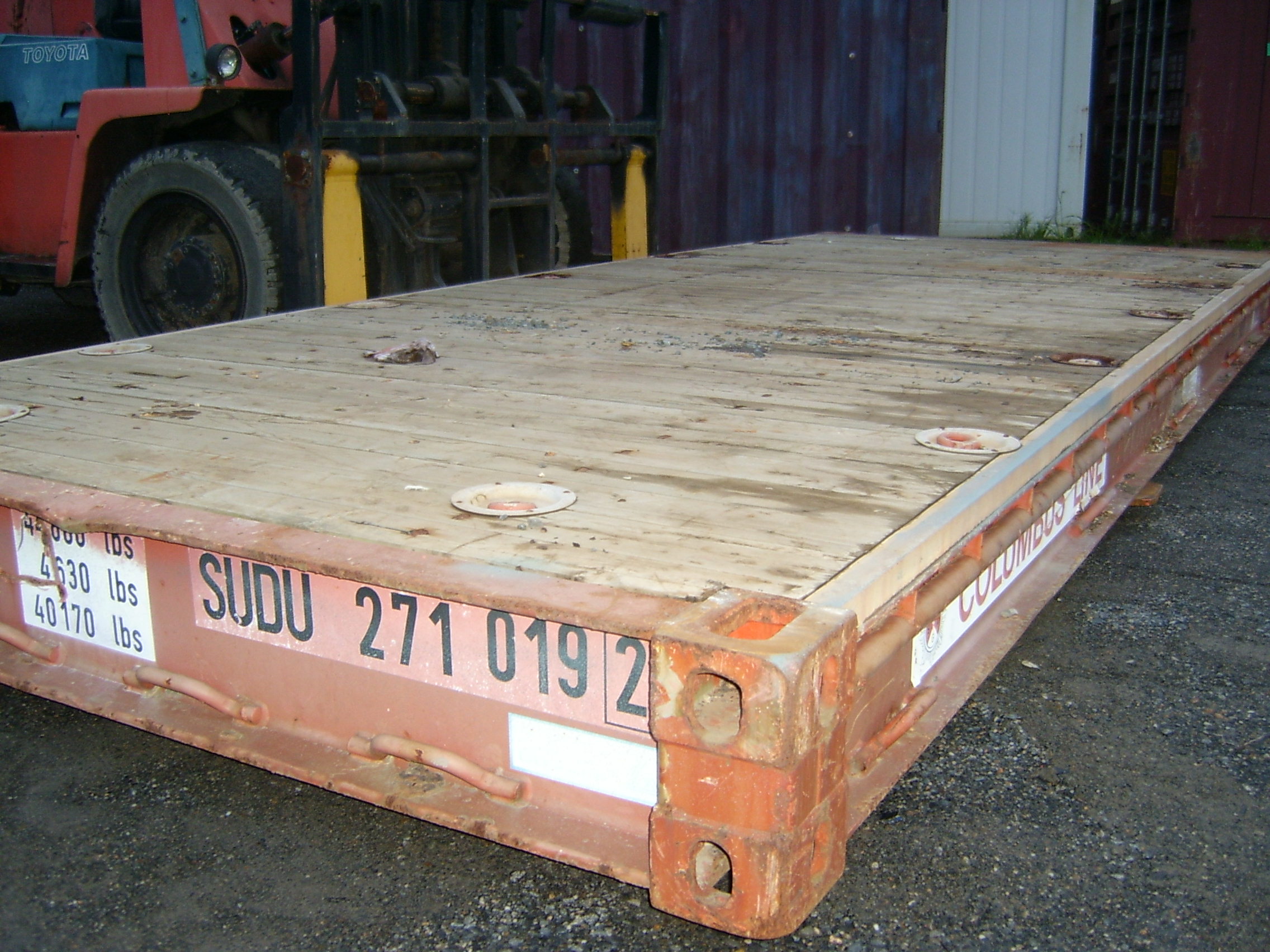

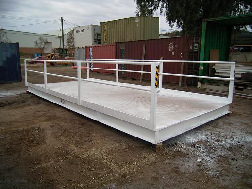

I'm replacing an old timber creek crossing at present. After much reading and talking to others in the area, I've decided to use a flat rack (sometimes called flat deck) container. They are used here by emergency services for crossings when bridges are washed away in floods etc. I've attached a couple of pics - one in its raw state, and one that has been turned into a great looking bridge by a container company.
Obviously come in 20 and 40 foot versions.
Anyone else done this?

That is a good looking bridge for sure. And should hold a lot of weight.

The are 8 foot wide. They would be available anywhere in the world that uses shipping containers. Some people prefer flat decks known as bolsters - same size, just don't have the fold down ends.
This link shows the diferent sizes etc Intramar Australia
From a container re-seller I was quoted around $2,000 (AUD) for a 20' and about $3,000 for a 40' bolster. The shorter ones can go on a tilt truck and be slid off easily - but generally these guys are so used to transporting containers, transport isn't an issue.
